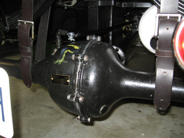

I'm back. I have a question for Cudaman. Why do you have those straps on the rear axle? Do they go around the spring or the chassis? I haven't seen anything like that before.
- Posts: 2533
- Last Name: Strange
- Location: Hillsboro, MO
- Board Member Since: 2013
Re: To Ruckstell or not to Ruckstell....that is the question
Those are rebound straps, they limit the amount of rebound from the springs over bumps. Reduces the "ejection seat" effect. They were a period accessory. I made mine from the beefiest leather belts that I could find at Walmart. They go over the frame. I have them on the front and rear, they actually help.
http://www.mtfca.com/discus/messages/41 ... 1409704166
Early Corvettes and some British sports cars had them from the factory.

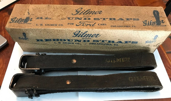

Period accessoryNorman Kling wrote: ↑Thu Oct 15, 2020 4:23 pmI'm back. I have a question for Cudaman. Why do you have those straps on the rear axle? Do they go around the spring or the chassis? I haven't seen anything like that before.
- Posts: 1359
- First Name: Les
- Last Name: Schubert
- Location: Calgary
I would be concerned by two things;
1. The straps are very close to the center of the differential and risk bending the housing from a big bump.
2. The right one seems really close to the exhaust outlet.
I would like them if they were located as far out as possible!!
