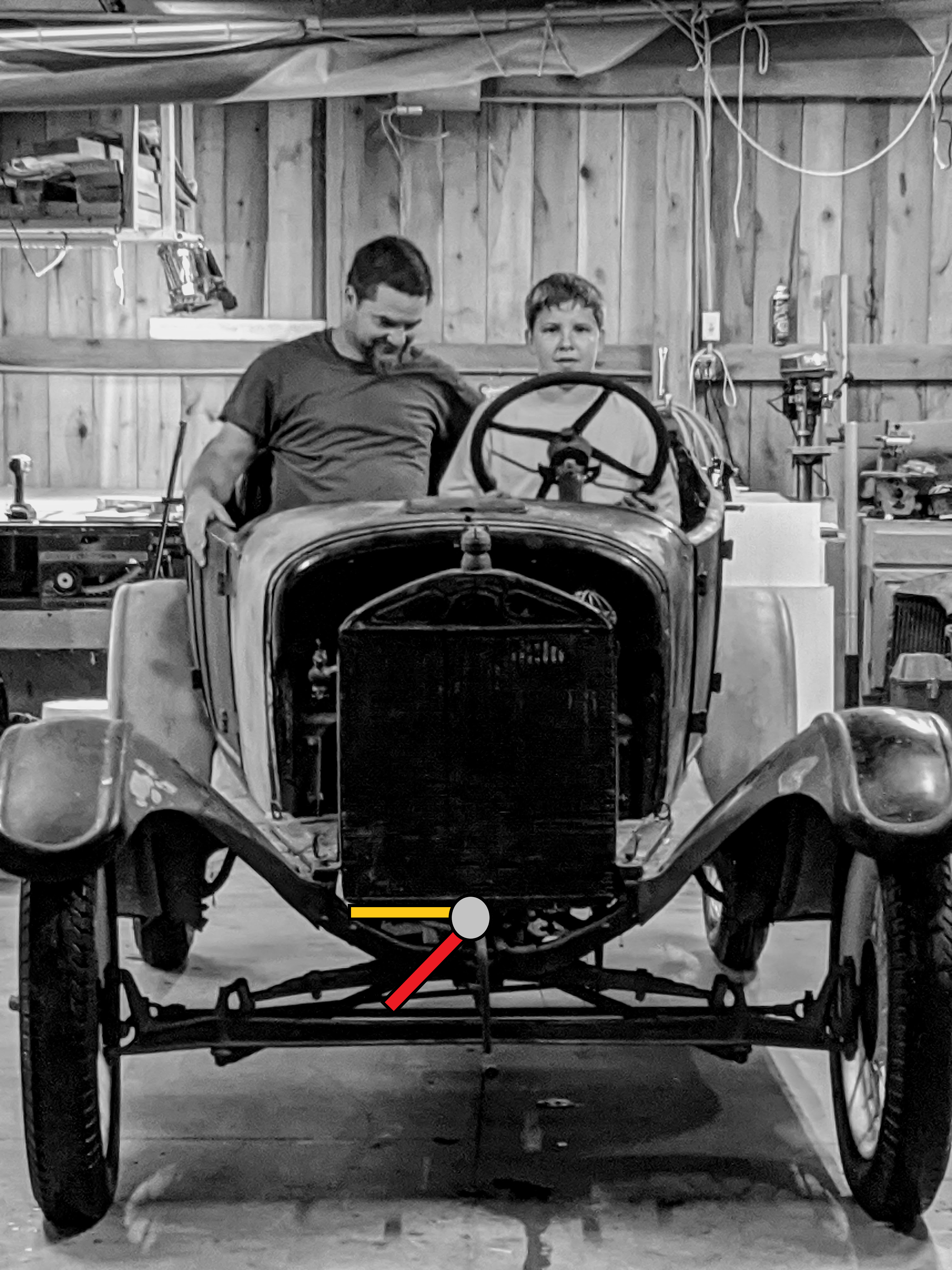

I was wondering if anyone thought that removing the crank from my engine, and boring a whole in it at a 45 degree angle difference so that I could crank farther without pushing down on it was a good idea? Here is an edited photo with the original crank position in yellow vs the modified position in red.

Jonah- I'm not entirely sure what you are asking but the hand crank has no defined position. You can position it wherever you want prior to starting the car.

Basically, my theory is that if the handle is rotated 45° different, I will be able to crank two exploding cycles in one crank without pushing down on the crank and it might start better without damaging my arm.

I can position the crank but not the engine.

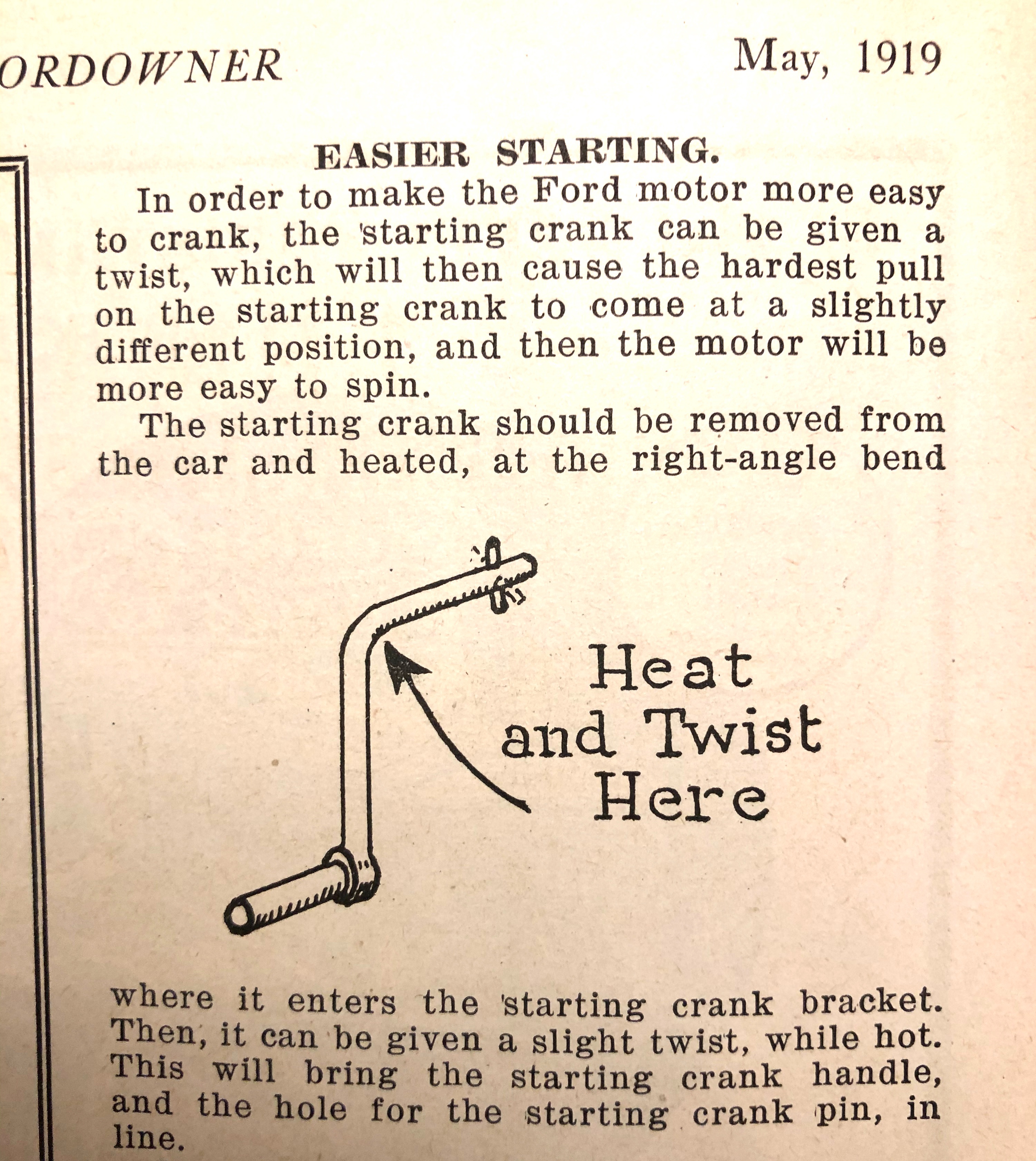

- Posts: 4090
Re: Crank modification????
Jonah
Your post brought this old 'Hint' from Ford Owner magazine to mind......the crank handle is heated with a torch and bent to bring the pin hole for the retaining pin in the crank ratchet 'in-line' with the grip handle of the crank handle. Places the handle in a better spot to achieve easy start as you desired. Guess it works or did for the submitter in 1919, a Mr. O.D. Chrowl of Dowagiac, MI.

I have a spare crank an I am going to experiment with that.

Jonah, if you do decide to alter the cranking angle, rather than re-drill the crank handle, it is simpler to re-drill the dog on the end. Set it in the position you want and drill one side only at first. Then fit the dog to the handle and line up your newly drilled hole with the hole through the handle. Then you can drill through your new hole and the crank hole will keep the drill in line as you drill the other side.
Hope this helps,
Hope this helps,

As I see it you have 2 great suggestions here. 1; bend a spare crank and 2; re-drill a spare dog. Leave the crank itself alone.

I don’t believe moving the hole on either the crank, dog or crankshaft will not do what you wrote in the first thread. There are two compression on each revolution of the crankshaft. It follows that there will be one compression for each half turn of the crankshaft.
You can move the alignment as to where you get the compression on any half crank but you cannot get two compressions on half a rotation.
Neat idea but I’m afraid it will not work.

The position of the hand crank is dependent on the position of the engine crankshaft. Bending, twisting or re-drilling the hand crank will not alter this fact.
As stated earlier, with the ignition off just position the hand crank where you want it by rotating the crankshaft.
