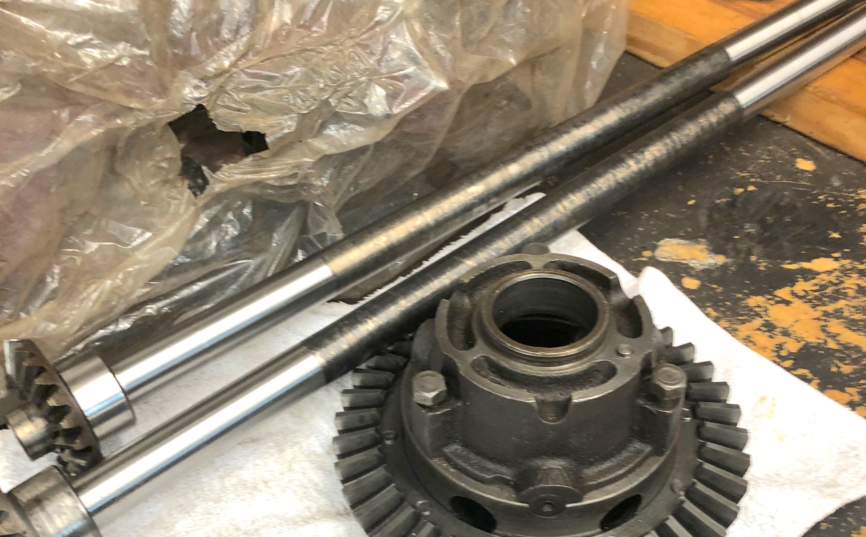

Re: Any rear floating hubs being made that don't require shortening the axle housing?
Snyder's and Lang's offer the better new axle shafts, come in std. or 1/16" extra taper end ideal for worn hubs. These are made to Ford print, and fit well. These are 'GN' brand, by logo mark, and noted by the heat treat color surface of the unturned shaft. Korea made with quality steel.
Always the best choice to fit NEW axles, old Ford axles are years and years tired and questionable.
Even with 'floating hubs', axles can and do break

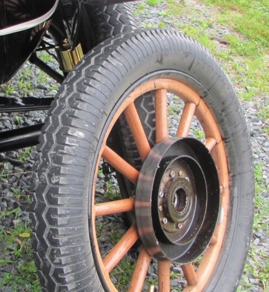

Those are not true safety hubs as the spud should never have the ability to separate from the inner race of the bearing as shown in the picture above. Safety hubs require that he spud and the wheel/hub need to be removed from the housing as a single assembly.
