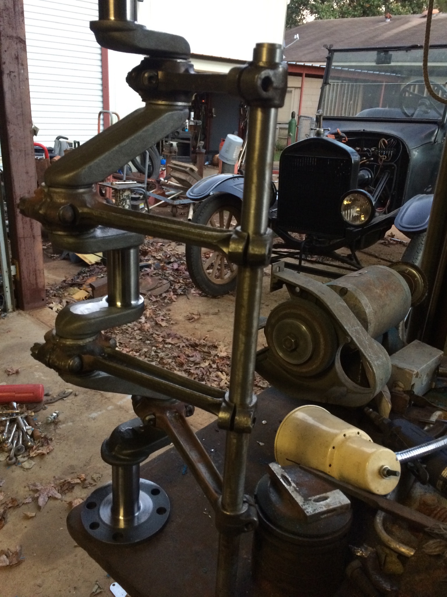

An easy way to check the rods for straightness
Dave Young
Topic author - Posts: 240
- Joined: Sun Feb 24, 2019 9:37 pm
- First Name: David
- Last Name: Young
- * REQUIRED* Type and Year of Model Ts owned: 26 Touring, 26 RPU, 24 Coupe, 26 Speedster, 28 Chandler, 29 Chandler, 29 A
- Location: Mays Landing, Nj
Re: Kohnke Rebabbiting Service
Interesting way to check them!
