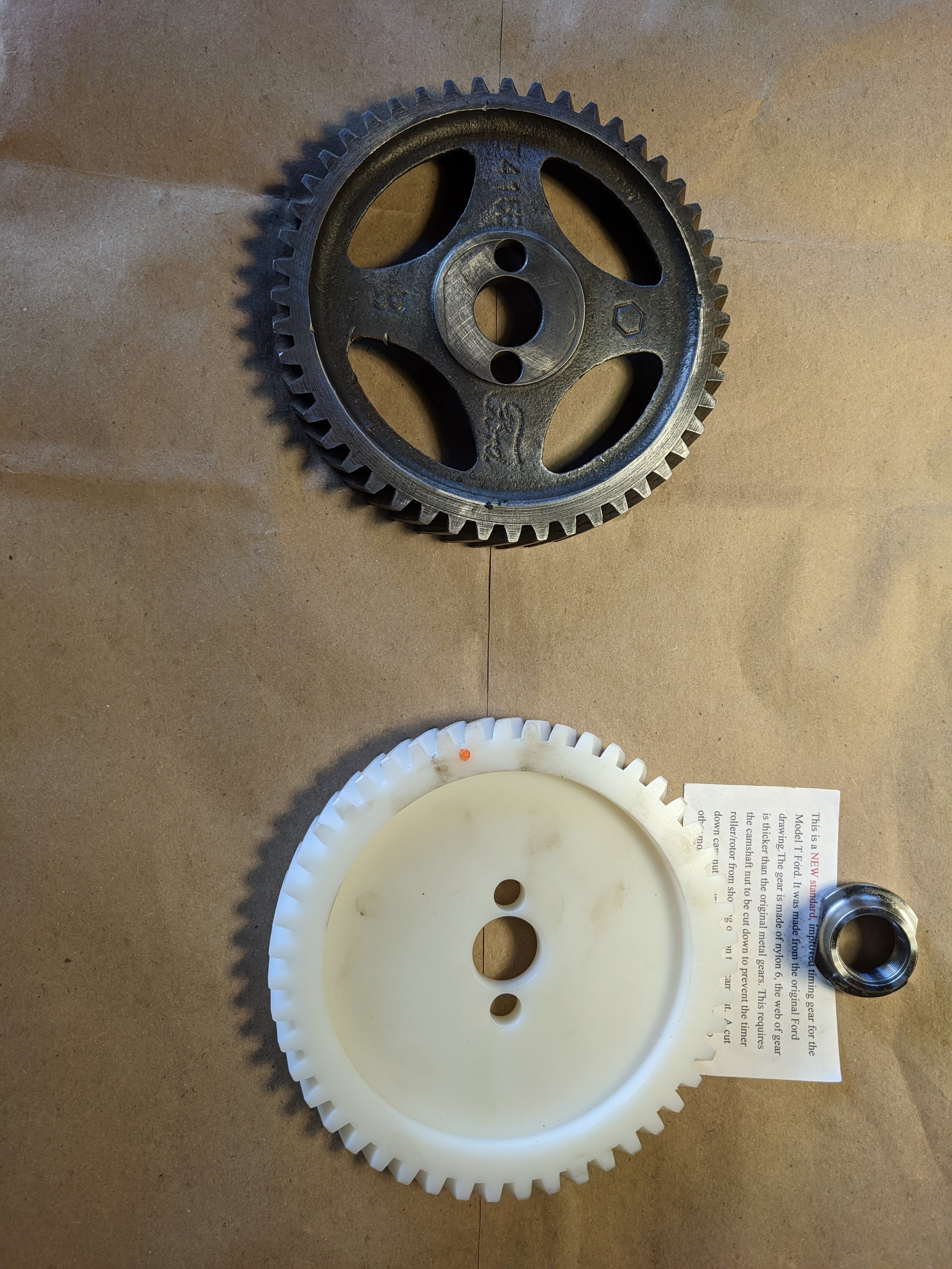

Can anybody identify the metal timing gear pictured? The number on it is: T415B and looks to be in pretty good condition. I can't locate any reference to that number.
Given the choice, would you install the used metal one of the new nylon one?
R/ Roger.
Posts: 7413
Re: Big Timing Gear
Post by Steve Jelf » Sun Oct 18, 2020 10:28 pm
415B is the factory number for part #3047B. The parts book says you can use it for all years 1909-1927.
After my bad experience with the failure of a nylon timing gear I would not have another. The same goes for fiber. You can use the original if it's in good condition, or go with bronze (best choice) or aluminum.

Post by RajoRacer » Sun Oct 18, 2020 10:34 pm
The steel 4 spoke was the first helical gear following the straight cut cam gear. I'm assuming following the introduction of the Ford electric starting system.
Posts: 5614
Re: Big Timing Gear
Post by RajoRacer » Sun Oct 18, 2020 10:35 pm
And, I would use the steel gear, given the choice !

Looking at it will not tell you much, needs to be fitted for a check of lash.

The only downside to a steel gear is that it is noisier than the non-steel gears. I will take noisier, any day, over a propensity to break and lose teeth like the non steel gears do. Jim Patrick

There are two types of Ford steel helical gears. Four spoke, and three spoke.

Ok, thanks. Steel it is! I'll check the backlash when I get it together.

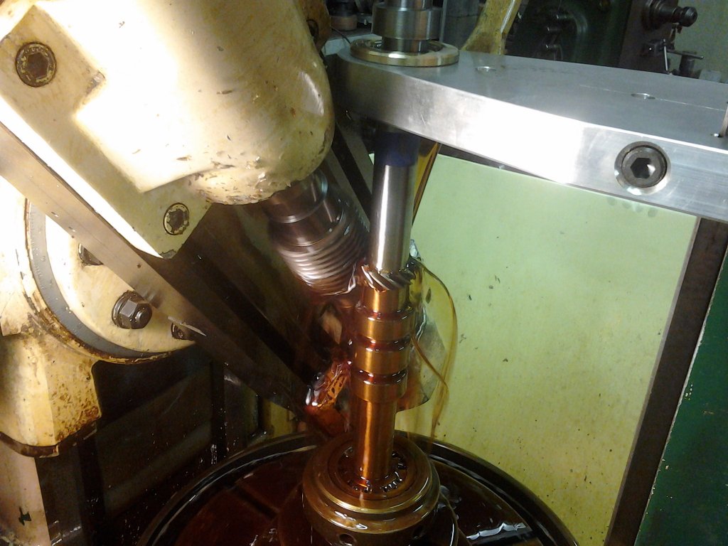

Post by Dan McEachern » Sun Dec 11, 2022 1:36 pm
Posts: 4502
Re: Big Timing Gear
Post by Jerry VanOoteghem » Sun Dec 11, 2022 7:31 pm
Jerry VanOoteghem wrote:
Sun Dec 11, 2022 8:40 am
Art M wrote:
Sat Dec 10, 2022 11:17 pm
Advantages of helical and spur gears
Helical are quieter
Spur or straight tooth are stronger, more efficient, and easier to manufacture
Art Mirtes
Helicals are really no more difficult to manufacture than spurs. Usually just requires a different change gear ratio between the gear blank and the spriral hob.
Dan's photo above has me a bit humbled. Yes there's a bit more to it than gear ratios.
