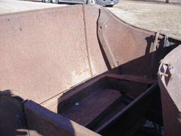

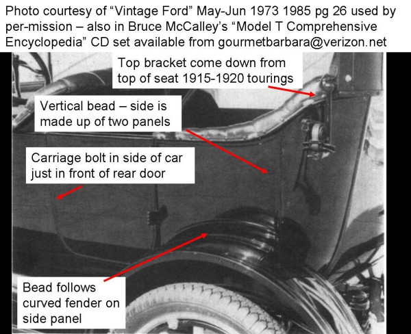

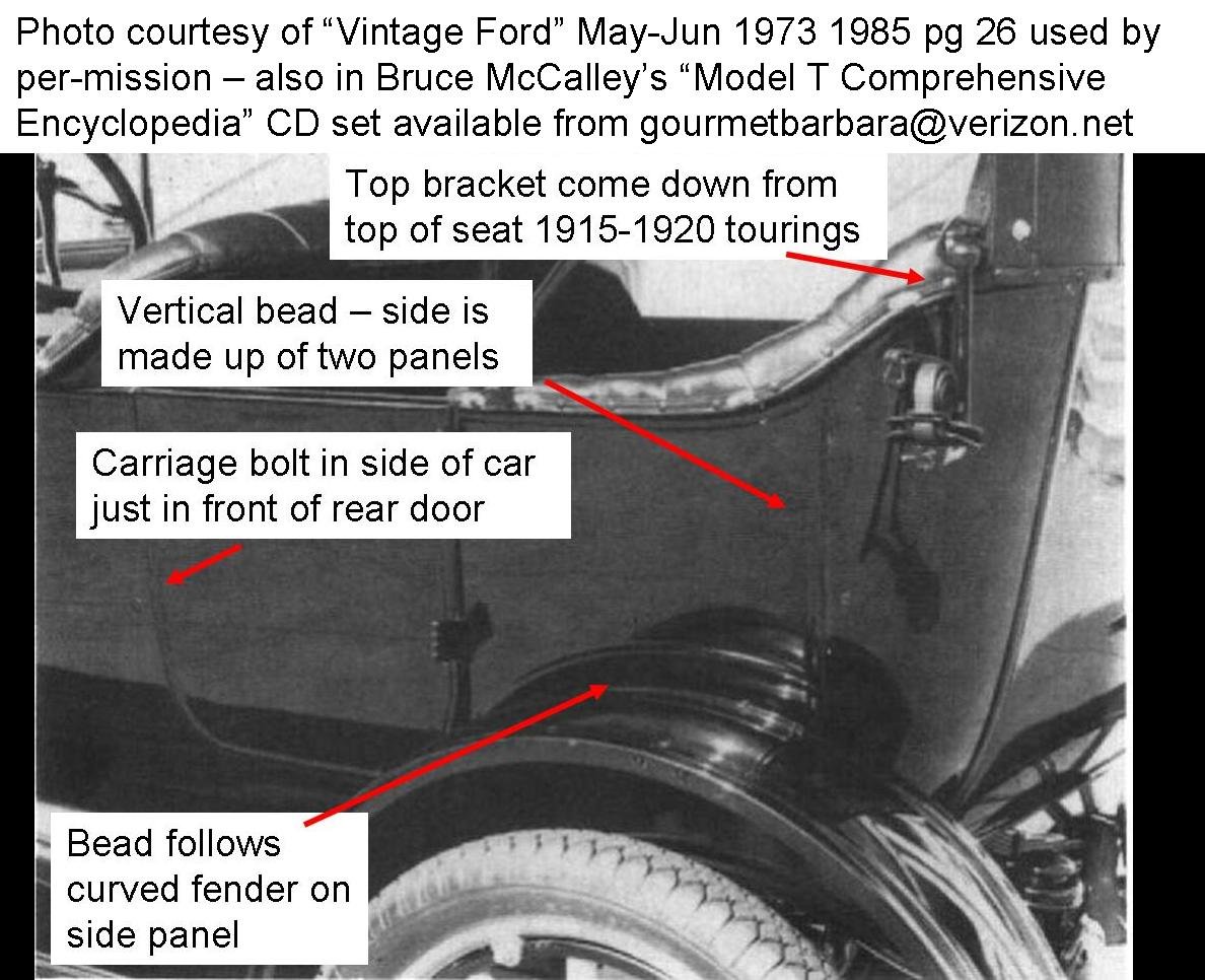

I like to say the rear tub changed during 1921 -- when I believe both the older 5 piece rear tub was replaced with the newer 3 piece rear tub. The 2 photos below show a 1919 5-piece rear seat section for a touring (used by permission of Model T Haven -- this one sold several years ago. Thank you Mark for letting us use those. See https://vintagecarsandparts.com/cars-pre/cars-pre-2 for other photos on his site. )

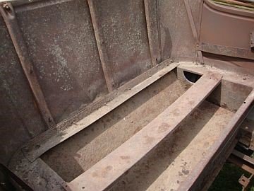

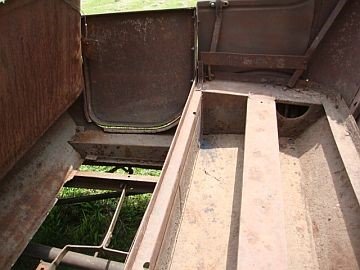

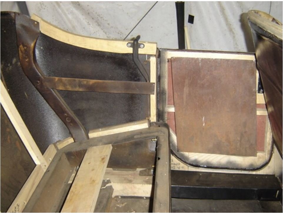

Below shows the metal brace that was introduced during 1921 with the 3 piece rear tub. That is not in the earlier 5 piece rear tub. I can't find where I had it filed. I think I owe Mark of Model T Haven another thank you for allowing us to post his photos. But if you recognize that it was your photo -- please let me know so I can add that to file info. This one is a 1925 but it show the metal bracket:

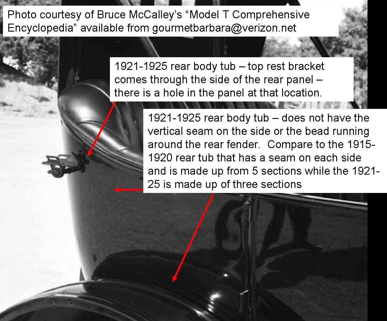

The photo below was posted by William L. Vanderburg (see: http://www.mtfca.com/discus/messages/50 ... 1438574224 ) Thank you Will.

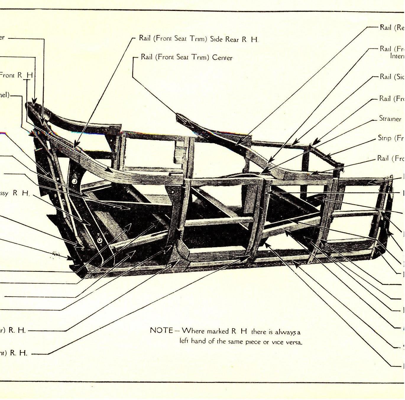

And below is the sketch from the 1923 Price List of Parts for the wood parts for a touring:
