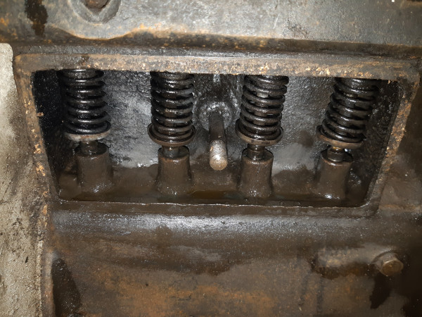

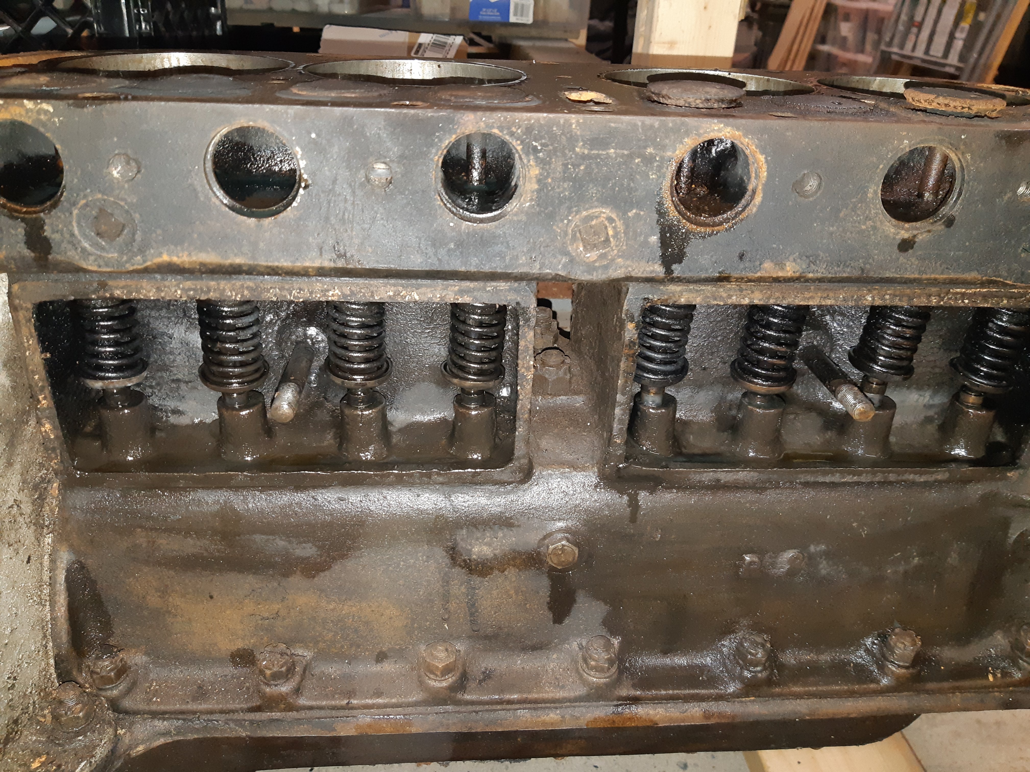

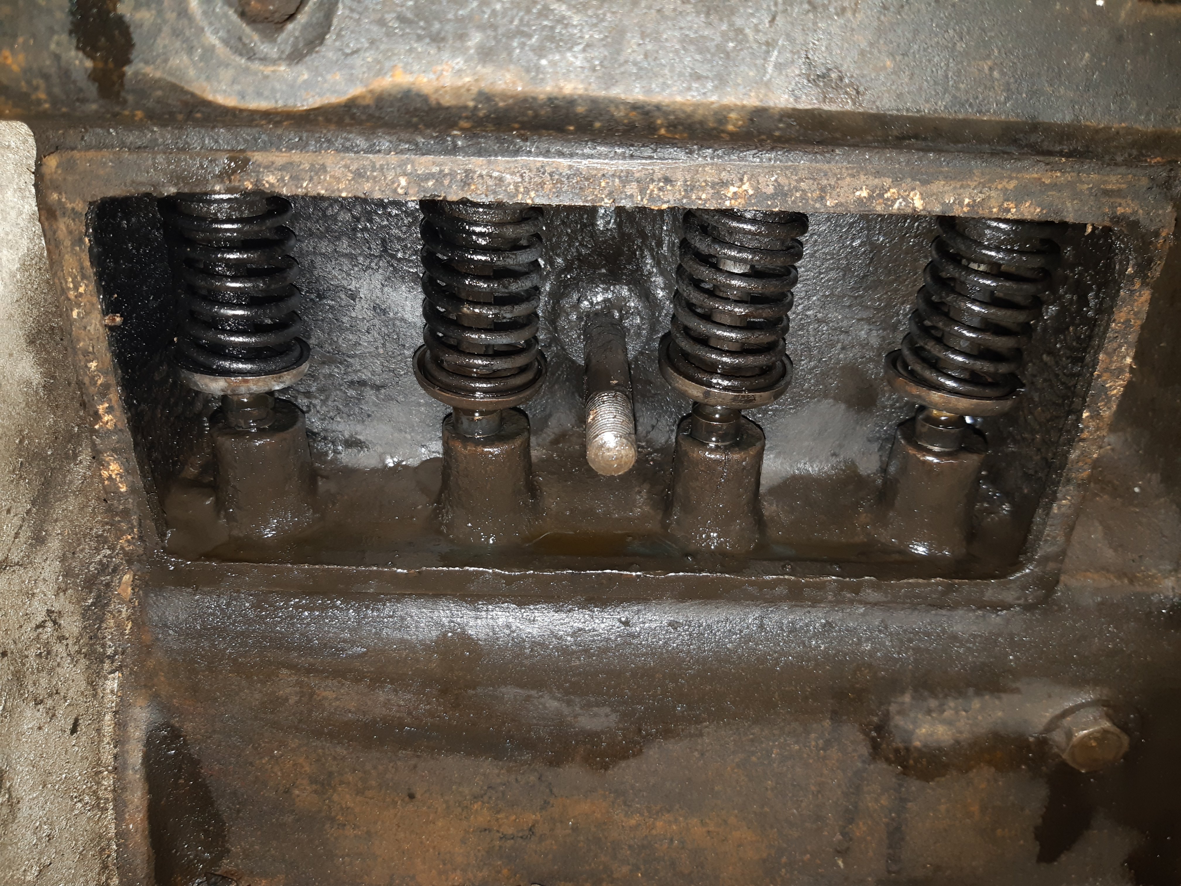

I picked up a '13 block for my '13 Canadian touring project recently. When I took the valve covers off to inspect it I noticed that something appears to be missing inside. See if you can spot what's not present.
And has anyone else run across this missing step in the engine manufacture before.

Oil drain hole?

early blocks did not have the oil holes in the valve galley.

Dan's right, need to drill them on early blocks.

The original tappet bores on early blocks are broached with oil grooves that allow excess oil to drain back into the crankcase and there are no drain holes in the bottom of the valve galleries. If the block ever gets reamed out for oversize tappets the reamer will eliminate the original oil drain grooves and THEN you have to drill a drain hole like the later blocks had.

Yes, no oil drain holes in the valve chambers. First time I have run across this myself, although I did see it mentioned in McAuley's book in relation to a 1912 engine.
This engine had sat for 30 plus years and had almost no oil in the pan and was overall dry. Yet when I took off a valve cover out ran a couple ounces of black oily goo. There was oil trapped in the valve chambers.
So oil drain holes are going to be drilled when it gets restored. And as mentioned, if the valve guides become leaky, the valve chamber could become either negative pressure or positive pressure depending on which guides are more worn or even pulsate. But I think more oil tends to get sucked up than can drain back down the lifter guides.

I built up a speedster 4 valve rajo for a customer and the block didn’t have the two oil drain holes. The oil built up and would leak out at car shows much to the isners annoyance. So we bought a long drill, removed the inspection pan and drilled the two missing holes from the bottom.
They may not be in quite he correct position but the oil build up has ceased.
