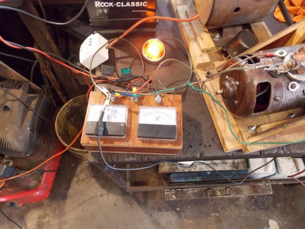

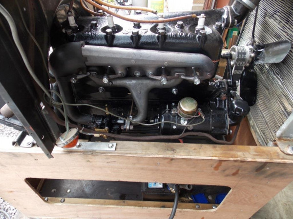

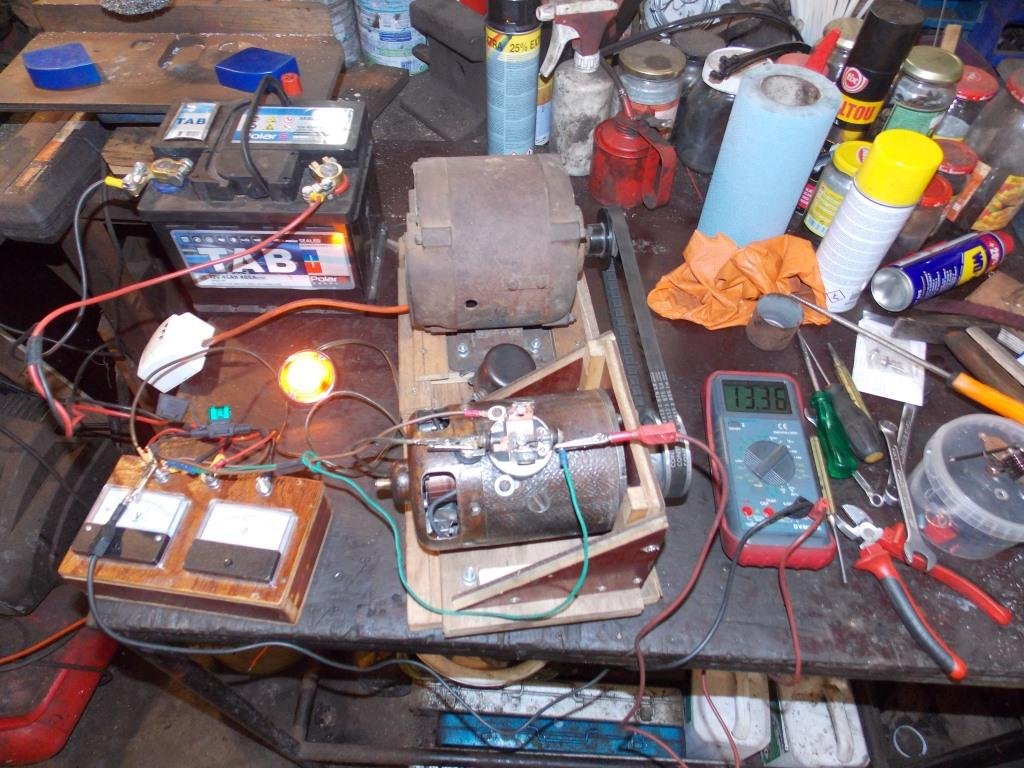

Take out the new cutout and connect a test light between the generator output and the frame. Start the engine, if your generator is ok the light will light up, if no light you can try to flash it, still no light your generator need a overhaul and maybe have fried a few things inside.
Two photos following.
The one on my test stand has the test light connected directly to the generator. On the photo with the generator on the engine ready to testrun the connection of the testlight is between the cutout output and the frame because all was tested before and running well.
Good luck
Andre
Belgium
test stand
test stand
test stand
test stand
engine test running
engine test running
