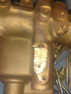

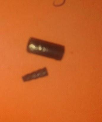

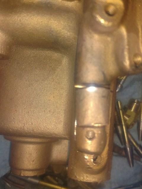

So, I got this in along with a sad story some time last fall. Supposed to have been rebuilt, sold on ebay, guy paid quite a bit for it, put it on his car and it would run but absolutely would not idle. It had been a couple months since he bought it so the seller basically said, "Tough Luck," which I can understand. So he sent it to me to fix. Took it apart and there was a broken off Easy Out in the idle jet.
I did all the easy ideas I had, couldn't get it out, can't drill it from the top, couldn't pound it out after drilling a hole to access the bottom of the idle jet, heated it, used the cuss words I save for special occasions, etc., couldn't get it out. So I cut the bottom of the lower end off, got a vice grip on the idle jet and of course it just broke the solder joint. So I cut the side of the carb off around the idle jet, drilled it from the bottom to where I could get a punch in to drive the Easy Out out of the Idle Jet. But the slot in the Idle Jet had been so butchered before the tried using the Easy Out that there was no way to get a grip on it. So I just drilled the Idle Jet out from the bottom with a drill the size of the passage, punched out what was left, re-threaded the passage the jet screws into and now will set it up in my mill, square things up, silver solder on a new piece, drill all the passages so they line up right, shape it so it looks right and put a new Idle Jet in, do the rest of the things that were not "rebuilt" and should have it in the mail to the guy tomorrow.
2020 10 21 OF side cut.jpg (26.21 KiB) Viewed 3693 times
2020 10 21 OF side cut.jpg (26.21 KiB) Viewed 3682 times
2020 10 21 OF easy out.jpg (16.48 KiB) Viewed 3682 times

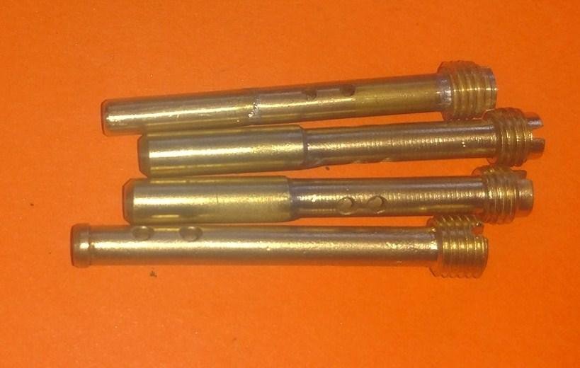

I made about 20 new idle jets last week, they are almost always damaged or missing.
