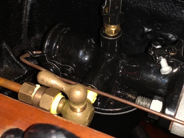

Tim,
I agree with Mark and Dennis. It appears I have the exact same fuel cutoff.
On/open is pointed toward the fuel line. I attached a pic of it in the on/open position.
Off is pointed at the carb.
Darin
