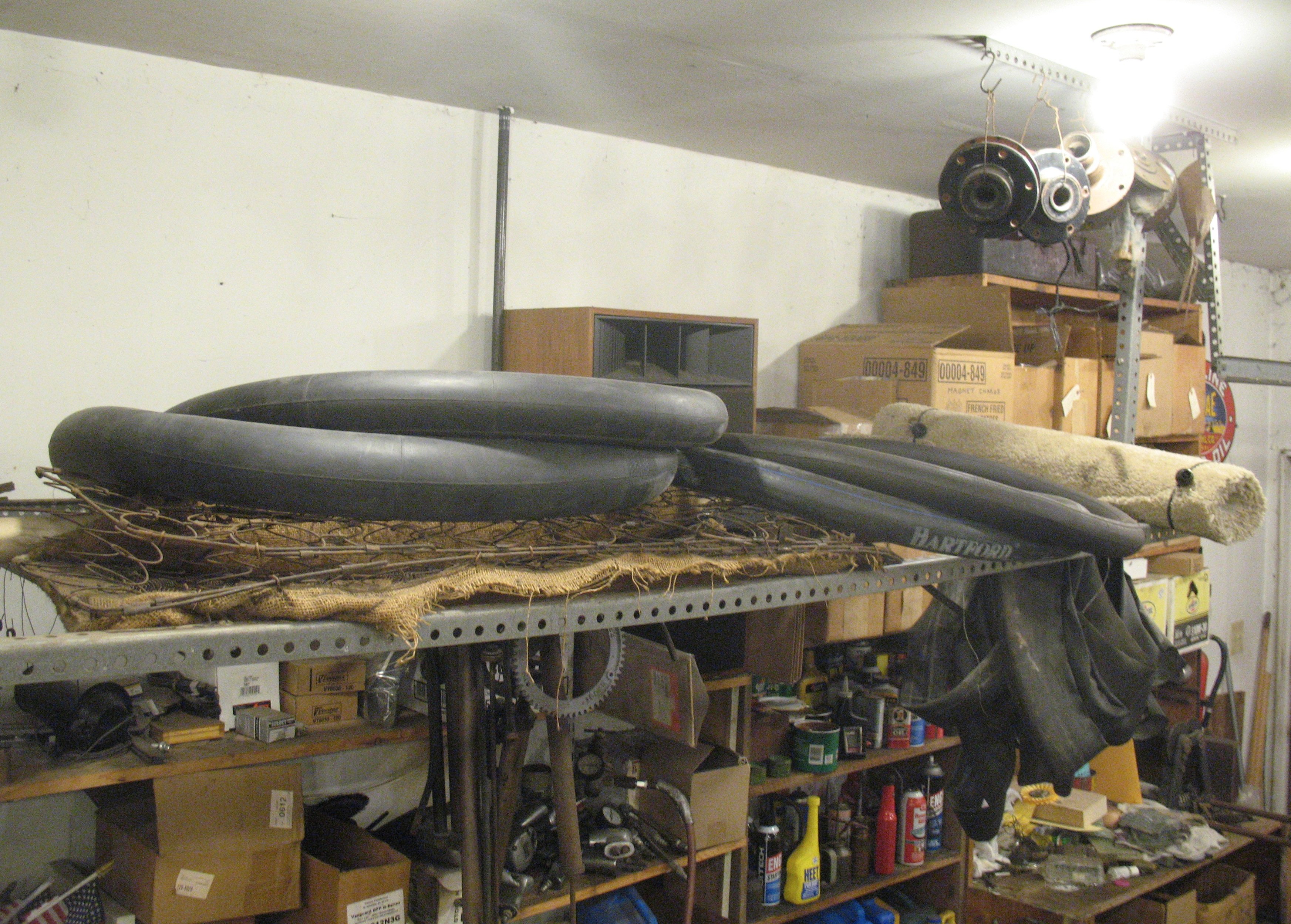

Post by Steve Jelf » Wed Oct 28, 2020 12:39 am
Another item you might recommend carrying is at least one spare tube...
Between trips I store them.
Posts: 7287
Re: New page: Any misteaks?
Post by Allan » Wed Oct 28, 2020 1:21 am
Steve, that is the next best way to storing them, and clearly easier than fitting them into and mounting a tyre. I could not believe how well two red rubber Goodyear tubes came out of some old, mounted tyres. Keeping them out of the light also helps. My spares are stored in the cellar, which never varies from 72 degrees.
