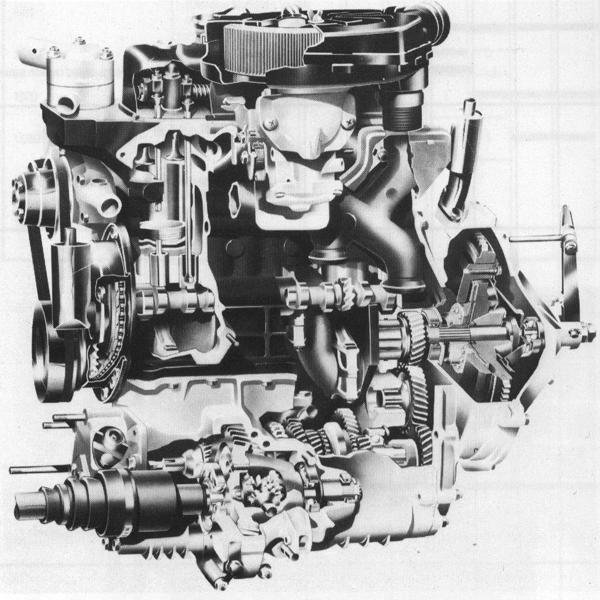

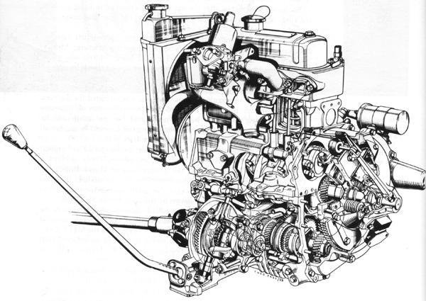

Motorcycle engine and transmission sharing the same sump? Well ever hear of a Morris Minor - the Mini? Engine and transmission share the same oil. And it works. One minor problem is the metal from the transmission finding its want in the engine oil galleys. Straight weight or multigrade worked fine.

Frank B covered it, it's all about the clutch, as for the Morris, they had a dry clutch.

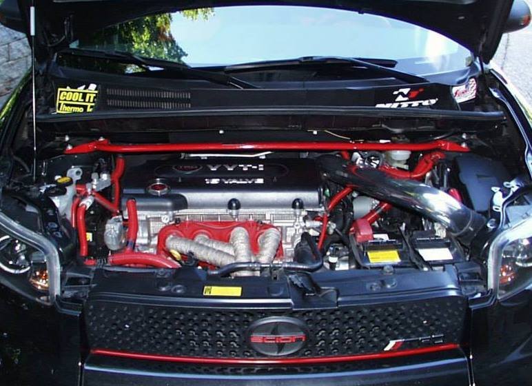

Charlie B in N.J. wrote:
Thu Dec 24, 2020 7:24 am
Whenever I see a post like this I always have to ask Do you experiment on your “Modern” the same way and why.
YES! Because I have to.
