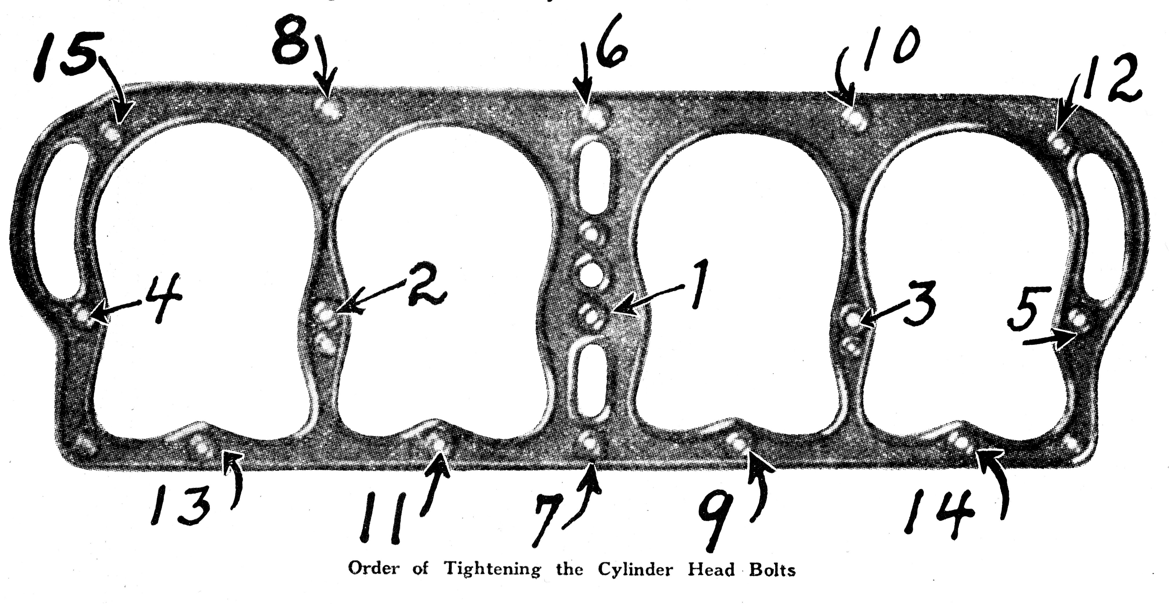

Be sure to check the surfaces of both block and head with a straight edge to be sure it is not warped nor eroded. If everything is smooth, try the head on without a gasket and put the bolts in and see if they bottom out before they contact the head.
It is a good idea to run a bottoming tap down the threads and blow out anything dirt which is in the bottom of the holes. If all the bolts can be turned (not tight) all the way down to the head, and the surfaces are straight, follow the instructions for tightening start in the center and work toward the front and back and side to side tightening them not all the way but just snug. Go through the sequence several times finally torque to about 50 ft lbs each by just a few foot pounds at a time until all are tightened down. fill it with plain water and change the oil. Start it up and run until it warms up. Then torque again when hot. If you have an aluminum head, do the same except let it cool down before you re-torque. After you run the car a while and torque again until it stays at the 50 ft lbs. Do not over torque or you could break off the bolts or crack the head. It is best to use new bolts unless they seem to be in very good condition. After you are sure there are no leaks, install the anti freeze mixture.
- Posts: 7395
Re: blown head gasket?
Norm always gives good, clearly stated advice. There are different versions of the tightening sequence. I think this is as good as any other.
While you're in there, make sure the little ¼" water holes in the block and head are clear.
