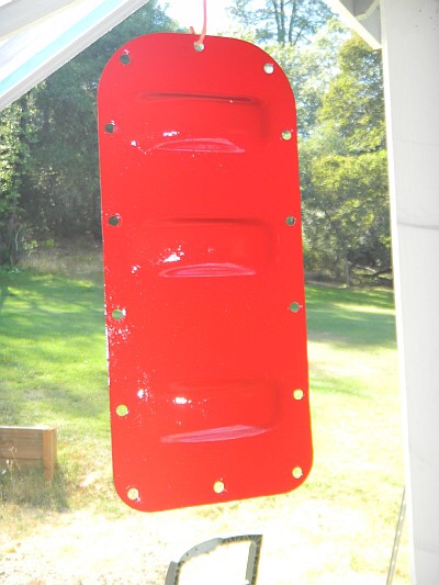

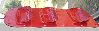

No, that's not it. Terry puts dams along the back sides of the dips to keep oil in them when the car is climbing a hill. I believe he solders them in. I think it's a DIY project.

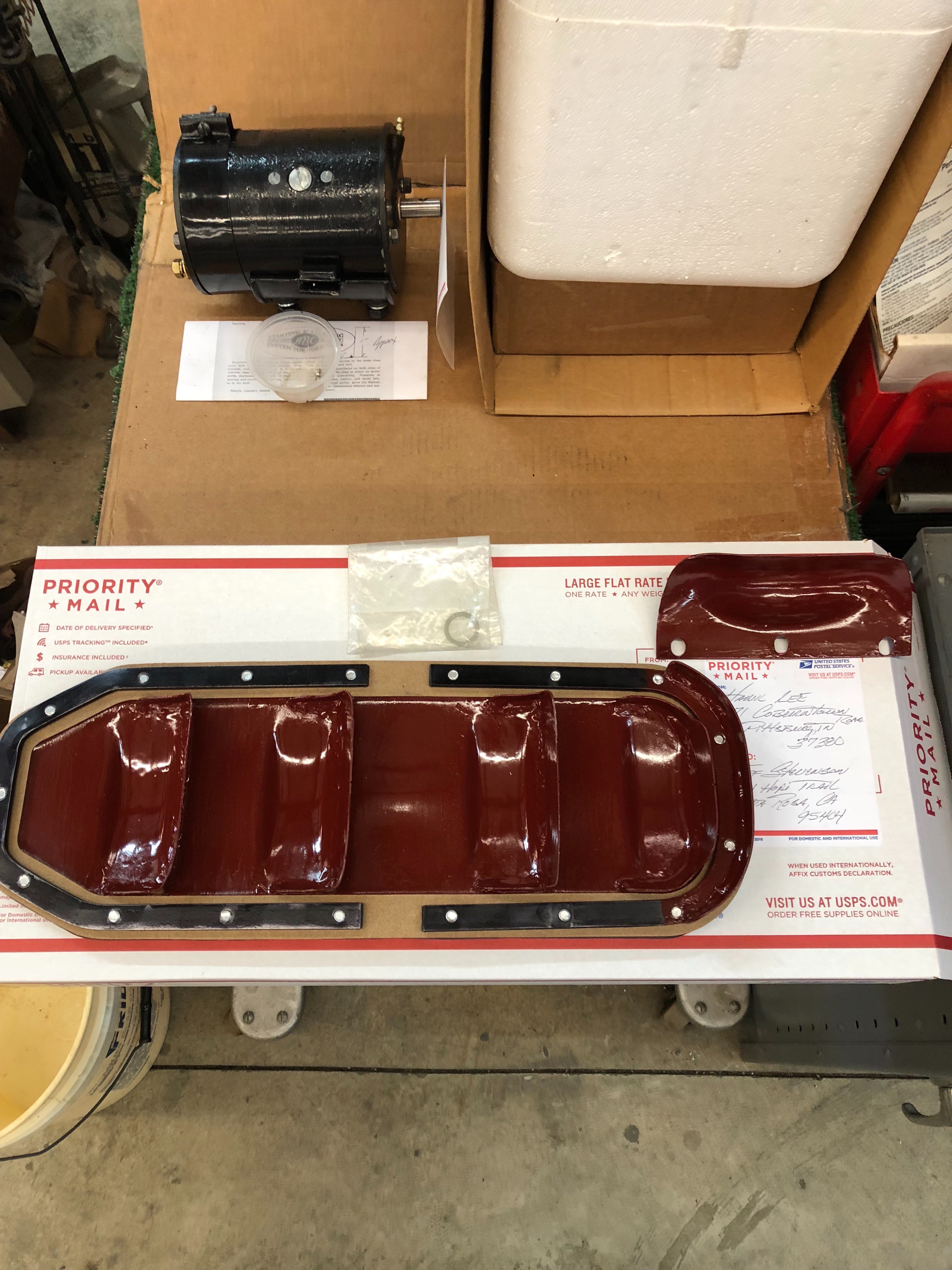

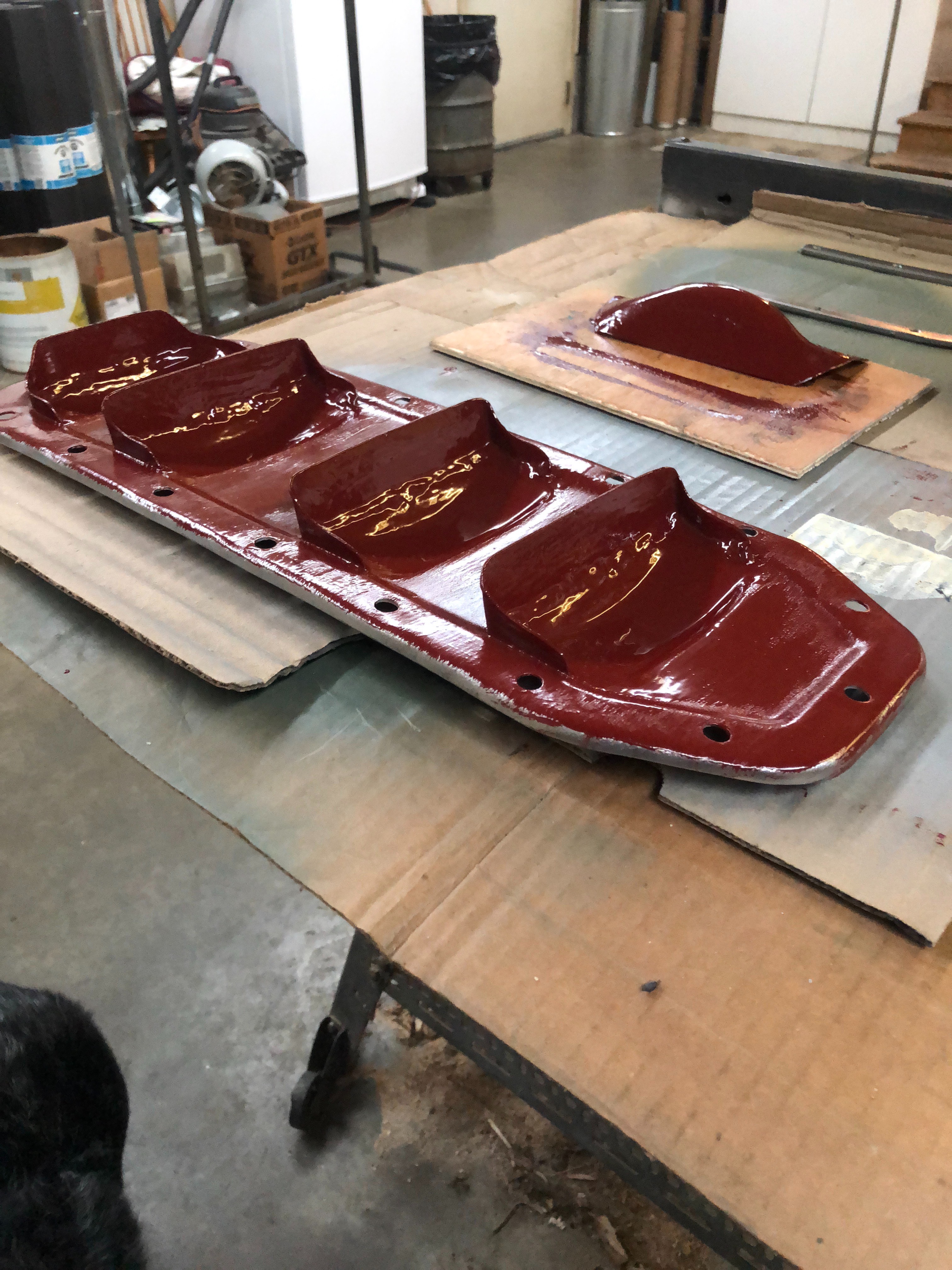

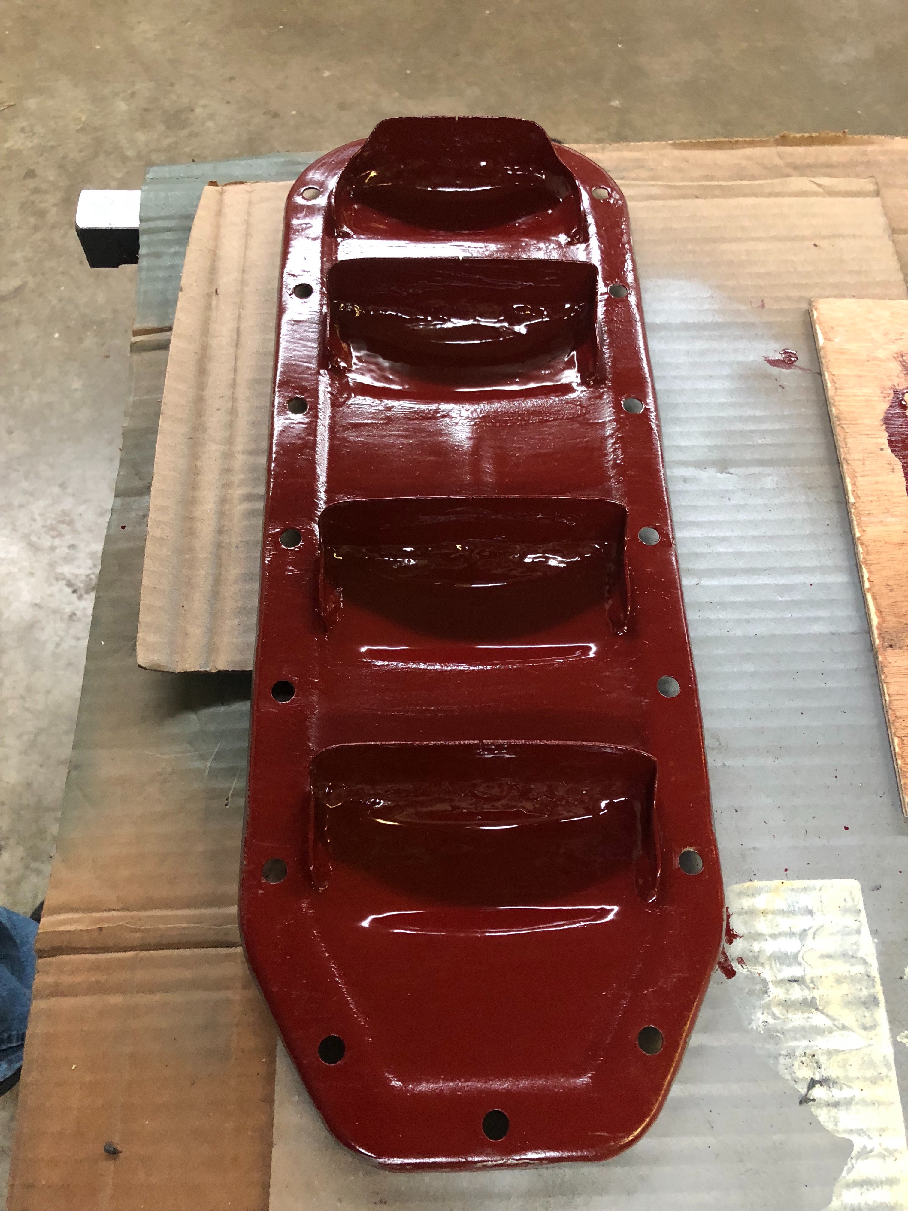

Actually it is just dams toward the rear of the dimples to hold oil for the rods. Ask Admin Jeff to post pictures of the one I built for him, cannot seem to find them. He said it worked out great on his hill.

I braze the dams into my mountain pans.

I have only seen a few of these big oil sumps on model Ts. They have all had drilled cranks and pumps (usually a VW oil pump on the back end of the camshaft, I think). I agree that if you don't have a tray like the inspection plate or an inspection plate with dams in place you are risking the big end of the rods. I assume that the flywheel and magnets should still create enough splash that there will still be a general oil mist inside the crankcase.
