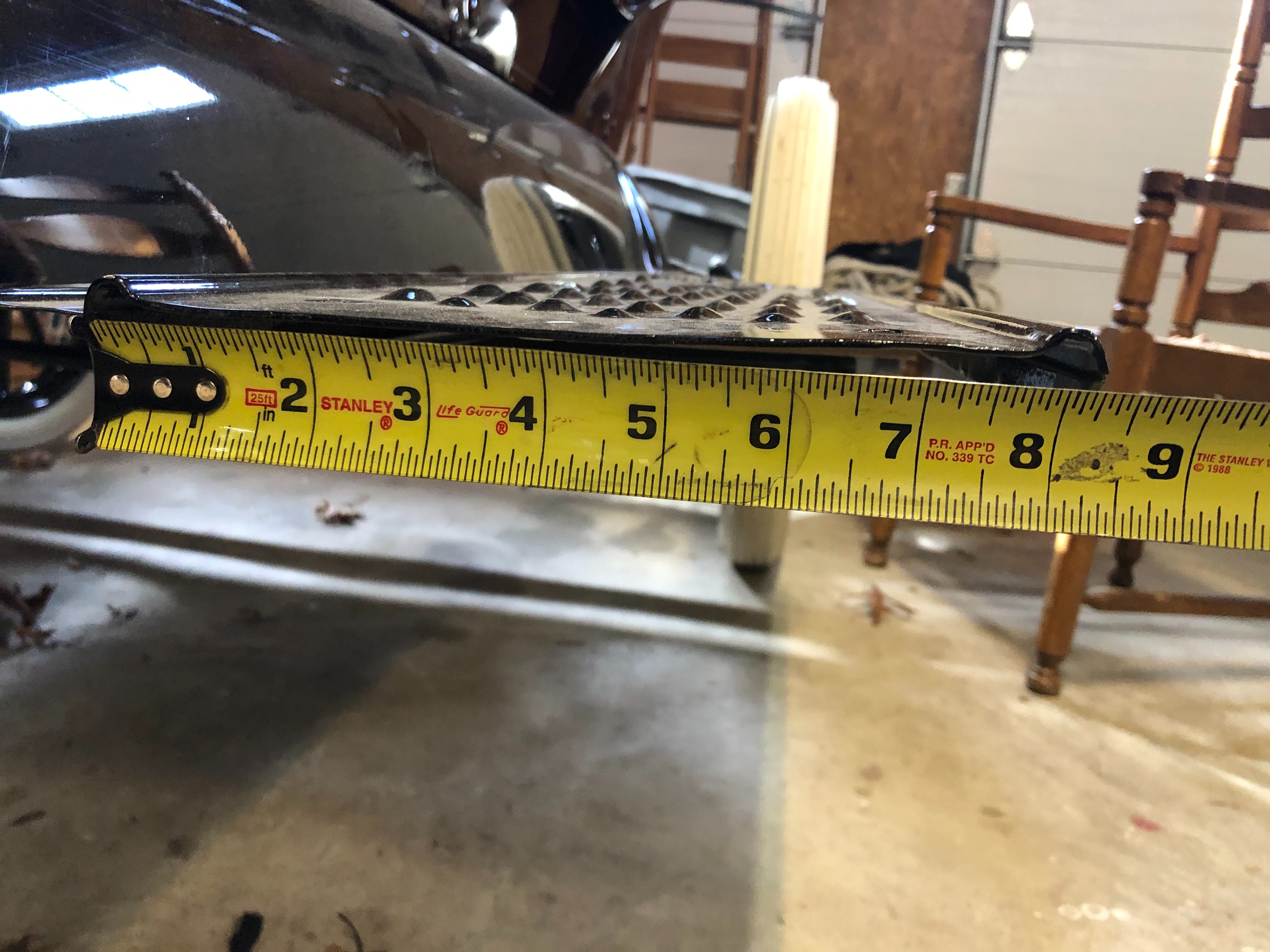

I'm making fenders for my speedster and need the measurements .

Aren't all pre 26-27 runningboards the same width?

I know pre 26 were the same. I don't have one to measure.

Up till 13 there were two sizes of running boards and shields. 60” tread aka Southern Wide Track used a different width board. In 1913 they were changed to use the same shields and boards. Dan

Why has nobody gone out to the garage, measured the width of a pre 26-27 running board, and posted it here?!

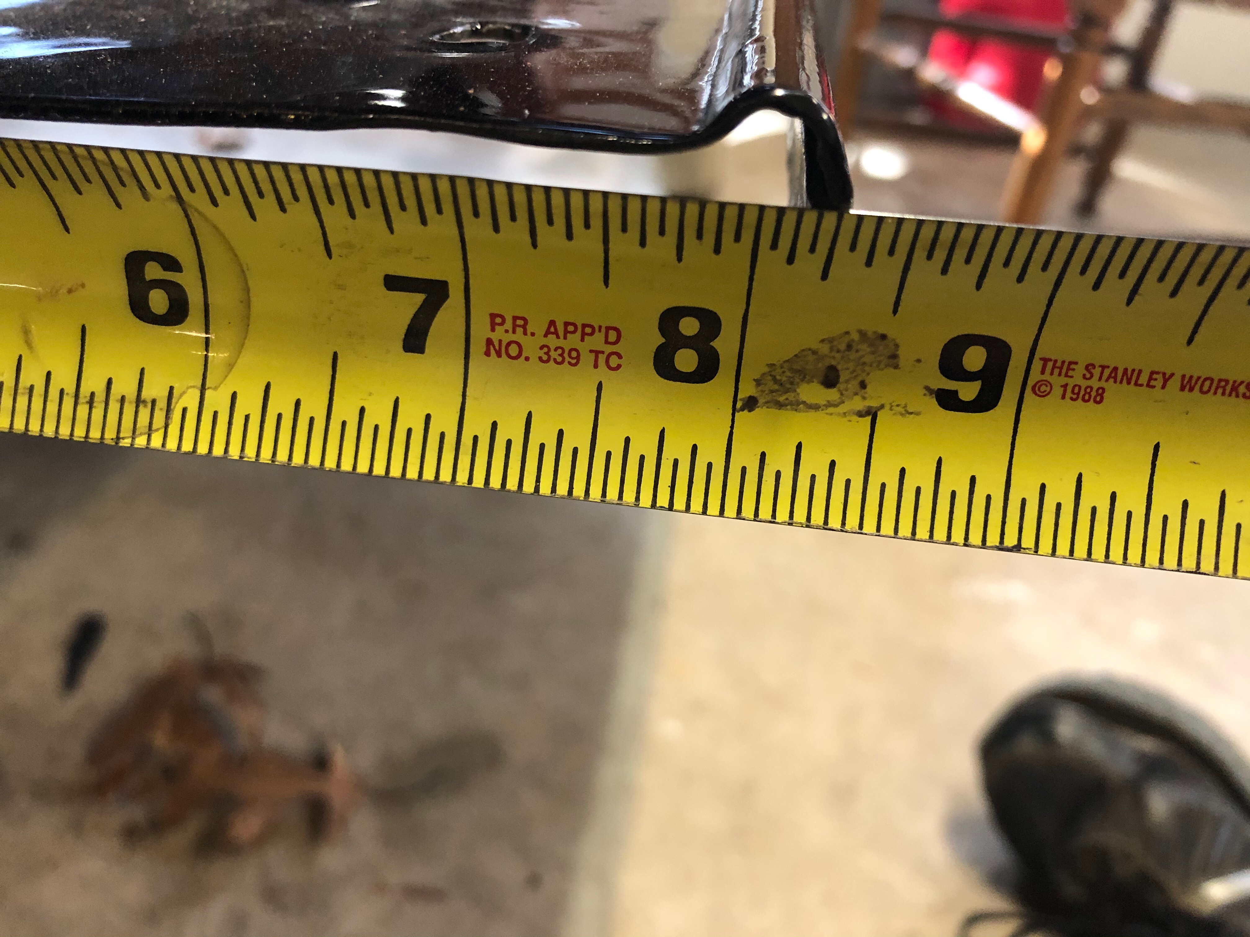

My 1911 Touring. Art

Thank you Art. Just what I was looking for.
