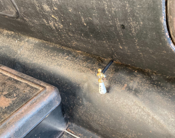

Also...I added this little remote fuel shutoff valve so I don't have to climb under the car. I removed the shutoff at the carb because it was so hard to turn and had a constant drip.
1924 Touring
