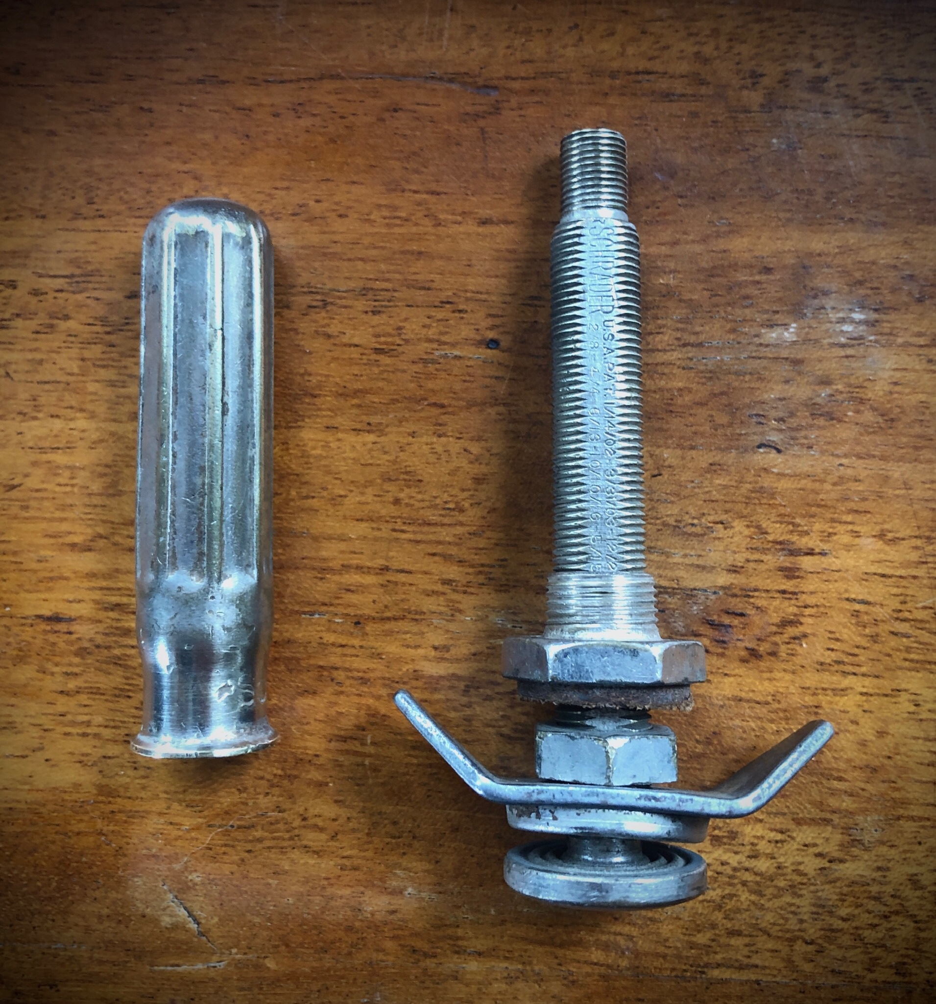

Why I use Schrader 888 valve stems instead of 777's. They are 1/4" shorter, and do the same job, with a few threads to spare. The main reason in weight. They work exactly the same with a 30X3 or 30X3 1/2.
- Posts: 7350
Re: Schrader Valve Stem
The 888 weighs 37 grams. The 777 weighs 42 grams.
Does a five gram difference really matter?
The ¼" does save a few seconds of dust cover twisting (6.75 full twists).

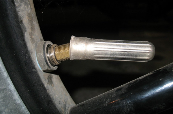

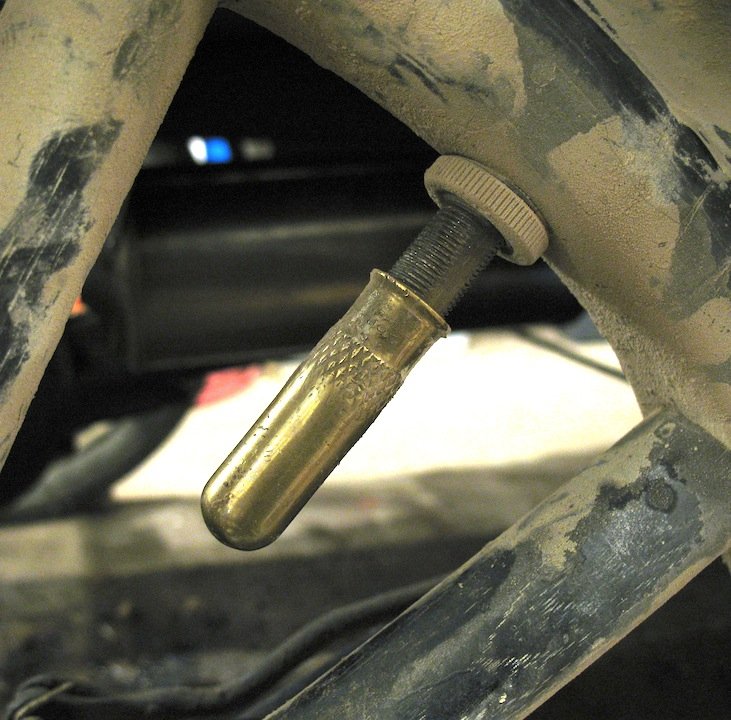

Steve- the stem has no effect on the Cover as it threads onto the rim nut, not the stem.
Dan
Dan
- Posts: 7350
...the stem has no effect on the Cover as it threads onto the rim nut, not the stem.
Depends on the year and the stem.
That's true on this nickel era stem.
But this brass era repop screws directly onto the stem. That may be due to the stems and covers sold by parts dealers today being the larger size that was used on non-Ford cars.

Steve, you must have been posting when I was weighing. The difference I found was just 4g. Then I weighed two bridge washers. One with the pressed in sealing ridge was 10g. A second one having a separate brass sealing ring affixed was 14g, so there goes the difference. Even if the two heavier components are combined the difference is a paltry .28 of one ounce. They might have worried about that on Donald Campbell's world record car at Lake Eyre in 1964, but I figure it is inconsequential on a T. It does make collecting either stems to make a set a lot easier.

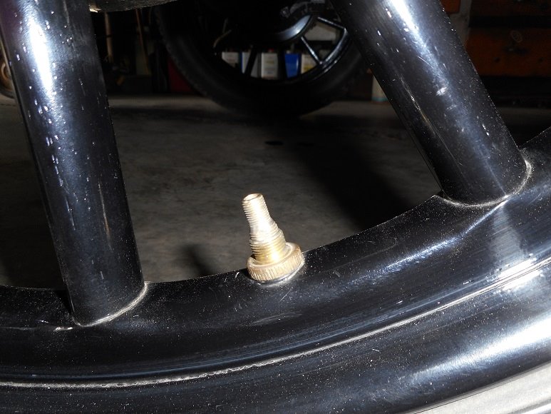

Dan, I have the separate nut and screw-on dust cap on the spare rim/tyre on Henrietta. The nut has nothing to tighten against on a bare stem,and when the dust cap won't let go on the nut, I do have to wind the whole lot off to check the tyre pressure, and on a spare that means even longer trip.
That's another reason why I much prefer the Dill caps with the sliding thread and the valve tool on top.

Just in case some crazy person wants to attempt fabricating a batch of Schrader 777 size stems, page 4 of this document has the dimensions. One issue I see is that they can't just be turned on a lathe, they require two sizes of external threads plus one size of internal threads to accept the valve core.
And, the flats on the large threaded section need to be milled so that the bridge washer can slip on. I measured an original 777 stem and the thickness across the flats varied between 0.335 and 0.337 inches.

If you are using the correct rim nut for a 777 or an 888 Steve, the number of turns to put the dust cap on is exactly the same!
