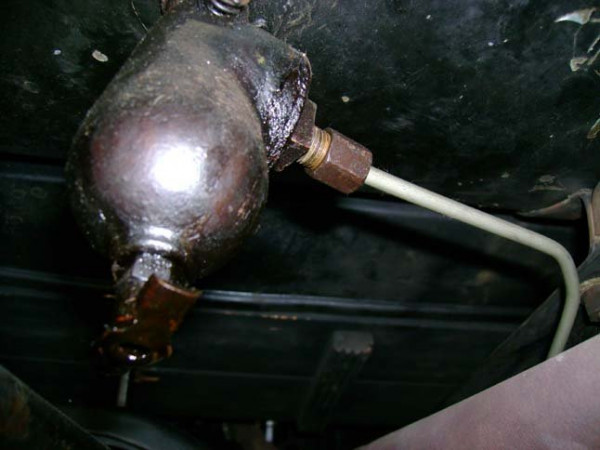

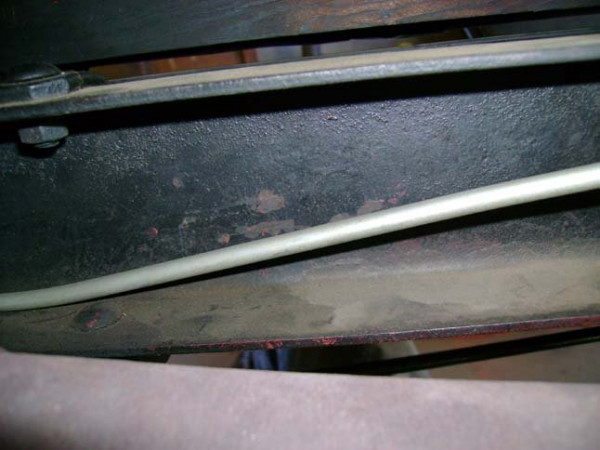

Very nice looking machine!. There are many differing opinions on the routing of the fuel line, but basicly it should go from the sediment bulb across the exhaust pipe to the right frame rail and down to a clamp on the frame rail by the brake cross shaft and up through the corner of the wood block at the engine support to the carburetor. I will post some pictures of how I routed mine and it works fine without a problem.
1. The only filter in the system should be the sediment bulb at the bottom of the gas tank. There is a fine screen inside the bulb.
2. The fuel line should cross over the exhaust pipe but not touching it. Some people put the line under the exhaust pipe. Mine is over it.
3. The lowest point in the line should be toward the middle. It should slope up toward the tank and toward the carburetor. It is important because a bubble in the center could rise to the top and the fuel would only compress the bubble and not flow through.
4. Some people like to put a valve next to the carburetor to shut off the gas when the car is parked. This is easier than crawling under the car every time you park to shut off the valve at the sediment bulb.
Now I will post pictures. I'm pretty sure you will also receive other pictues different from mine. But the 4 items I listed above are very important.

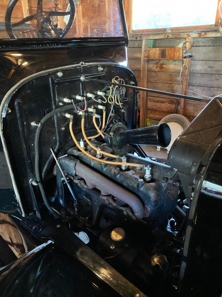

No doubt those who are more pure than I am will disapprove, but I put my fuel line far under the exhaust pipe. I may have problems, but I don't think vapor lock will be one of them.
My fuel shut-off: http://dauntlessgeezer.com/DG106.html.

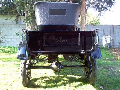

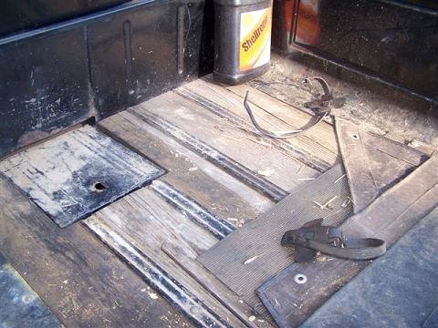

I thought I had some photos of the bed strips, but I don't. Here is a photo of the inside of the pickup box. It should clarify things I hope. The general contour of the bed strips is the same as that of the battery trap door. What makes the tailgate a Model A? Look at your hinges carefully. Notice how the hinge is wrapped around and up to the bottom rivet? The Model T hinges were not that way. It was done because the T hinge is weak in that area, and prone to breaking. Your hinge solved that problem. I believe the change was made in 1929.
pickup bed.jpg (56.96 KiB) Viewed 22850 times

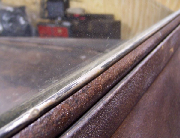

For definite clarification of the rear window on 1925 Roadsters and Tourings, see page 127 in Kreipke's Model T book. I am posting a photo of the tailgate on my pickup here. Keep the questions coming, I love it! You may also wish to look at the rare factory hidem welt tips on the top!
1925 T Pick-up, 1-04-09 002.jpg (55.44 KiB) Viewed 22807 times
1925 T Pick-up, 1-04-09 001.jpg (59.27 KiB) Viewed 22807 times

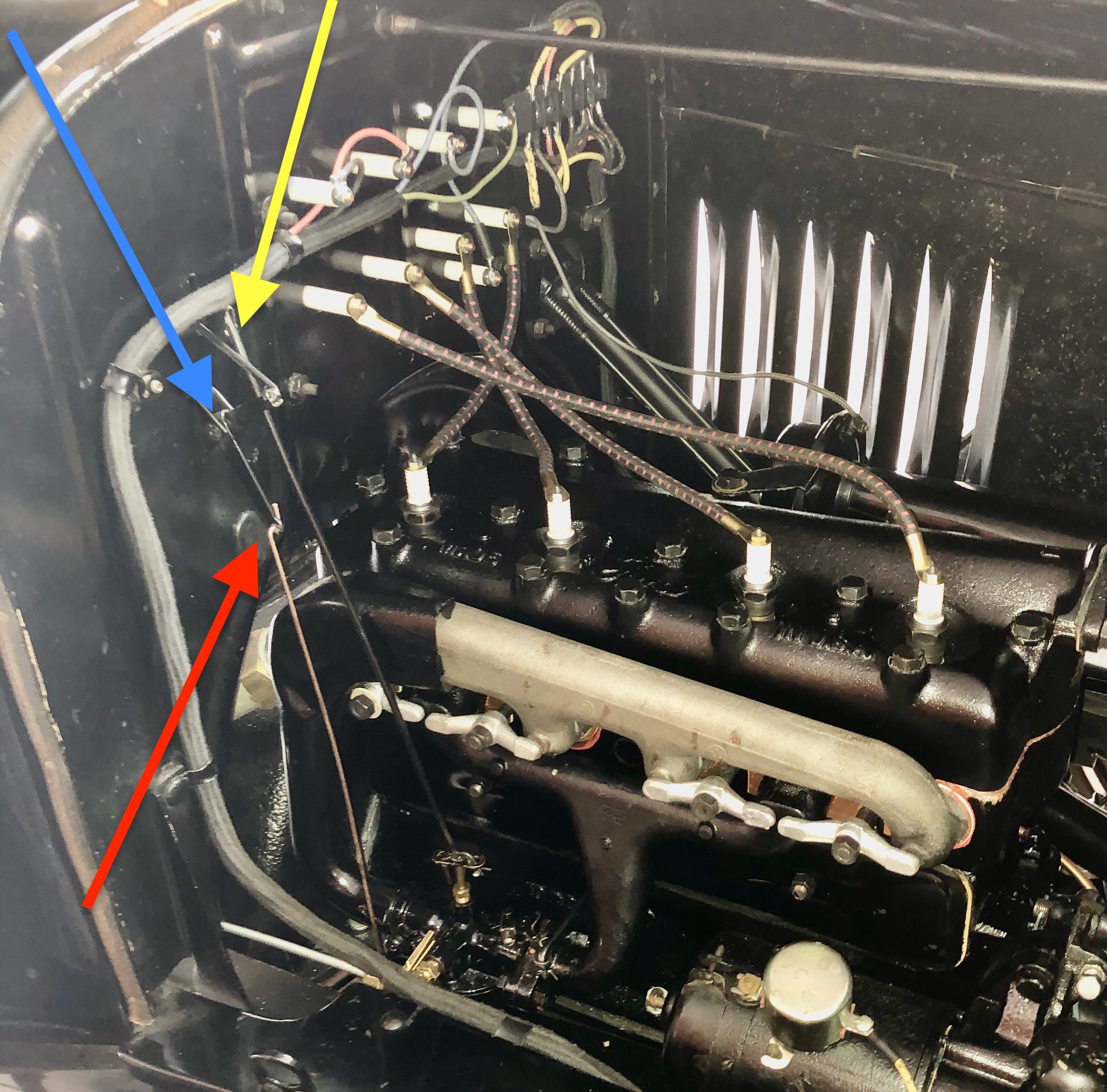

Don't have a photo of a late '25 with the combo choke and carb adj rod, that would be a single rod that passes low thru the hole marked with the RED arrow. The rod goes to the dashboard from the carb, and has a sliding sleeve and a universal joint to allow the rod to pull and twist.
On the late firewall, the bell crank, BLUE arrow would be missing, that bell crank operates the choke to the carb via a rod with knob mounted on the dashboard inside the car. Also the YELLOW arrow shows the carb adj, rod, that operates the needle valve on the top of the carb, and that little rod with angle handle runs up under the dashboard, hard to reach and work.
The new Combo system put the choke and carb adjust to just the same knob on the dash, pull to choke, turn left or right to adjust carb.

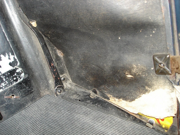

I just got home from work, have been working 7 days a week, and I lifted up the seat cushion. There is a compartment behind the gas tank. I will get more pictures when I find some time, please post as many as you want. The more the better!! The horn mount was probably modified when they installed the water pump. I plan to remove the pump, once I find the correct bolts for the water inlet. I am not sure what you mean by "new style '25 body with steel up front"?

Prior to 1925, the bodies had more wood up front in the door frame and kick panel area. Here is a view of my 1925 touring body showing the metal structure that replaced the earlier wood.

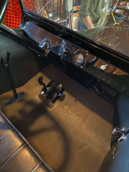

I would like to see more photos of the inside, especially the fit of the floormat. Ford even made a new floormat to accommodate the wide cowl body.

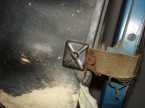

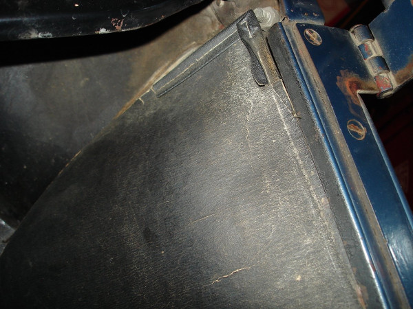

Jerry: Would you kindly post more photos of your rh kickpanel. It sure looks original to me. I believe they installed welting to the top of it, and down to the top of the retainer that is held on my the door hinge.

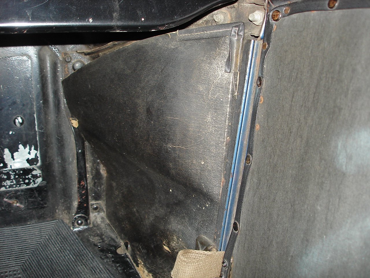

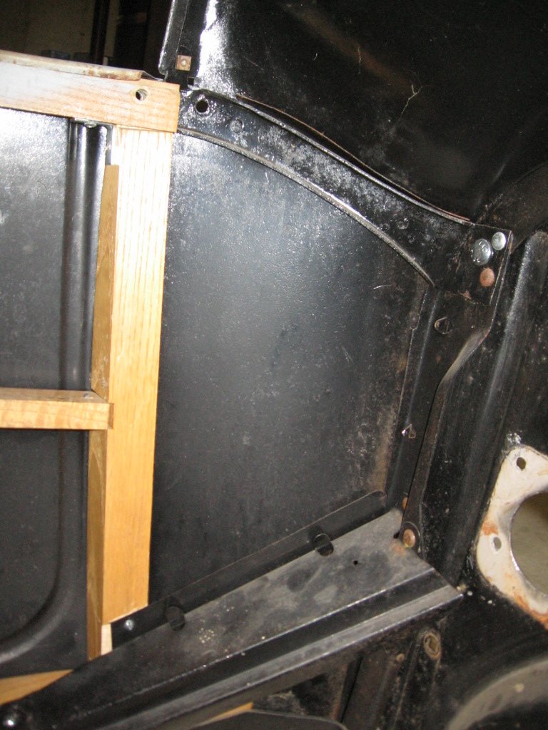

Original Smith wrote:
Sun Nov 15, 2020 10:59 am
Larry,
I'll try. The panel may be original as you suspect, but it's also fairly warped. Hopefully something useful can still be gained...
If it is a replacement, it would have been done by my dad about 1950 and would have been a direct copy of the original panel. Dad would have been fussy about that.
Posts: 3954
Location: Lomita, California
Re: 1925 Roadster Pickup Questions
Post by Original Smith » Sun Nov 15, 2020 5:40 pm
Your photos of the kick panel shows me exactly what I was hoping to see! Thank you!

Can anyone supply a photo of an original open car, wide cowl floormat used only in 1925?
Posts: 3954
Post by Original Smith » Mon Nov 16, 2020 9:12 pm

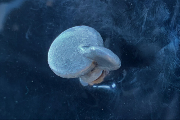

This is a photo of the front top socket used from 23-25. The socket has a raised area, and is threaded for a 5-40 oval head slotted screw. They are used if you wish to use side curtains. The repros won't have this I think.

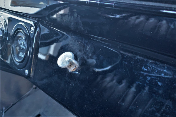

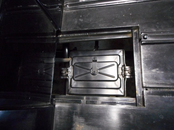

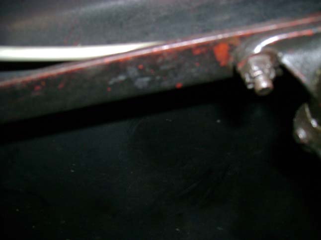

Post by Scott C. » Wed Nov 18, 2020 1:28 am
Here is a picture of underneath the seat. Is this the tray you are asking about?
Here is a picture of the dimple on the dash.
Posts: 3954
Post by Original Smith » Wed Nov 18, 2020 10:48 am
It appears you have the real deal! I suggest you obtain a copy of my article for the 2008? Vintage Ford. It has most of this stuff in the article. Some other things, note your car should have the '26 style dash tag with the clipped corners, and it may have the 26-7, 8 leaf front spring too. This spring lowers the front end 1" and at the same time adds one leaf. Even though the 25 appears to be the same as a 24, they were quite different.

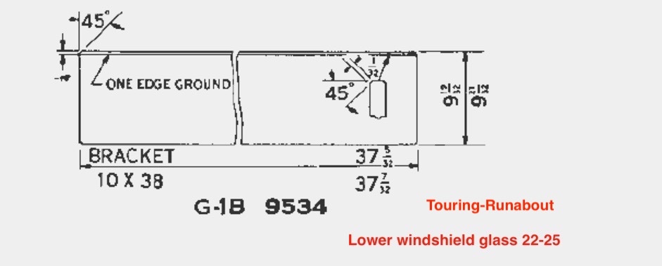

Scott C. wrote:
Tue Jan 12, 2021 1:05 pm
Does anyone have the correct measurements for the glass? I assume that any glass company should be able to cut me a proper size replacement?
Here you are:
Posts: 7413
Post by Steve Jelf » Tue Jan 12, 2021 11:09 pm
You assume correctly. :D

Post by Scott C. » Wed Jan 13, 2021 1:39 am
The lower panel appears to be about 1/4" too short. That is from the 2 caps that hold the glass in place. That left a large gap even with the rubber installed.
Thanks Dan, that is exactly what I need!

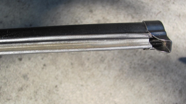

This is the glass clip,
As for bedding with RTV. I've seen it done with & without the "strip". Either way, it always seems to look bad. (Maybe it can be done well. But, the bad ones are the ones I see I guess.)
I have seen tape used when the replacement glass appears to be too thin to fit snug. I beleive the tape used is a special one, made for that purpose, but I could be wrong there.

Jerry pointed out the ‘glass clip”. That end piece is held with a flush flat head machine screw. Originals pulled off seem to have a small piece of bedding tape inside the clip or cap to cushion on the glass edge. Not too much, as the clips or clamps can’t be too high over the windshield frame or the two halves of the frame can’t swing over.
To me the original channel or strip should be used in the frame to secure the glass, just doesn’t look right without. Except of course the Improved Car, 26-27, the open car windshield frames did not use a channel strip, the glass is secured in the frame with only “bedding tape”, used by glass setters, composite cushion like friction tape, most have cork in the composite. A good glass shop will have bedding tape. Don’t use RTV, too rigid, the glass pane has to ‘float’ a bit, or will crack.
P.s. Just modified my prior post to describe to fit the glass pane to the strip first, then push the assembled glass/strip into the frame.

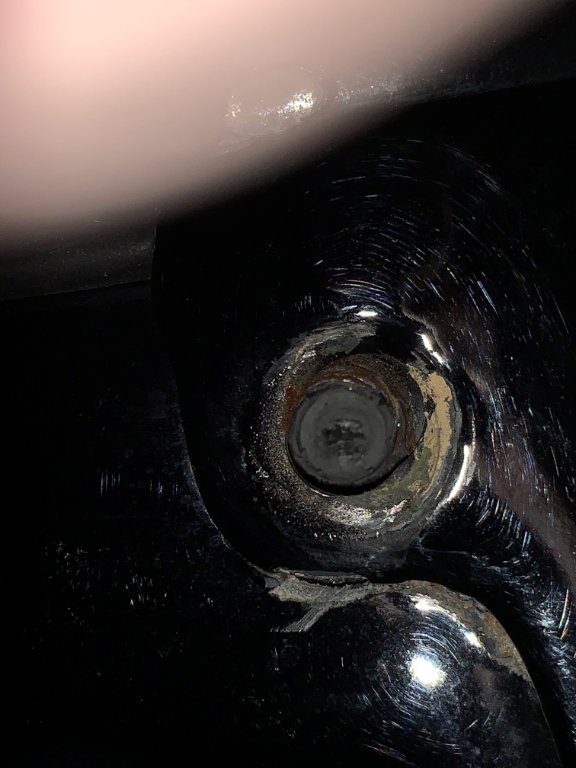

I got the windshield installed. I had to loosen the stanchion screws in the process. One of them does not tighten down. What type of nut should it have on the inside of the cowl?
Posts: 4098
Post by DanTreace » Fri Jan 29, 2021 3:01 pm
The lower windshield frame nests into the stanchions, so you have to loosen them to install or remove.
The upper nut for the oval head nickel plated screw is a square nut with lockwasher, as that one is rather easy to reach.
The lower nut for that oval head nickel plated screw is a special one, long rectangular. The shape allows it to slide into the narrow gap, and the length keeps it from turning as you drive the screw home.
Of course the two outer stanchion bolts are carriage head, with washer and small lock washer and hex head nut inside, both clamp over the upper kick panel cardboard, to keep it in place.

Post by Scott C. » Mon Feb 01, 2021 12:52 pm
I see why the bolt will not tighten back up. There is no nut. Someone put a glob of JB Weld up in there instead of the nut!

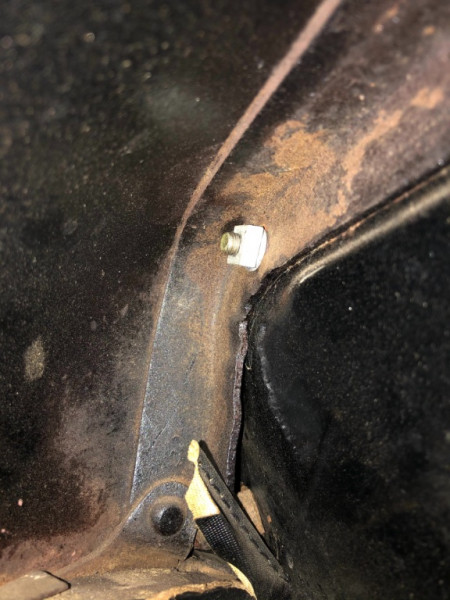

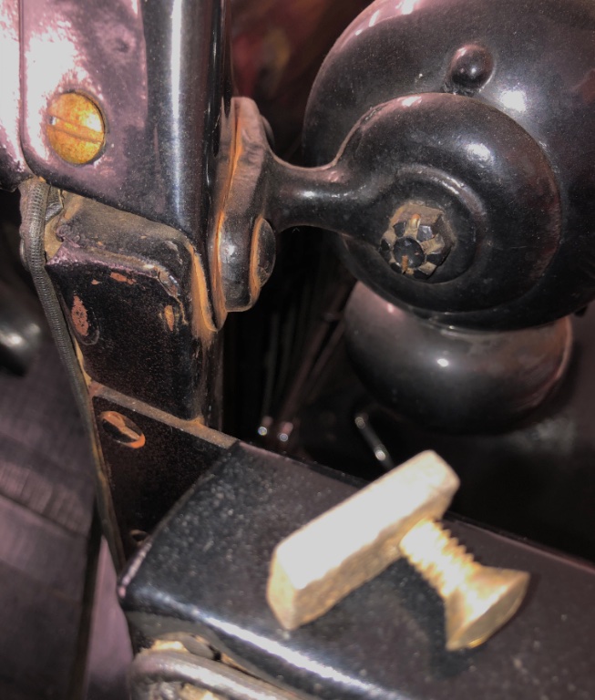

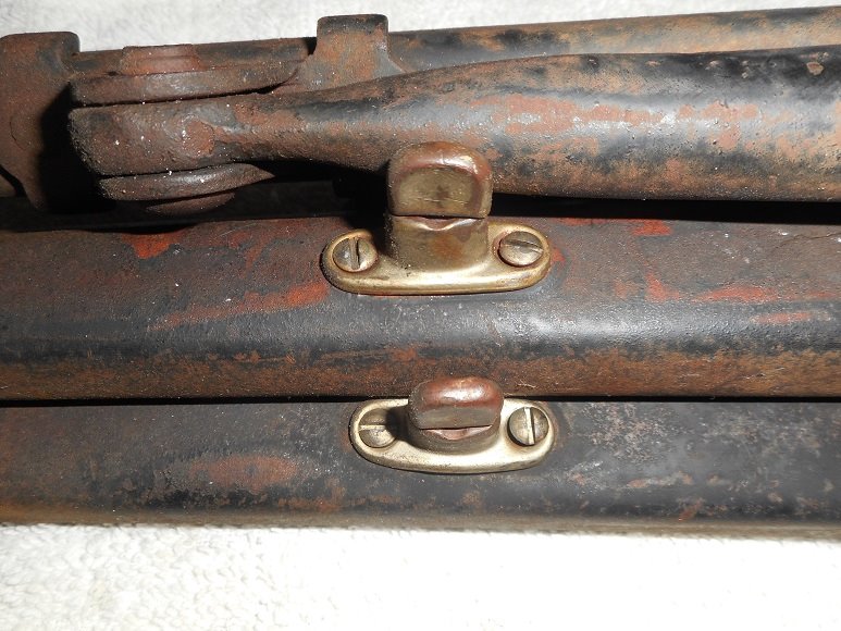

What are the dimensions of that special rectangular nut?
Posts: 3954
Post by Original Smith » Tue Feb 16, 2021 11:42 am
Check the forum, unknown part 1924. I posted the dimensions yesterday.
Scott C.
Posts: 864
Last Name: Clements
Location: Waynetown Indiana
Post by Scott C. » Tue Feb 16, 2021 4:50 pm
Thanks, Larry. I found it!
Here are the dimensions of the last two NOS nuts I have. They can be easily made.
Long: 1 1/2" X 7/16" X 1/4". Short 1" X 7/16" X 1/4". Both are threaded 1/4-20. Oval head slotted screws are used.

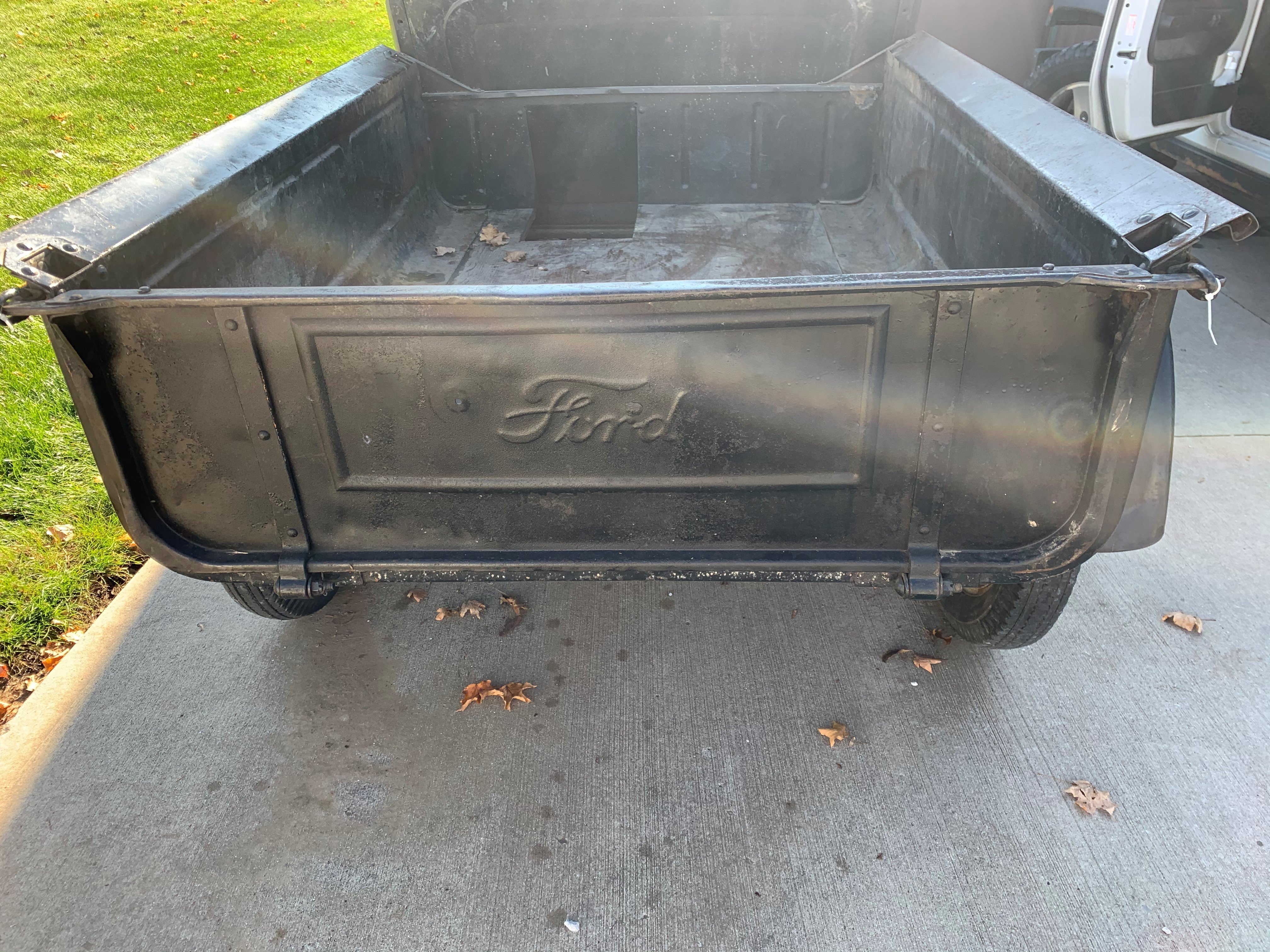

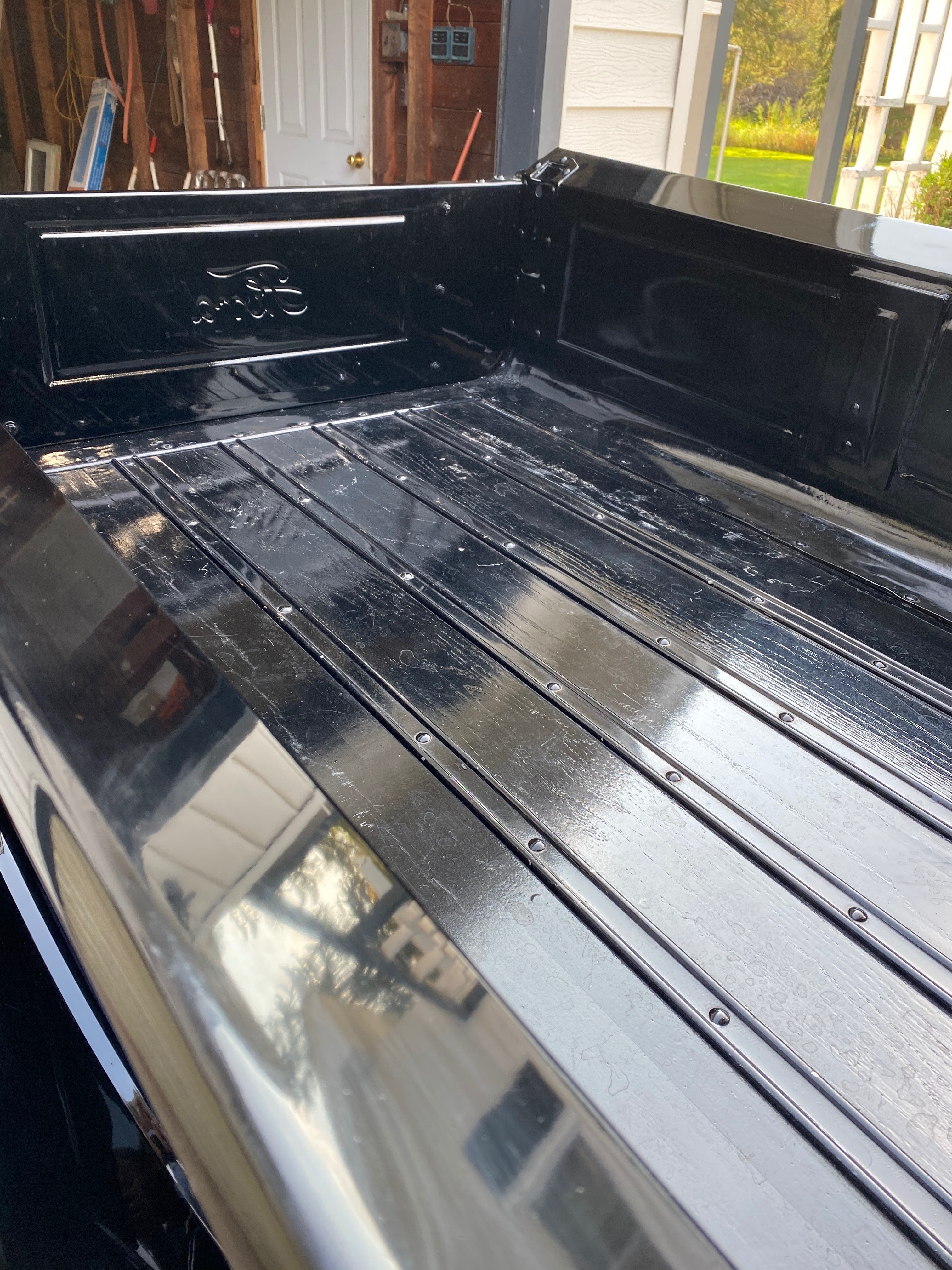

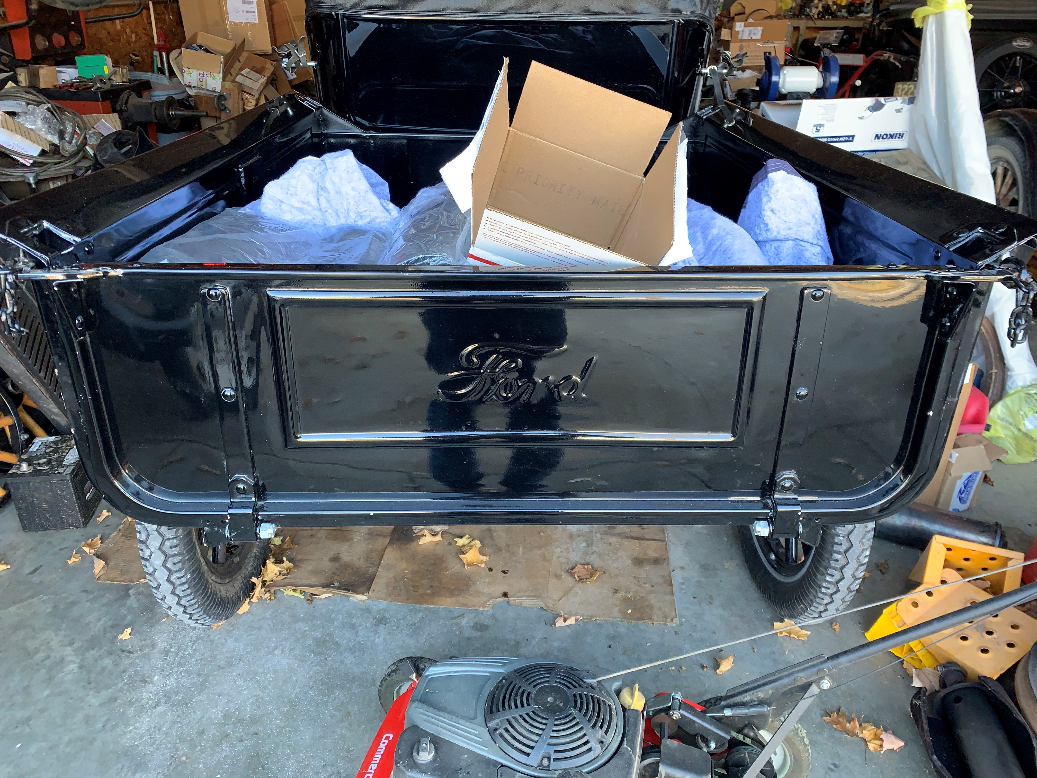

1925 Roadster Pickup box mounting Questions
Post by That Dumb Schmuck » Wed Feb 24, 2021 9:58 pm
Hello everyone,
I'm new to the forum, but have been driving T's for years. My latest addition is a 1925 roadster that came with the box, but not installed. the box was in very rough condition but I've gotten it mostly straightened out, made new wood, and want to get it attached to the roadster. does anyone have the instructions that would have come with the box when new? anyone have some images showing the underside of the box and how it mounts? looking at the images, there appears to be a way to mount my spare tire under the box in the back? I'd really like to figure that part out too.
I've looked around the forum a few times. lots of great info out here, just can't seem to locate a thread on how to mount the box or how it attaches. Is there anyone out here who can provide the info our give me a little help on where to find it? every little piece of information is appreciated. I look forward to learning more about the first factory pick-up ford made! :)

I bet Larry has the correct answers. But, I can get some pictures of how mine is mounted, when I get a chance.
Posts: 3954
Post by Original Smith » Thu Feb 25, 2021 10:49 am

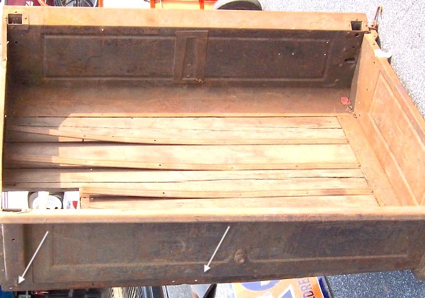

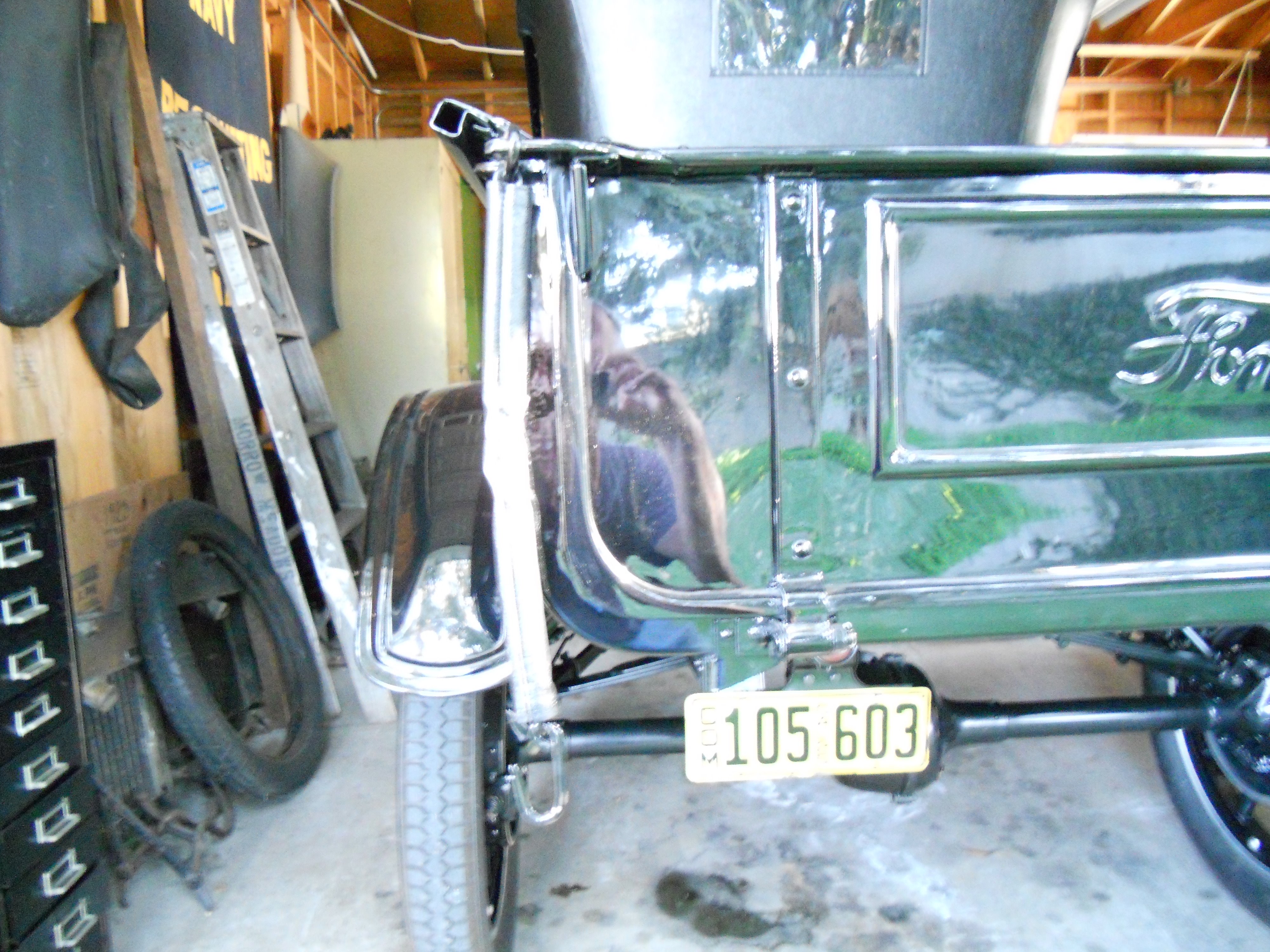

The pickup box should be put on with CARE! The center strip must be firmly bolted to the rear sill of the body. Most of these have been removed, because most beds have been made into trailers. There is only about 1/4" between the front of the bed, and the back panel of the body. Without looking, there are three bolts across the back, and three on each side. I hung a moving pad over the back panel just in case of a problem, and had about three guys on each side to help me lower it onto the rear deck. Take your time on this. There is no room for error!

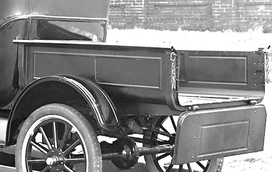

Posts: 4098
Post by DanTreace » Thu Feb 25, 2021 11:23 am

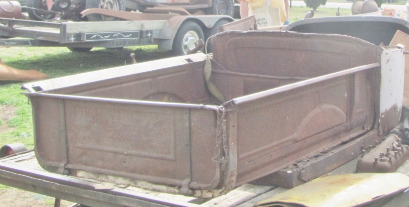

Larry
Thanks for the info, wish I have a good photo of the attachments for the '25 bed. The '26 bed differs as it has an outward flange that rides on top of the runabout all metal side sill, with long bolts vertical.
As I understand, the '25 bed has 'aprons' on the side that wrap down the outside of the '25 runabout deck. And bolts go horizontal into the metal covered wood frame rail or sill?
25 bed copy.jpg (102.83 KiB) Viewed 18822 times
'25 bed. Do the arrows show the mounting points for horizontal bolts?
'26-'27 bed rides on top of the all metal sill.
Posts: 3954
Post by Original Smith » Fri Feb 26, 2021 7:42 am
Yes, the arrows point to the correct mounting bolt holes. Note the two in the rear are the standard body to frame bracket, and the half moon avoids the lower bolt. If your sills haven't been drilled don't do it until you get the bed installed, and make sure it's laying absolutely flat before drilling.

Thanks for the info everyone. I'm going to have to figure out how to post a separate forum item...
Seems odd that it's just those few side bolts that would be enough to mount the box, but it's a good start. Might make more sense once I set it on the back.
Jim Sims
Posts: 181
Joined: Sun Jan 06, 2019 12:38 pm
First Name: Jim
Last Name: Sims
* REQUIRED* Type and Year of Model Ts owned: 17 touring 20 roadster 21coupe 25tudor 25 pickup 27 coupe
Location: Reed City, MI
Post by Jim Sims » Sun Feb 28, 2021 12:42 pm
You have the bolts thru the side rails, But they are bolts thru the metal strips in the bed and thru the wood platform under the floor of the bed,

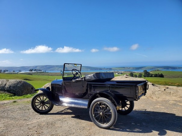

Posts: 3954

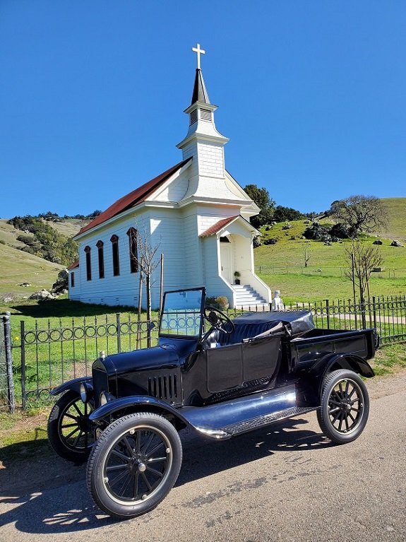

Post by Original Smith » Thu Mar 04, 2021 11:17 am

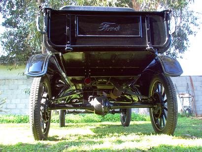

Here are two photos of my 1925 Pickup on a tour this week. She turned over 8,000 miles on this tour.

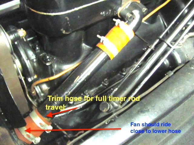

I removed the water pump today. I bought the 27" belt that the vendors sell as correct for 25 and it is too short. What length of belt should be correct for a 25?
Posts: 5601
Post by RajoRacer » Fri Apr 02, 2021 10:05 pm
Are you running the stock fan & pulley configuration ? I don't see the fan arm attached to the timing cover on any of your photos posted up top - is the fan mounted on the cylinder head outlet ?
Scott C.
Posts: 864
Last Name: Clements
Post by Scott C. » Fri Apr 02, 2021 10:32 pm
No, it does not have the same setup as my 26. It has the arm and an adjustment bolt on the timing cover.
Posts: 4098
Post by DanTreace » Sat Apr 03, 2021 9:36 am
Re-check the parts to be sure correct for '25 as the 27" belt is what fits with stock parts. The arm, fan pulley and the crank pulley size can affect belt needs.
And adjust the arm holding the fan pulley so the blade rides toward the lower the face of the radiator for best cooling, the blade should just clear the lower pipe/hose by an inch or so.
