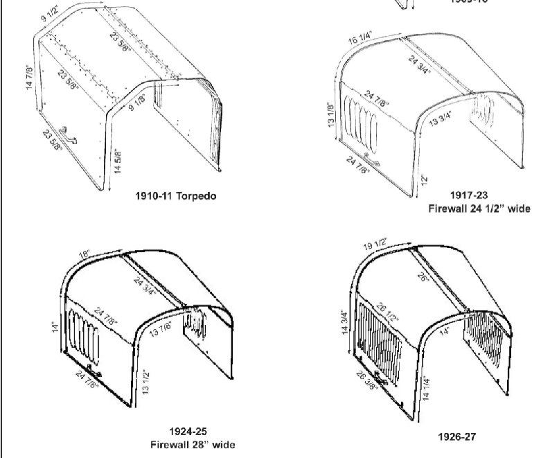

Here are pictures of firewalls , hoods and shells to help you figure out what you have.

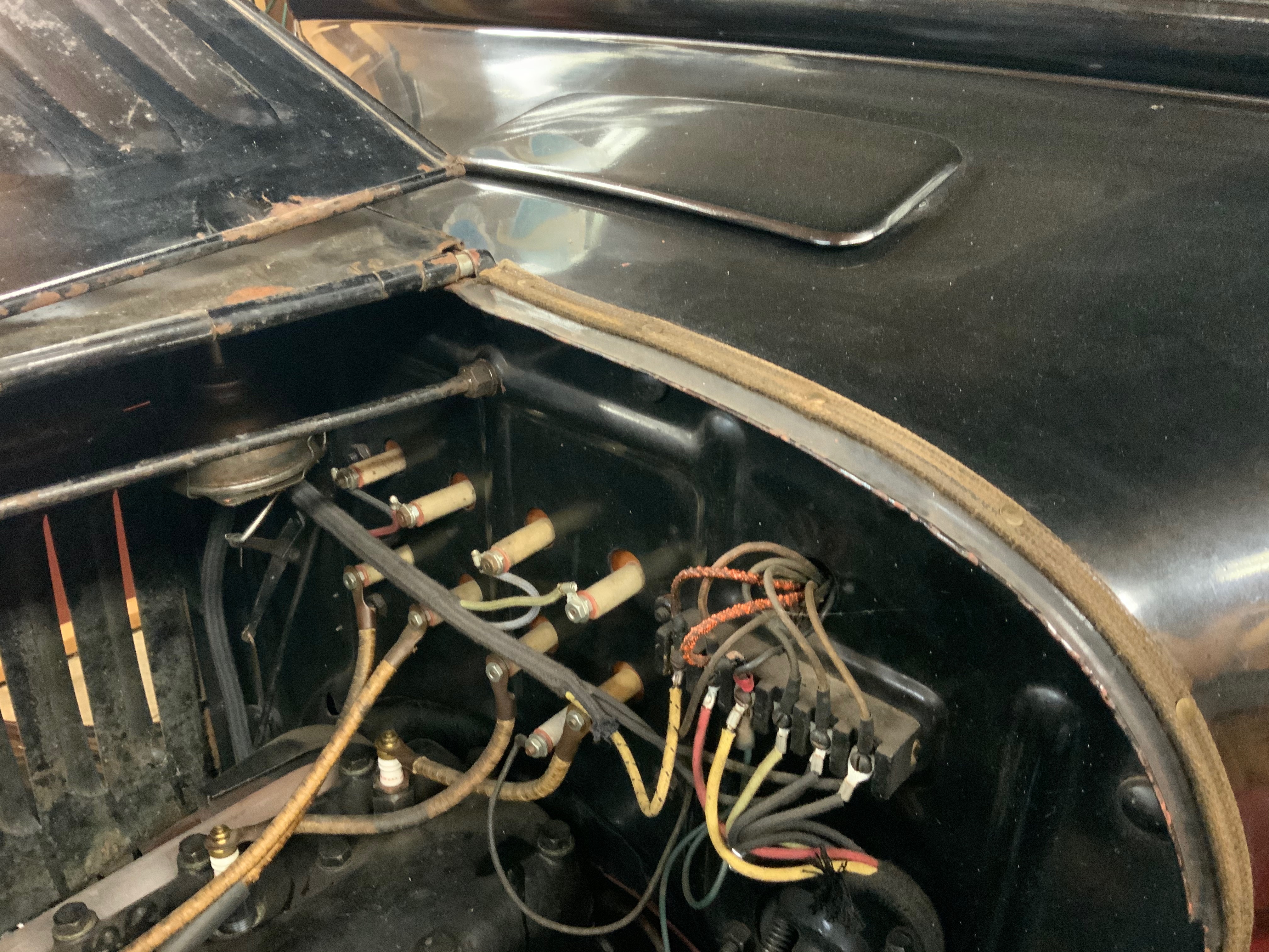

She does in fact have a cowl vent. The bent frame concept was one of my initial thoughts. I'll post some pictures if I can fumble my way through that.

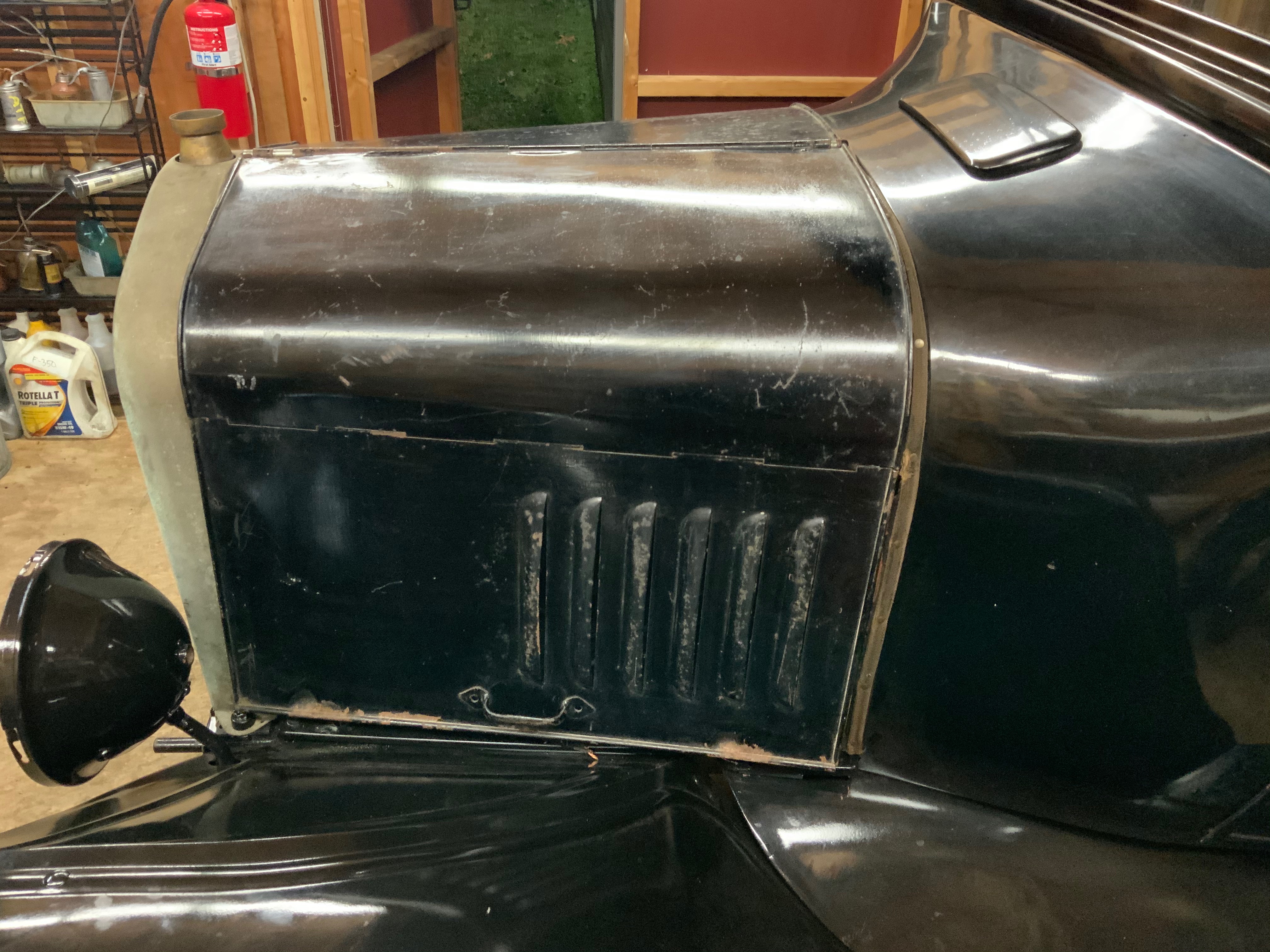

Re: Low radiator- high radiator production cutoff
[image][/image]

- Posts: 4695
Your car is a high cowl 24 or 25 going by the cowl vent and appears to have the correct parts on it. You could obtain a better fit between the cowl and hood by shimming the 2 front body brackets a little. Try starting by using two washers. You may need to loosen the 2 center bracket bolts to get it to move up some.
If you suspect the frame has a dip in it because of a collision shimming the front end of the body would be an alternative to trying to straighten the frame itself.

- Posts: 7302
David, all looks OK as far as correct parts go. Your 1 1/2" looks more like 1/2" and a sagging frame will do that. If your radiator shell is a nickel plated brass shell, it is imperative that the poor fit be corrected. The steel shell hood will wear through a brass shell if it is allowed to rub on it. New hood lacing may be the order of the day to help with this.
