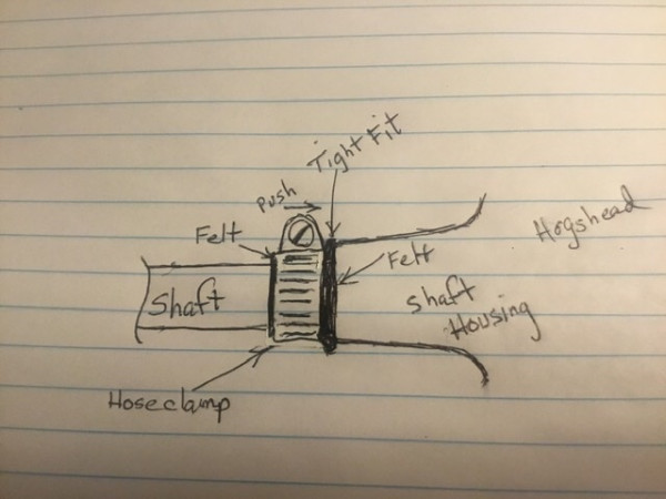

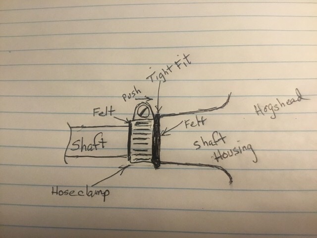

The following is not a temporary fix, but a permanent fix, at least for the next several years. To seal a transmission shaft leak, it is necessary to remove the drive plate and the fourth bearing and have the drive plate shaft turned and the fourth bearing re-babbited to match the drive plate shaft. I had this done when I rebuilt my engine in 2010 and it still does not leak from the rear ball cap. The rear of my transmission is also well supported, which relieves a lot of stress from the crankshaft flange and reduces vibration. Jim Patrick

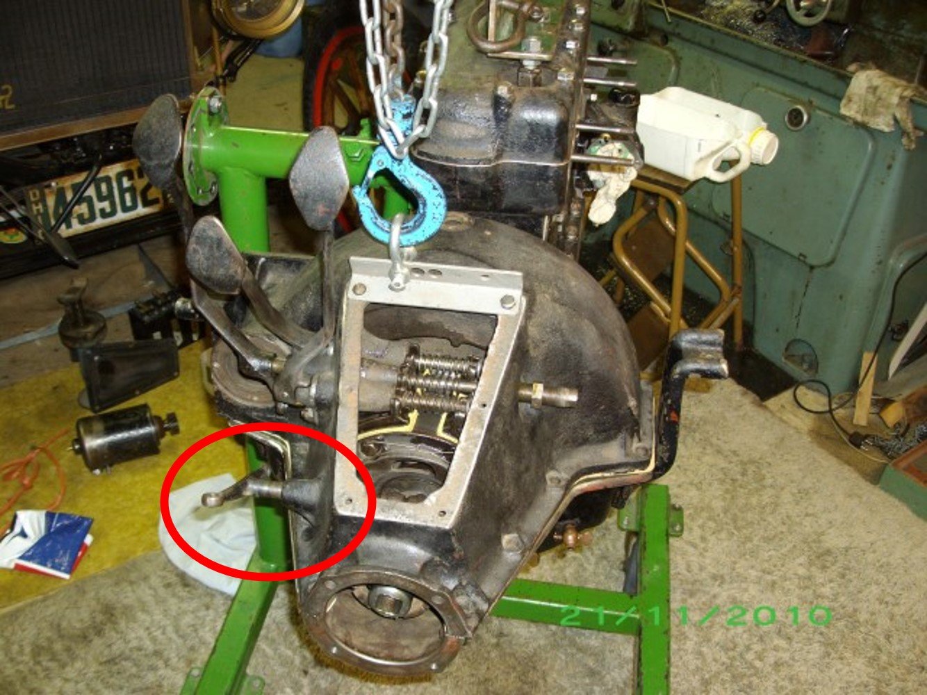

Post by CudaMan » Sun Nov 01, 2020 5:48 pm
Or the high gear shaft (circled)? Slowing a leak there could be a challenge, but if it's just one more day maybe just wrap the exposed end of the shaft with a lot of felt or a rag wrapped with duct tape. If nothing else, it will filter the oil that leaks out.
If it's the transmission output shaft, I would think that just pumping the ball cap full of grease would slow down the leakage enough to get through one more day. :)

Cudaman,
That's the point that is leaking.

Felt has always been used by Ford as gaskets to stem the flow of oil and fuel. Three that come to mind are the hogshead, the front crankshaft seal and on the fuel valve, so, I see no reason why felt would not work here. If you have an extra hogshead felt strip gasket, wrap it around the shaft leaving a portion lying flat around the shaft and push the felt up tightly against the hogshead where the shaft enters the hogshead then tighten a hose clamp over the flat portion of the felt, thus holding the felt in place tightly against the hogshead where the shaft enters. In case the felt somehow slides away from the shaft housing, a second clamp tightened onto the bare shaft and pushed tightly against the first clamp and felt will keep it securely in place. Jim Patrick.

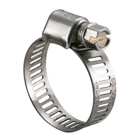

Post by jiminbartow » Tue Nov 03, 2020 12:36 am
Good thing about those clamps is that they can be totally loosened and opened up to wrap onto the shaft, then re-threaded like a belt and tightened. Be sure to get a big enough clamp so that you can easily re-thread it. Any excess can be cut off with a Dremel tool equipped with a thin metal cutoff blade on an EZ Lock shaft. Jim Patrick

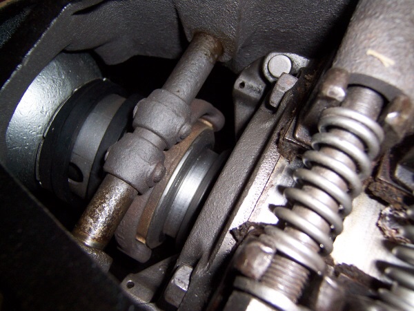

I don’t believe the felt repair is the best way to solve the leak issue. The shaft should be allowed to float left and right on its own. If you push a piece of felt against the hogshead and clamp it, you are loading the internal clutch release forks, the bronze clutch release collar, and the clutch yoke collar against the driving plate pulling everything to the left instead of allowing them to float. I’ve taken apart a few engines that have had “repairs” like this and the side of one clutch release fork and one side of the bronze release collar were worn enough they couldn’t be re-used.

Open up your transmission inspection cover and look inside. Put your hand lever all the way forward. Now move the clutch release shaft left and right. It does have a certain amount of lash. The mid-point of this movement is its natural center and where the internal clutch release parts aren’t wearing against anything when the car is running in high gear... Keeping it “pulled” one way or the other causes long term metal-to-metal contact on some moving parts that were never intended to work that way.
Short term, you can get away with a repair like that. Long term, it chews up the area in the clutch release arms where the bronze collar mounts. I’ve seen them chewed almost in half from a common shadetree “Fix” which involves a very light spring, washer, and o-ring on the inside of the hogshead. The spring generally has just enough push to keep the o-ring seated and even that small pressure causes wear issues within a few thousand miles.
