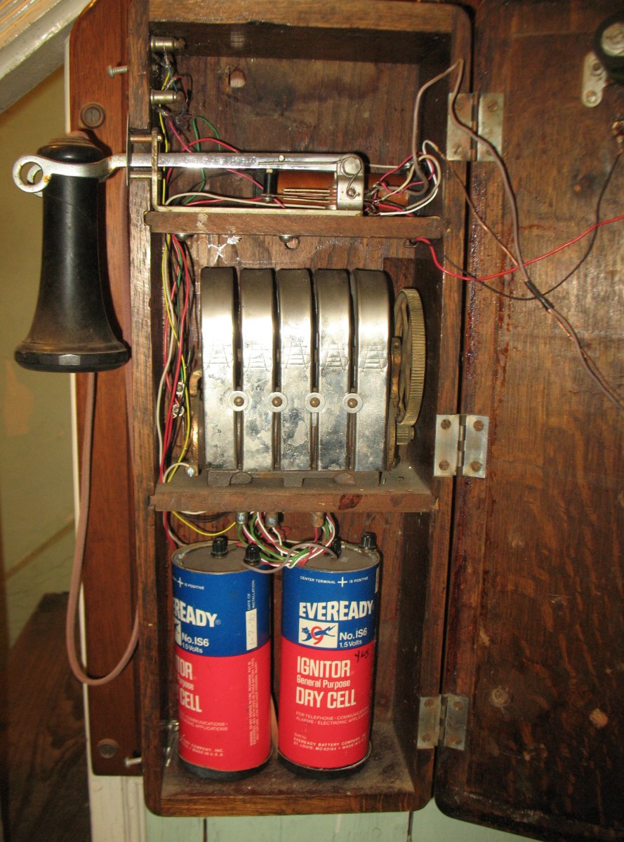

Post by Steve Jelf » Mon Feb 25, 2019 10:08 pm
These are the telephone dry cells Wayne mentioned. In Model T times they were plentiful and cheap. Now they're scarce and costly. It you're adding a battery to your early Ford there are much less expensive ways to go.

Steve ,Would i be correct to think those round dry cells were 9 volt? Thank you.Bud.
Kerry
Posts: 1464
Last Name: van Ekeren
Re: 1909 Battery Location
Post by Kerry » Fri Mar 01, 2019 3:28 pm
1.5 volts, blow the photo up and can be seen written on them.
