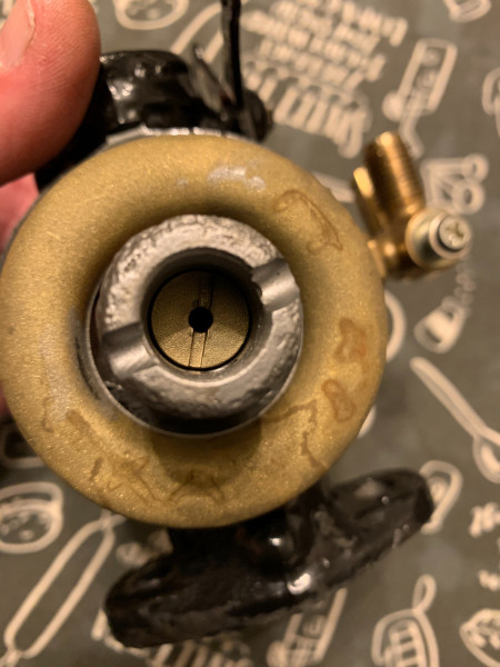

Re: Carburetor Problem
[image][/image]
Pep C Strebeck
- Posts: 650
- First Name: Joseph
- Last Name: M
- Location: MI
When they are saying Grose Jet, they are referring to the float valve, not the needle seat that you are showing in the photo. Grose Jet is a particular style. Slide out the pin holding the float in place to reveal the float valve to see which style it is.

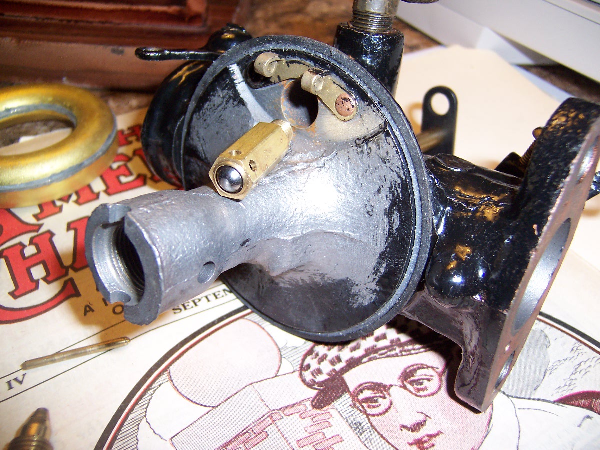

View of the ball style Grose float valve, one-piece with seat, unscrewed from the carb. The float has been removed by pulling the float pin from the hinge.
These stick in the closed or open position and can cause leaks or shut off gas flow. They aren't designed for gravity fuel systems.

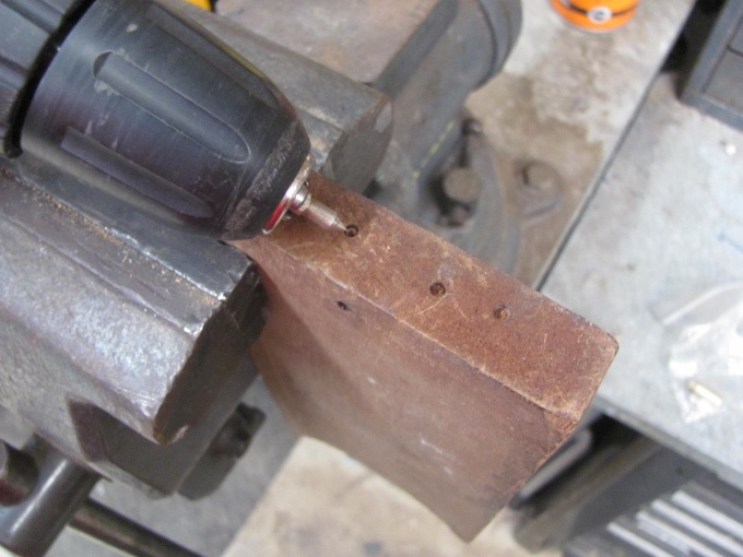

You could use the Vitron tip style made similar to original, but sometimes these stick if fuel is left in the bowl at storage.
IMO, the original steel type are the best, if you fit the needle to a new seat, the seat the original type, by slight tapping and spinning, to have the angles of both the same.
Also, first 'dress' the tip in hard wood to burnish the finish very smooth.

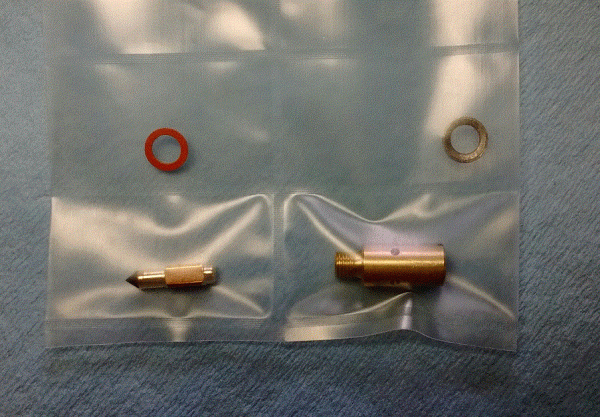

There is also a third option:
- Posts: 7413
Scott's valve has received very favorable reviews. If I didn't have an original I would get one of his.
