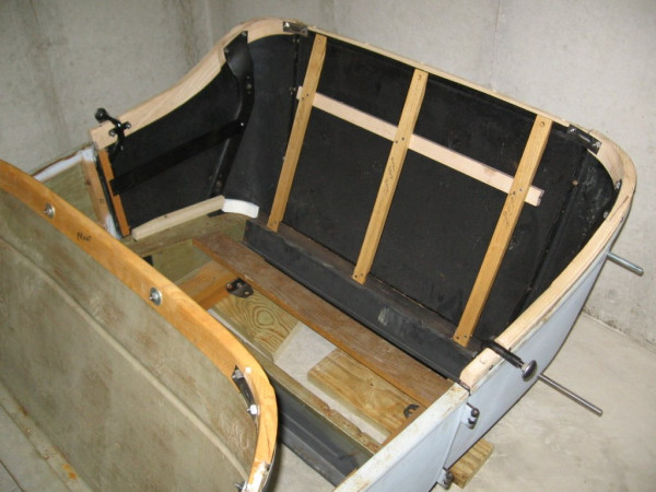

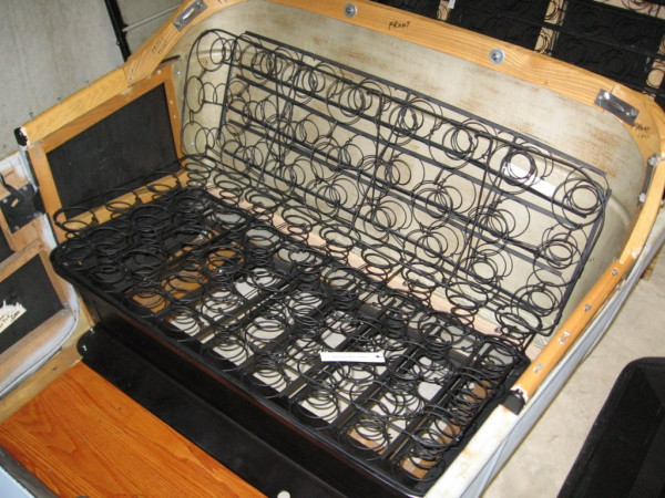

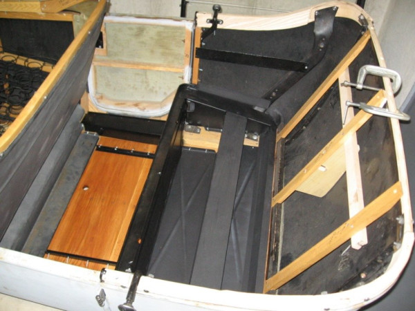

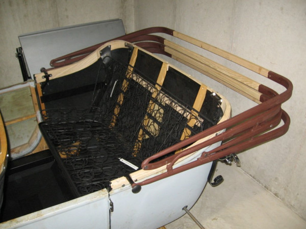

I'm back on my PC this morning, here are some pics of the 1925 touring body I have in my basement. On the wood kit that came with the body, the vertical slats are rabbeted at the bottom and fit into dados in the lower horizontal piece. The top part of the vertical slats have the angled portion facing to the rear. Each slat has a countersunk hole in the top for a flat head wood screw that goes through a hole in the body flange and into the narrow wood piece that sits onto the top of the body flange. Not necessarily identical to a 26/27, but pretty close.
My 1924 pickup started life as a touring car, but a prior owner cut off the back and added the tilting pickup bed. I bought this touring body from Bob Bergstadt a couple of years ago just in case I ever wanted to return my car to its original touring configuration. :)

Post by Mopar_man » Wed Nov 23, 2022 12:11 pm
Thanks!!! I like how the bottom of the wood attaches. Mine is cut at angles on both ends.
