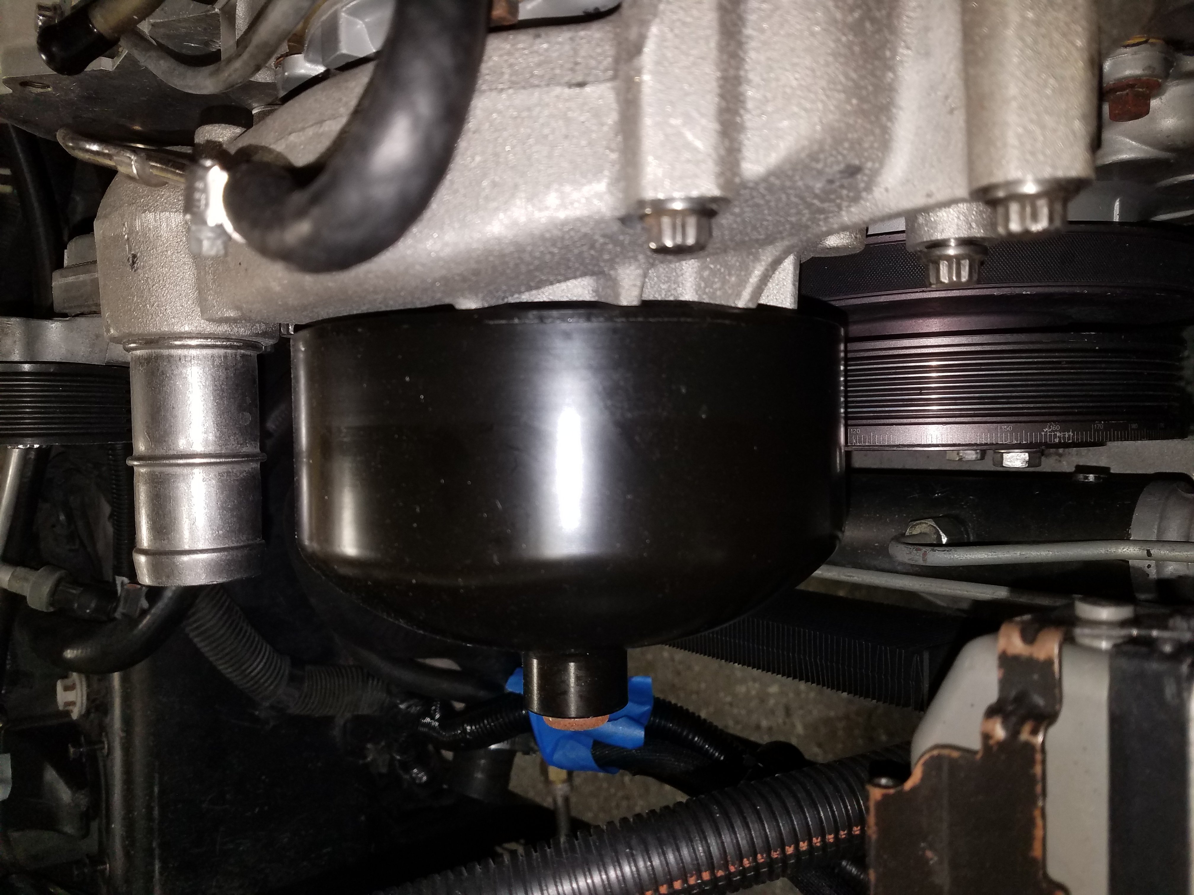

You may be correct about wear, but it works fine.
This pulley has more time than any T will ever see, and grips fine in a race motor.

You can't get the same tension on a T belt as a modern race engine. The fan bushing wouldn't last 5 minutes, clean steel slips enough with a bit of oil around let alone the slippery surface of 2 pack paint added as well, it's why race engines paint glyptol in side an engine, to have a frictionless surface. I wouldn't be painting it.

The coeffecient of friction of bare steel on leather vs powder coat and leather is virtually the same.
.5-.6.
I am fully aware of T requirements.
A rubber impregnated belt is slightly improved.
