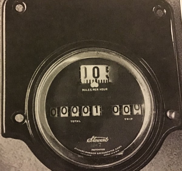

Hey Larry; Thanks for the info, but I'm in Florida and my books are at home. Do you have a pic of the Stewart 160A. I'm looking at a Stewart with the odometer reset wheel to the right and above the center line of the face and fits through a slot in the cover/mounting ring. Cheers : Bruce

160 A

Hi Dan : Thanks for the picture. That's what I thought it was. Where are you, I'm in Zephyrhills. Cheers : Bruce
