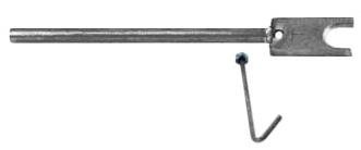

Just bought the valve compression tool from Lang's (3054 VCT) in anticipation of doing a valve job on the '15 touring. However, there are no instructions and it's not as intuitive as I thought. Wondering if someone could give me a quick tutorial....Thanks

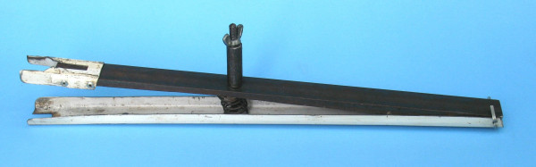

I believe the original Model T service manual demonstrates this style of compressor. However, the hook reaches up and grabs the top surface of the engine block, (or maybe hooks onto one of the head bolt holes), while the fork on the end of the lever arm goes under the valve spring washer. Simply push down on the lever and the spring goes up.

The hook goes over a manifold clamp and acts as a fulcrum for you to pry the bottom of the valve spring upwards.

Post by Jerry VanOoteghem » Fri Nov 13, 2020 9:23 am
valve tool.jpg (3.92 KiB) Viewed 3769 times
Not sure the Lang's design will hook on the manifold clamps. Looks like the hook sits too close to the fork to allow for the manifolds to be there. Maybe it's meant to hook on the studs instead, but I still think the manifolds need to be removed.

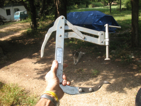

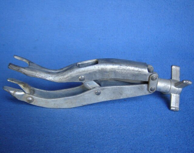

If using modern valves, keepers and collets, the scissor type lifters are a PITA. They cause the springs to cant sideways, angling the keeper and making it very difficult to place the collets. I have found a couple of different brands of old time lifters whose double jointed actions allow the forks to move in parallel to each other. Thus the spring is not distorted and the keeper remains central and the collets can be inserted easily. They are little treasures, and any time I see them available for purchase, they join my swap meet stocks of tools.
This home made one isn't bad.
This one is better. I found one online for $40 and passed. A few days later I went to an auction and bought this one for $2.

Post by Jerry VanOoteghem » Sun Nov 15, 2020 8:34 am
This is the style I like. The "dog-leg" design clears the hood shelf when the engine is still in the car.
