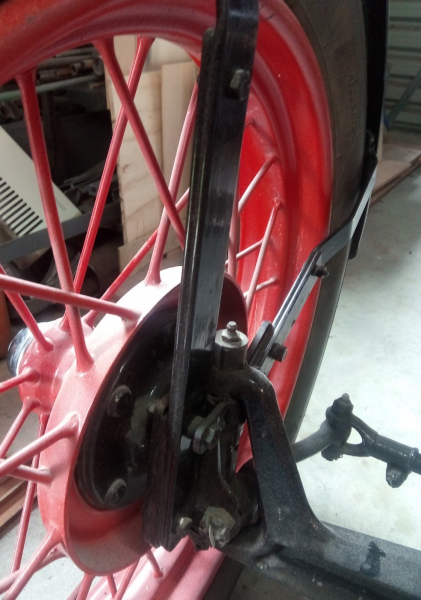

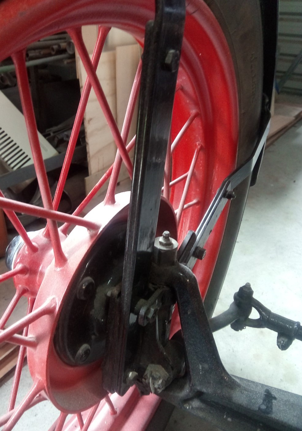

I am planning to install cycle guards (mud guards - or fenders in the US - that fit over the front wheels and move with the steering).

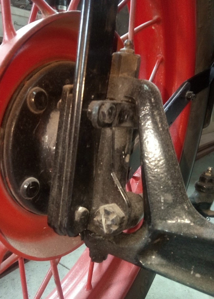

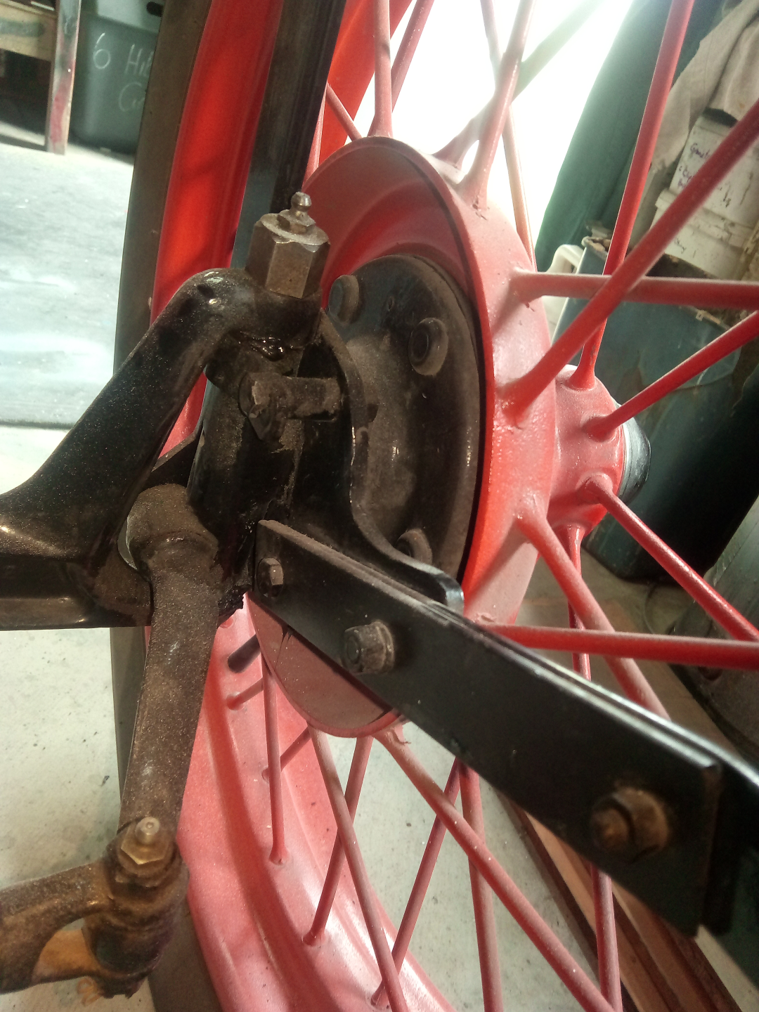

I am sure someone out there has done this before and I am interested to see how you fixed the brackets to the spindle.
Please share a picture or two as a picture is better than a 1000 words (or so I am told) :-)
Here is the set up I am looking at using. The owner used spring steel for the struts (formed and drilled before being annealed) and heavy gauge steel for the guards:

Looks like a decent design!
The other option I would consider is making a couple of new spindles that additionally would accommodate front brake backing plates. Yes I know it sounds like a lot of work, but I have done it and it wasn’t too bad. The fringe benefit was that I tilted the king pins in like a model A and it sure drives nice!!

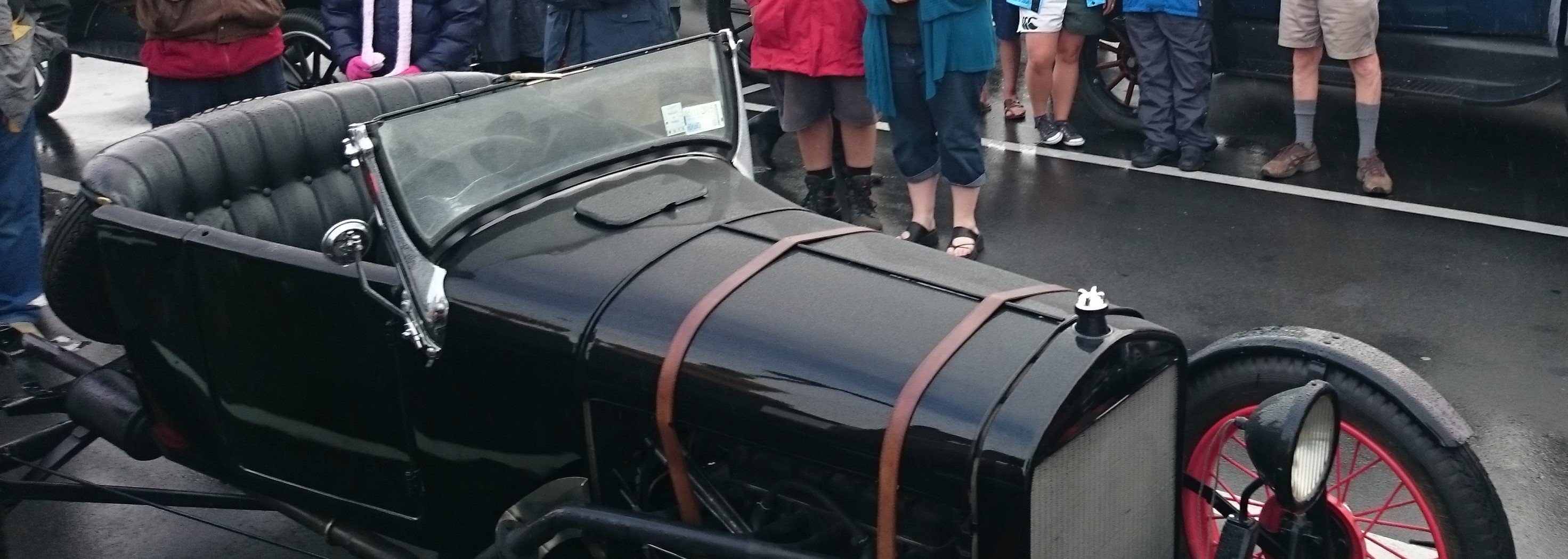

Looks good. Can we a see a photo of the whole car?
Posts: 1219
First Name: Adrian
Last Name: Whiteman
Re: Cycle Guards (Fenders)
Post by A Whiteman » Tue Nov 24, 2020 4:19 pm
Tucked in the garage at the moment, but here is a 'partial' picture. It is based on a 26 with the front cowl narrowed by about 6 inches. Gas tank behind the seat is in fact the tool box/ storage.
