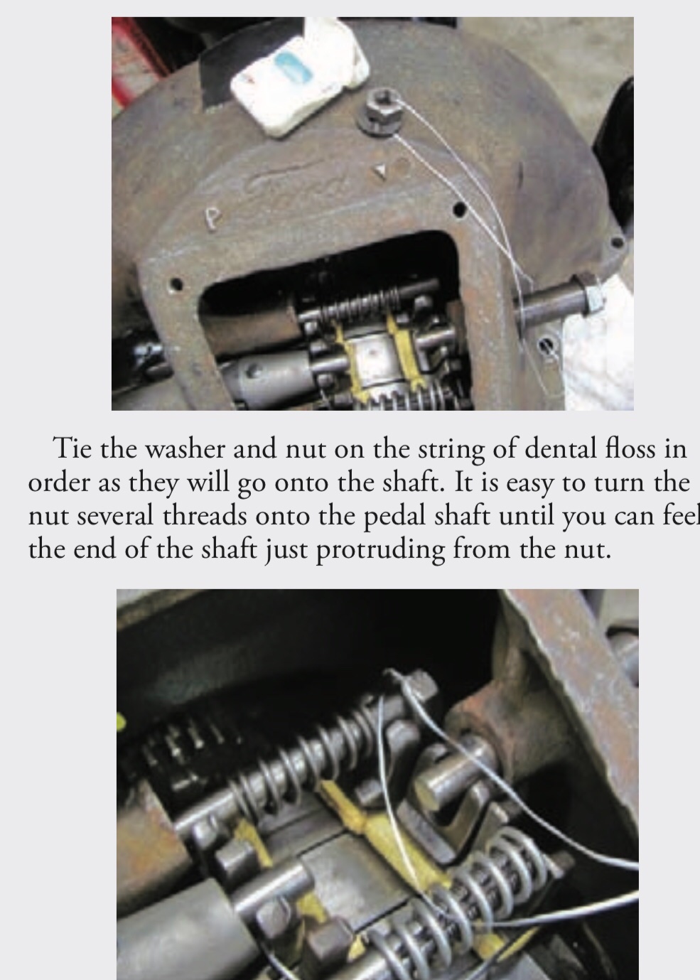

If you have the Ford service manual it gives you the general idea how to reinstall the transmission cover.
A detail not clearly mentioned is getting the gaskets in place. Before you start to install the cover use some silicone sealant to hold the transmission gaskets in place. You can also use some dental floss to hold the transmission bands together as you lower the cover down and get it in place.
Others will give advice but keeping the gaskets in place and using dental floss holding the bands together plays a big part in getting the cover down and in place.

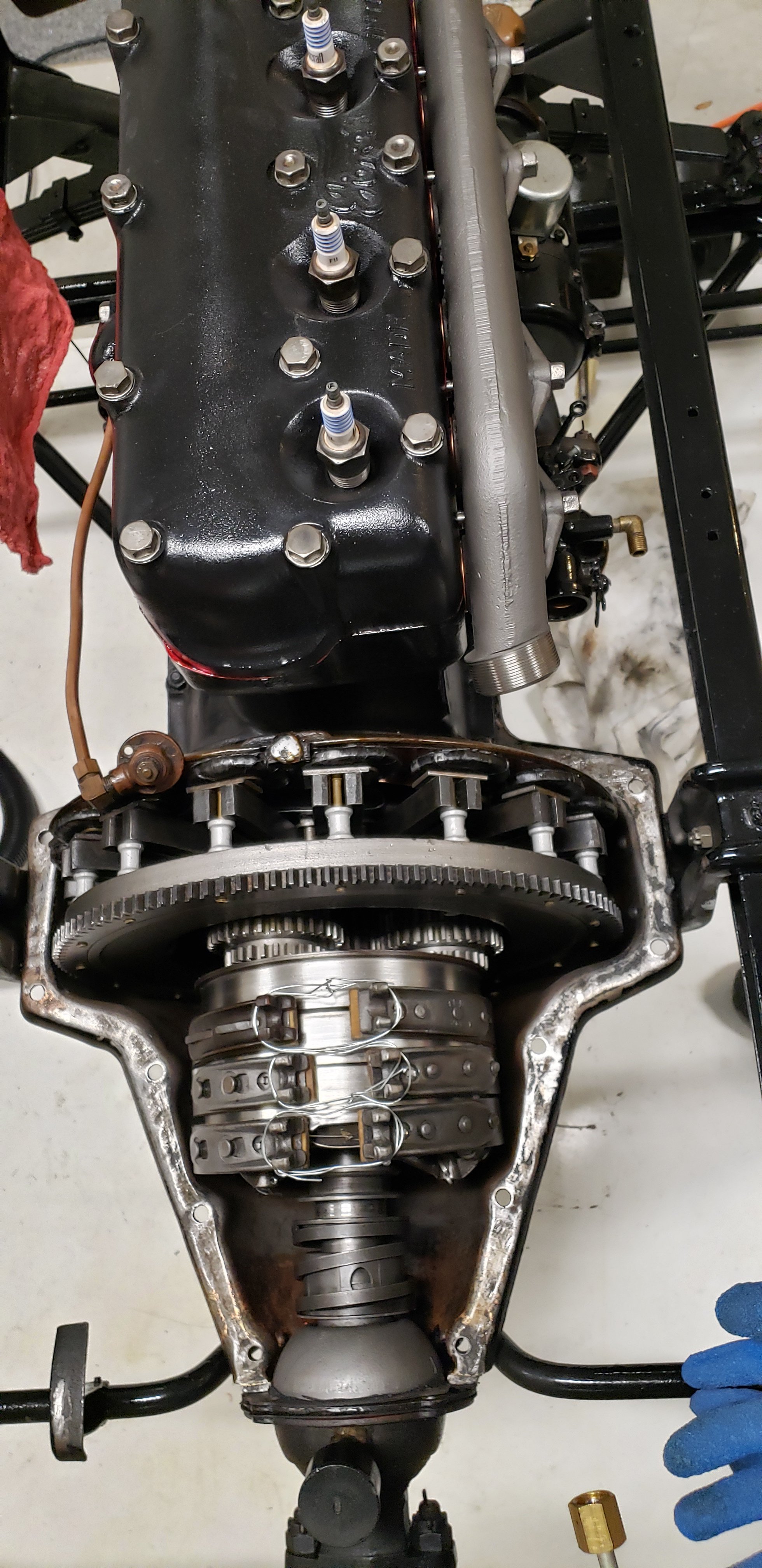

Re: Advice Needed to Install Trans Cover

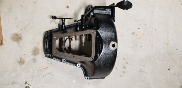

Sorry for not giving more details, please see attached photos. It is a 1924 Chassis with body off.[/size][/b]
Good. It is much easier to do it without the body in the way. On September 3, 2010 I posted in the attached thread, a procedure I used in installing my hogshead. Please see: www.mtfca.com/discus/messages/118802/121217.html. In a nutshell, it involves sealing one side of the gaskets at a time with RTV (I prefer “The Right Stuff”). The reason for sealing one side of a gasket at a time is, because, virtually all RTV gasket sealers begin to set up before the gaskets are all in place, which causes one to hurry through a process that should be deliberate and methodical and we all know when one is forced to hurry, mistakes are made, such as misaligned parts, shifting gaskets and ripped gaskets. In doing one side of the gaskets at a time, it gives you double the time to line up the gaskets and parts and to be more deliberate in taking your time in doIng the job right. This method can be used in assembling and applying gaskets to the entire engine. Of course, in assembling the hogshead to the pan, it is a slower process because after applying sealant to one side of the gasket, the parts being sealed must be bolted together and torqued and allowed to cure overnight and the next day, the parts separated and sealant applied to the remaining side and the parts bolt together for good, but it is worth it, because since the gasket is already aligned and unable to move, that is one less thing to worry about, especially because there are so many other things to do while aligning the hogshead, such as positioning the clutch fork and the three pedals onto the bands. It may be hard to believe, but, after 10 years, my T does not leak at all from the gasketed joints of my engine. To be fair, it does leak a very small amount from non gasketed areas, such as the three pedal bushings where the pedals enter the hogshead. Jim Patrick
With the body off, it should be quite easy. Lay the Gasket on the crankcase and seal it down with ultra black. Let the gasket sealer set up a while to keep the gasket in place. Put the felt seal around the back of the engine. It would be easier with the manifold off. Remove the two bolts at the rear of the universal joint ball and slide the retainer back. You should be able to lower the cover right down. It helps with two people as one can lower the cover while the other aligns the bands and the clutch release half ring into the groove. When you get the cover all the way down and everything in place, install the bolts. tighten them gradually working from the ends to the front and back. Be very careful of the bolt at the front which is next to the engine. It is very easy to snap off the corner of the hogs head if that bolt binds, however, it needs to be tight to compress the felt seal. Next if the gasket at the u joint is bad, you can carefully cut another so it can be placed without pulling out the U joint. put some extra sealer at the area of the cut. Less likely to leak if the cut is at the top. When you put the springs, washers and nuts on the pedal shafts, be sure to have shop towels or rags all around the area so in case you should accidently drop something it will be easy to retrieve. Cut the strings which were used to tie the ends of the bands together and remove.

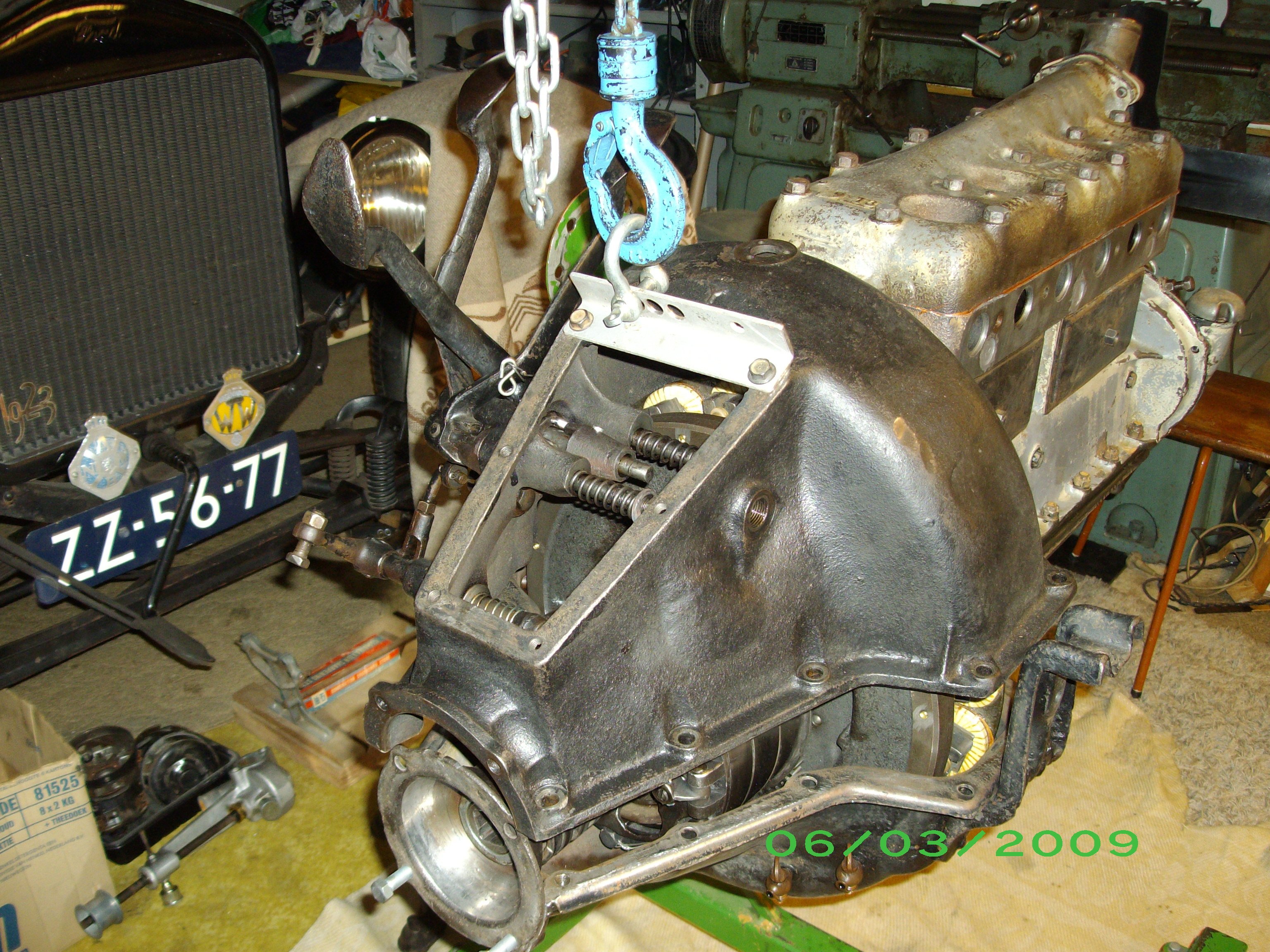

Daniel ; I use a Hoist to help me .
Toon .

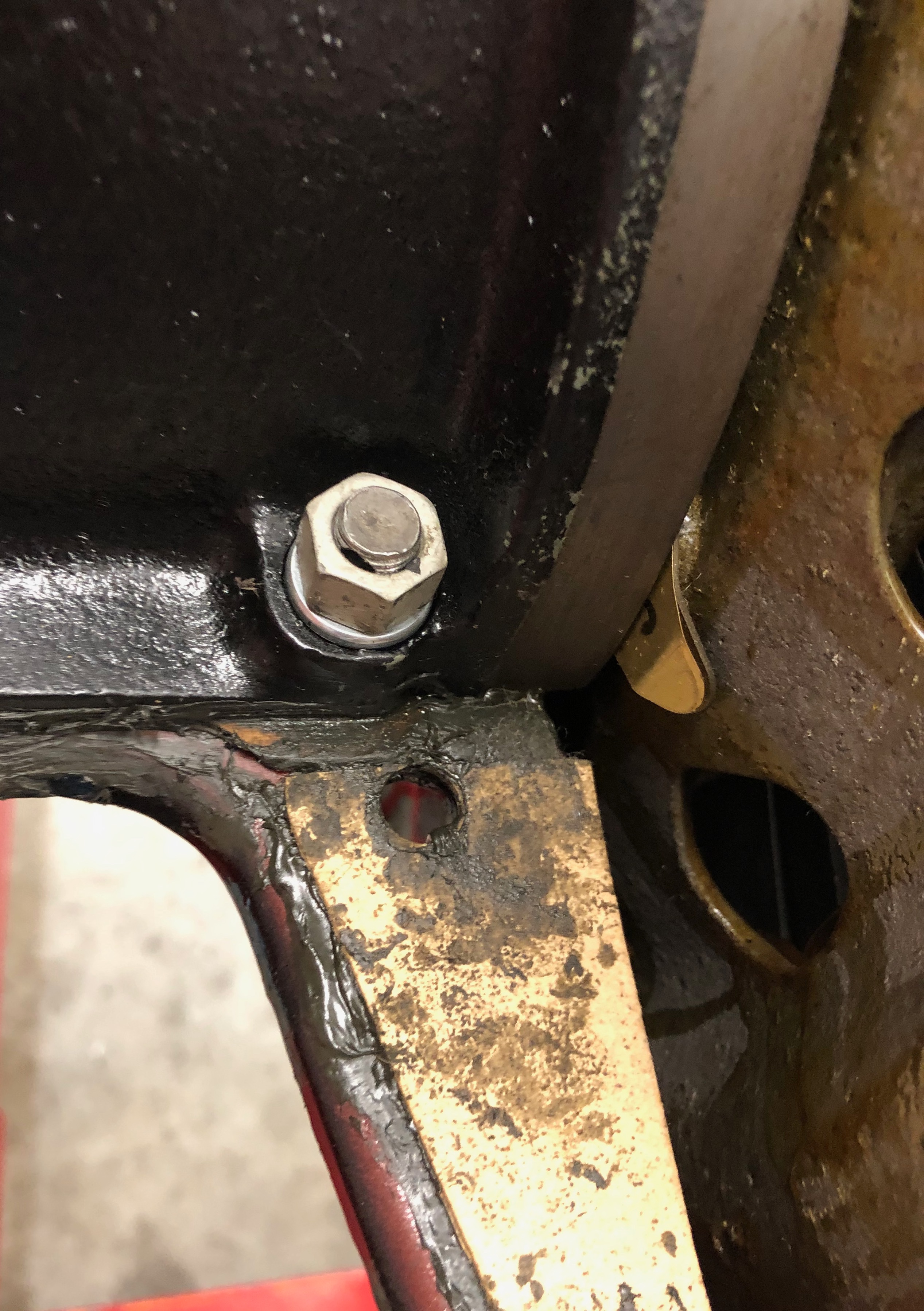

Thank you Steve. I have a ‘26. I guess on a ‘24, the best way to align the rear of the hogshead with the rear of the pan is to install the fourth bearing ball cap and bolt it in place before tightening the hogshead to the pan. Jim Patrick

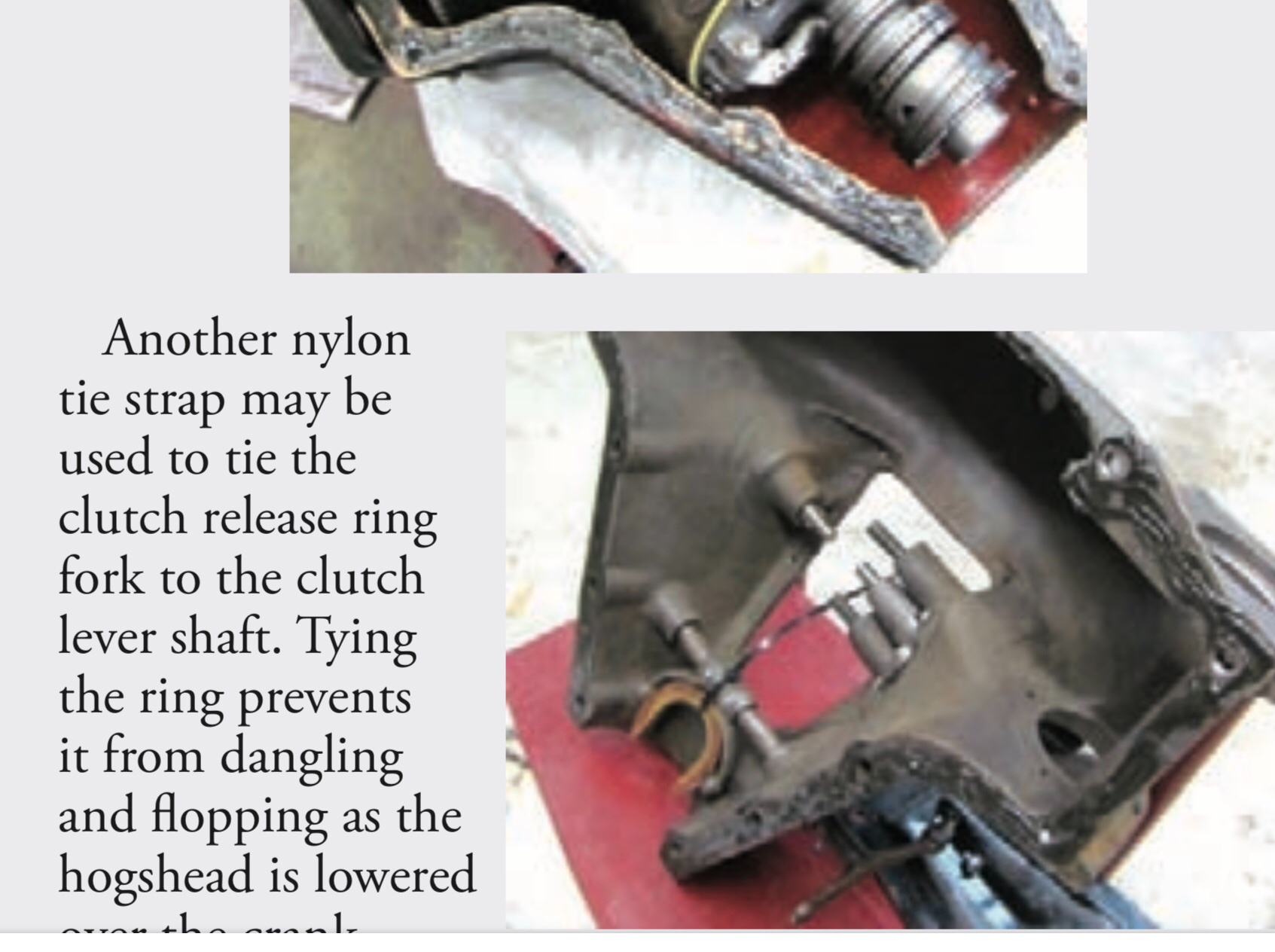

Large nylon wire ties, hold the band ears, and for me, the clutch fork is held by one too. Keeps the fork from wiggling, and you can direct it in place holding outboard on the clutch lever, one hand there, the other hand just inside the inspection port to lower the cast iron hogs head. IMO, Permatex #2 always works to seal, don’t like messy and sticky fast set RTV, time is necessary for the multiple steps needed to lower, align, fit band fasteners when doing this by yourself, even with practice it isn’t a fast install. Sticky, stringy RTV dries too fast for me. Plus those peeling off shards of dried RTV can find their way into the engine.
Note. In the step below, the pedals were added after hogshead drop.....but prior to any pan to hogshead fasteners. The nylon ties are still in place to keep the band ears together, for getting the springs in place as you wiggle the pedal shafts in. Then add the band washers and nuts, but don’t tighten yet.
Finally cut and pull out the nylon ties, then push the hogshead down tight, and then begin the process of placing all the bolts to fasten up. Hint: Put the inspection cover on temporary NOW. That open hole can swallow a pan bolt nut or lock washer, don’t ask how I know

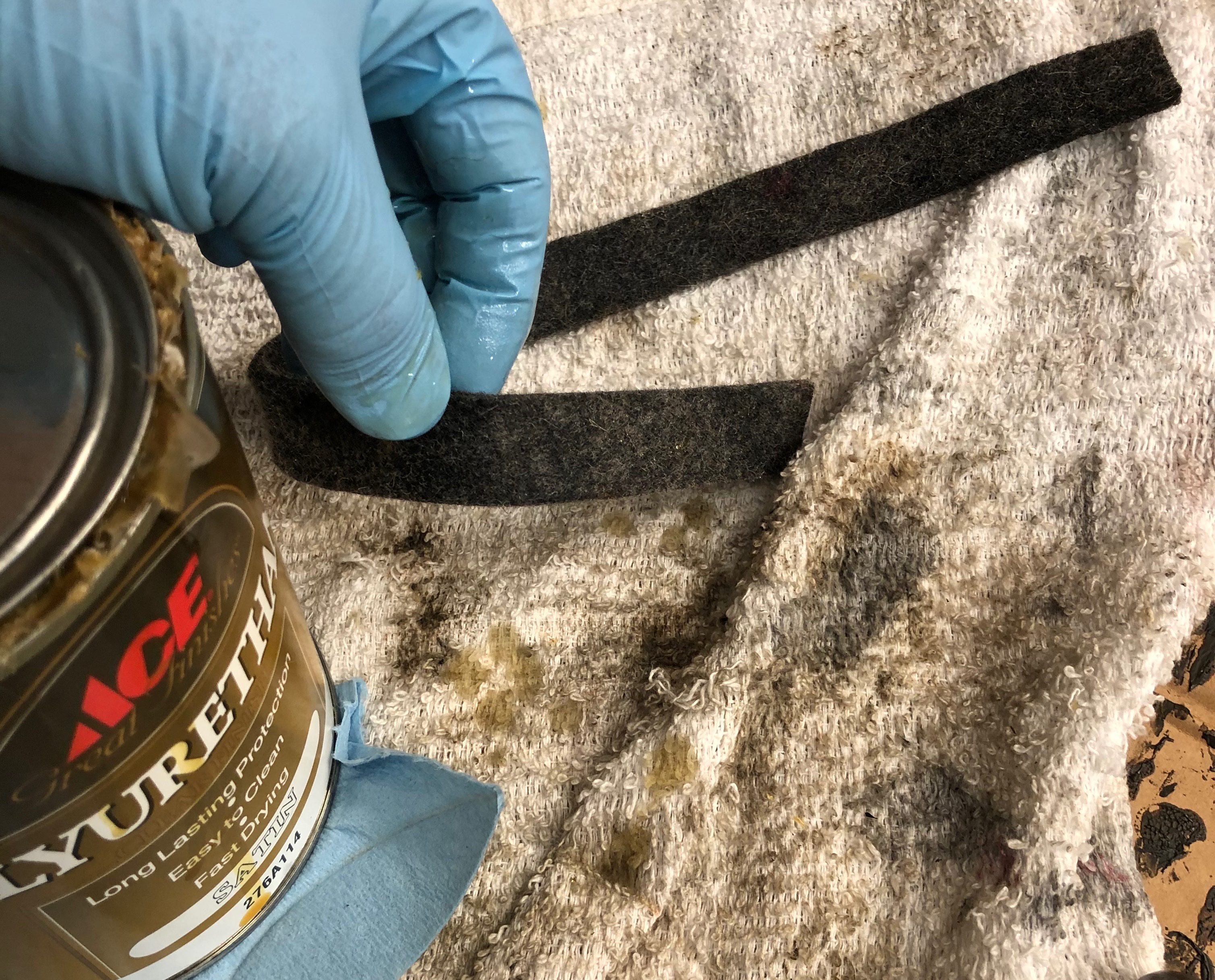

Haven't had issues with any repro felts over the years. But all felt gaskets in the T shouldn't be fitted dry. Either rub in grease or oil to fit.
Use old school method, dip the hogshead felt for a total soak in a can of varnish, and squish the excess, flattening the felt.
Then add bead of favorite gasket sealer to the metal parts, the hump over the block, and the curve of the hogshead.
When the hogshead is set in place, the varnish in the felt strip will set and dry in the felt creating a real nice seal from any oil seepage. Fitting the paper gaskets from pan and block carefully, so they touch and leave no gap.
Of course this Three-Way Corner of the block, pan, and hogshead needs a spot of good stuff. That important place deserves a tooth brush size dab of Ultra Black Gasket Maker, the only place for me to put RTV on or around the engine.
Ford Manual says to put a candle wick there, but good stuff is better than wax!
