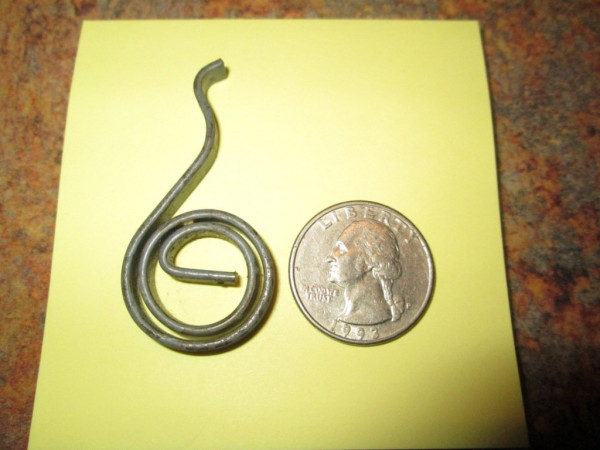

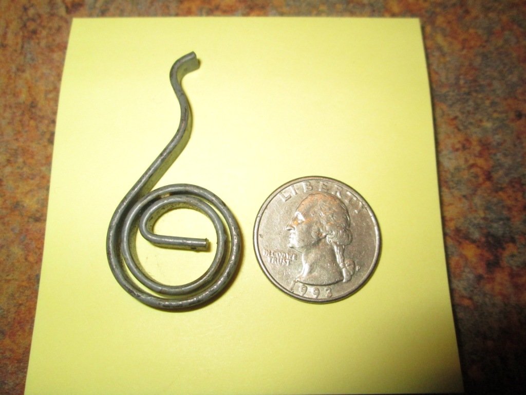

"Early" car's latch springs are flat, round wound unlike a conventional spring.

This is the new spring I replaced the broken one with in our '14 Touring - I believe the '15 latch to use a similar one.

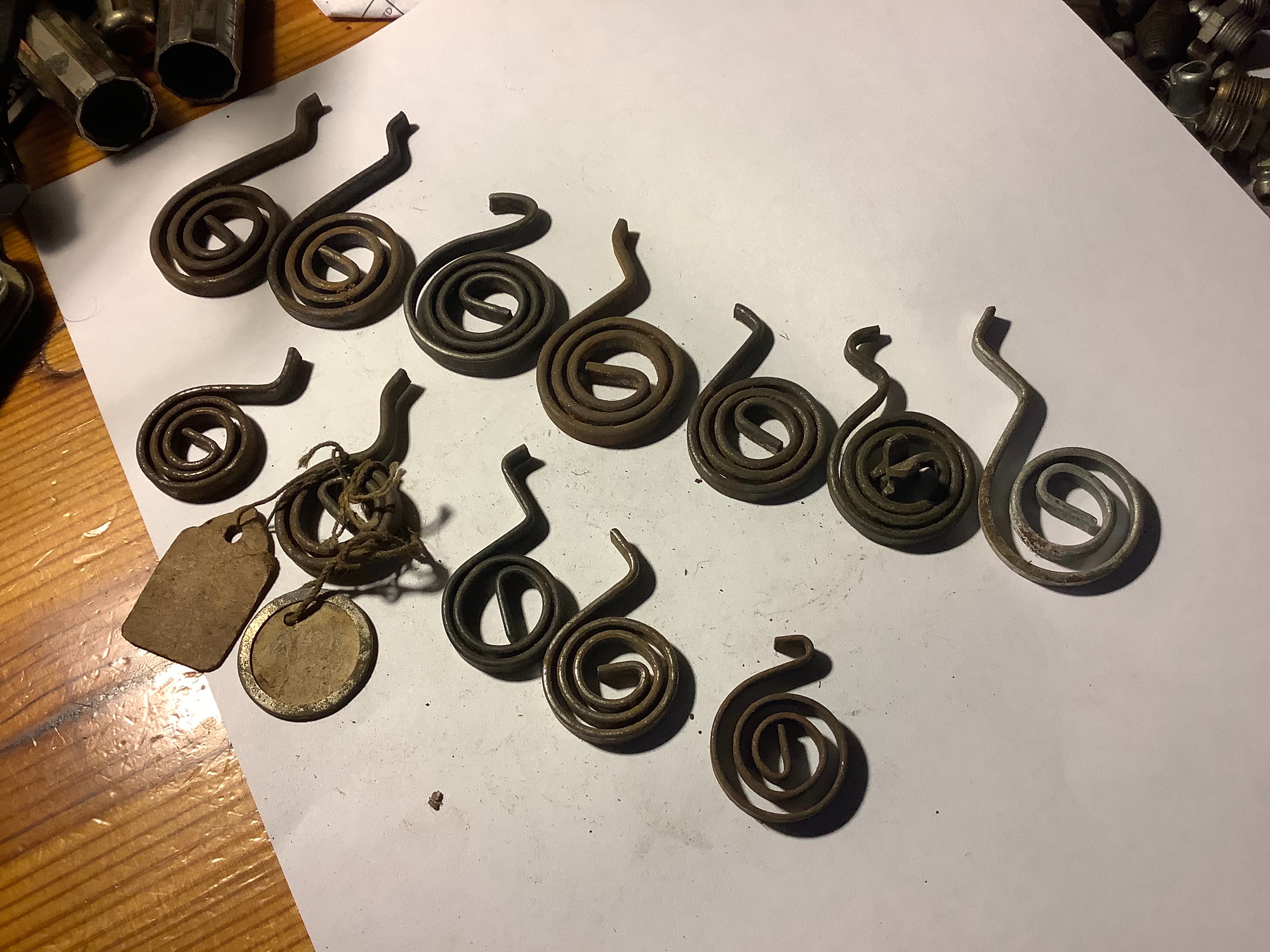

Looks like I can maybe help. As you can see, lots of variations. Tmorsher@icloud.com to reach me.

I discovered the gentlemen who made the door latches for my year car and he kindly told me two different ways to make the spring. Also, if I couldn't make it he would make it for me if I sent him the latch. His description of how to source the right material and how to make it was more than sufficient for me to get the material and make the spring. The spring I made using his directions works great. Thanks for the help.
