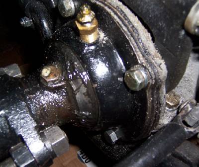

Or, just remove the large cup on the U-joint, add pipe fitting for Zerk. Also you can remove the little cup on the driveshaft bushing and put a Zerk instead. Holes for the dope cups are tapered pipe threads.
Grease at uninv joint.jpg (62.69 KiB) Viewed 5465 times
If its oozing grease, you know it is lubed ;)

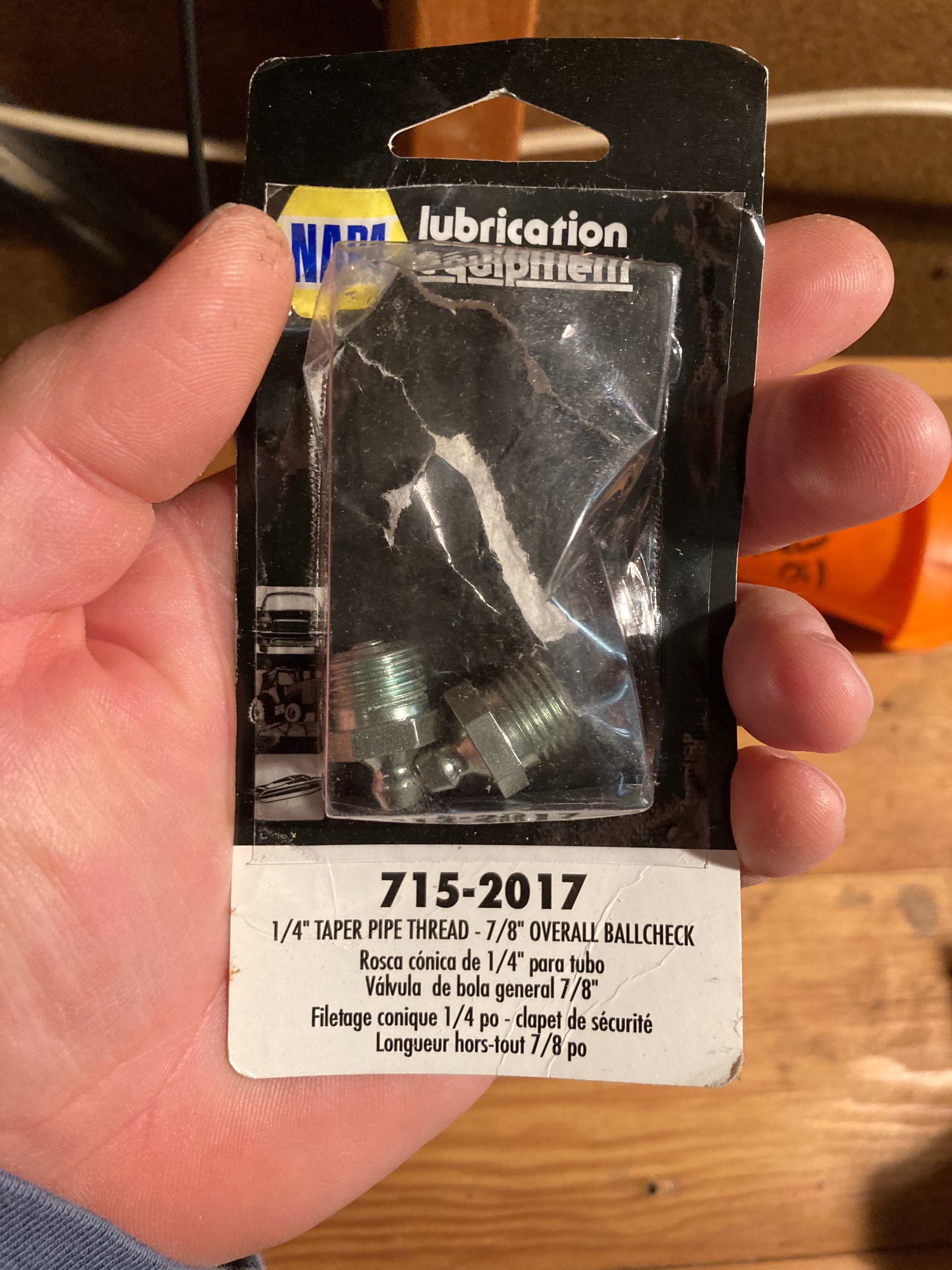

I simply remove the grease cup, install the zerk, grease and then reinstall the cup.
It takes very little effort and that way everything remains stock.
Here’s the zerk that you need.

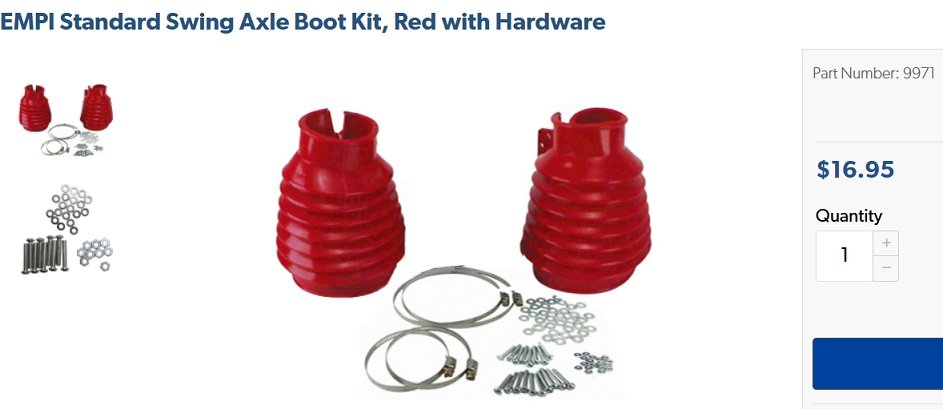

Several posting advise not using any grease that may contain an additive that conducts electricity per chance it leaks through the 4th main into your oil and ruins the magneto. So no Molybdenum , zinc etc based grease. A water resistant/proof #2 grease seams to be the most common type used for the u-joint an ball cap. Note that the leakage is necessary to lubricate the ball end on the torque tube (drive shaft tube) and the ball cap. Someone suggested adapting a CV boot like on a VW to catch the spillover. The boot is split and closed with with small bolts

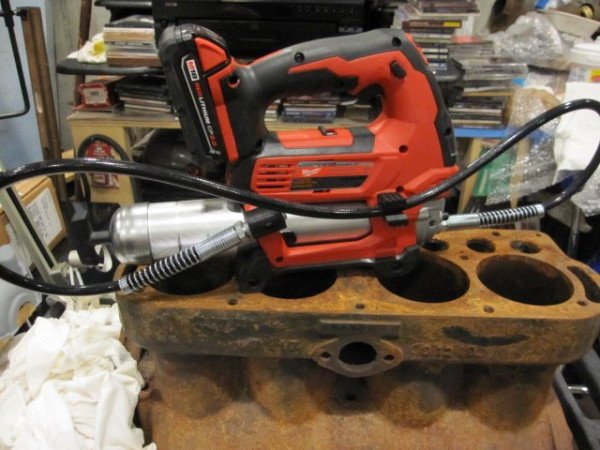

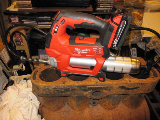

This will help to easily fill those zerks and ease the pain of Arthur Itis :lol: If you have not yet, try Relief Factor.

Nu2theT .... man ... THAT beast would GIVE me Aurthor itis! ;-)
