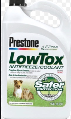

Alcohol works, but evaporates fast so freeze protection is limited.
And your pets could get drunk or injured as denatured alcohol is poison from those leaks too :(
Better to keep pets away from the storage garage, oil, gas, other things are harmful too.

Post by DanTreace » Mon Nov 16, 2020 1:02 pm
Since we don't have pets......never knew this product was out there :o

I was not familiar with the product that Dan Treace posted but I have been using Sierra antifreeze. It is a propylene glycol based antifreeze and is safe for pets. That is probably what the other product is as well.

Jonah, (and Steve), I have used the LowTox antifreeze in the past, trouble is, it's pretty darned expensive, so if it's just
gonna leak out, take the other guys advice and when it's gonna get cold and you're just using good ol plain water, take the 5 minutes and just drain it. Then, when you get time and money, maybe send the radiator in to a shop to get it fixed. I bet for less than $300 you can get it taken care of. Maybe even a re-core, which will cost a bit more, but certainly a lot less than the average $900 for a black radiator. I spent $140 a month ago and had my Fordor's rad repaired and boiled out and wow it works now like it was brand new, not bad for an original round tube radiator!
BTW...at the risk of ticking off suggestions for "stop leak" stuff...DON'T. You'll hear plenty of horror stories as to how it surely stopped the leaks, but also stopped the COOLING along with it! It tends to plug up more than just the leaks. Do it right, fix or replace! You know the acronym... F-O-x-x! I won't fill in all the letters! Ha ha.

The first "antifreeze" was Glycerol (glycerine is the commercial 95% form of glycerol used in hand sanitizers etc) was replaced with a cheaper solution Ethylene Glycol about the late '20s https://en.wikipedia.org/wiki/Glycerol
In the food industry it is called propylene glycol and used as an antifreeze because of its low toxicity. There are several products available for automotive use like the one described above, Prestone's LowTox.
Explanation of the difference between propylene glycol and ethylene glycol
https://www.monarchchemicals.co.uk/Info ... antifreeze
NOTE: Besides the issue with evaporation, Denatured Alcohol is poisonous: denatured alcohol is sometimes consumed as a surrogate alcohol. This can result in blindness or death if it contains methanol. https://en.wikipedia.org/wiki/Denatured_alcohol

The radiator in my Ten is tight, but will drip a bit, so I use the "safe for pets tpye' Alchohol I reserve for my personal use.

The RV dealers sell a non-toxic antifreeze that is used to winterize RV's. Boats use this too. See https://www.campingworld.com/star-brite ... antifreeze
