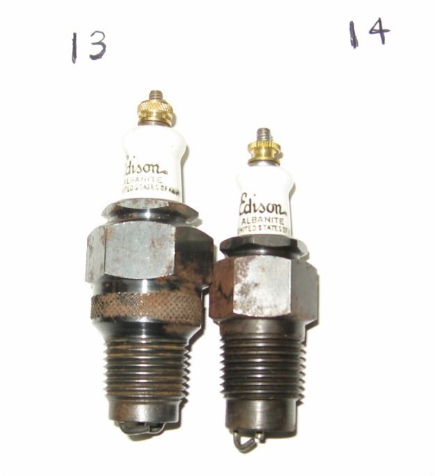

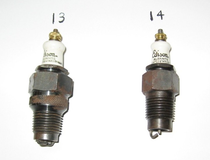

I like Edison 14s, but they are hard to find. Edison 13s will also work but are even harder to find and have dual ground electrodes if you prefer that feature.

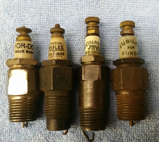

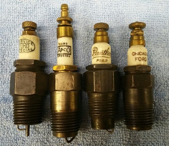

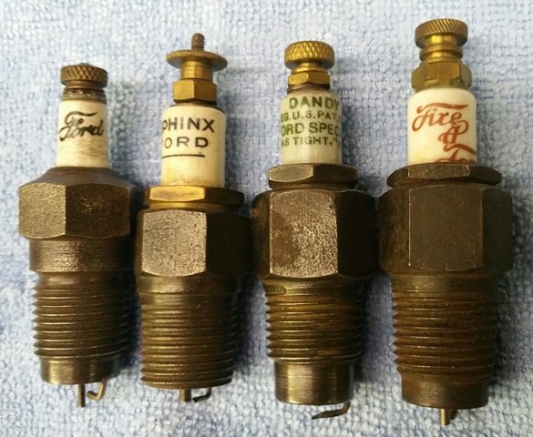

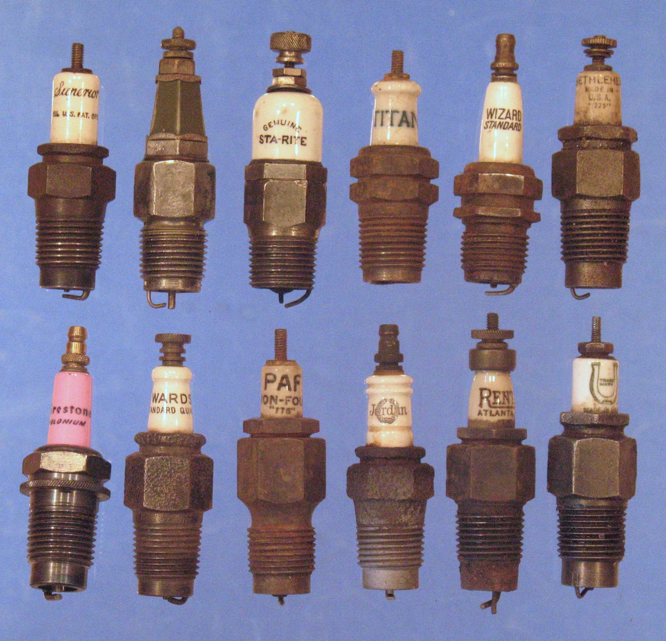

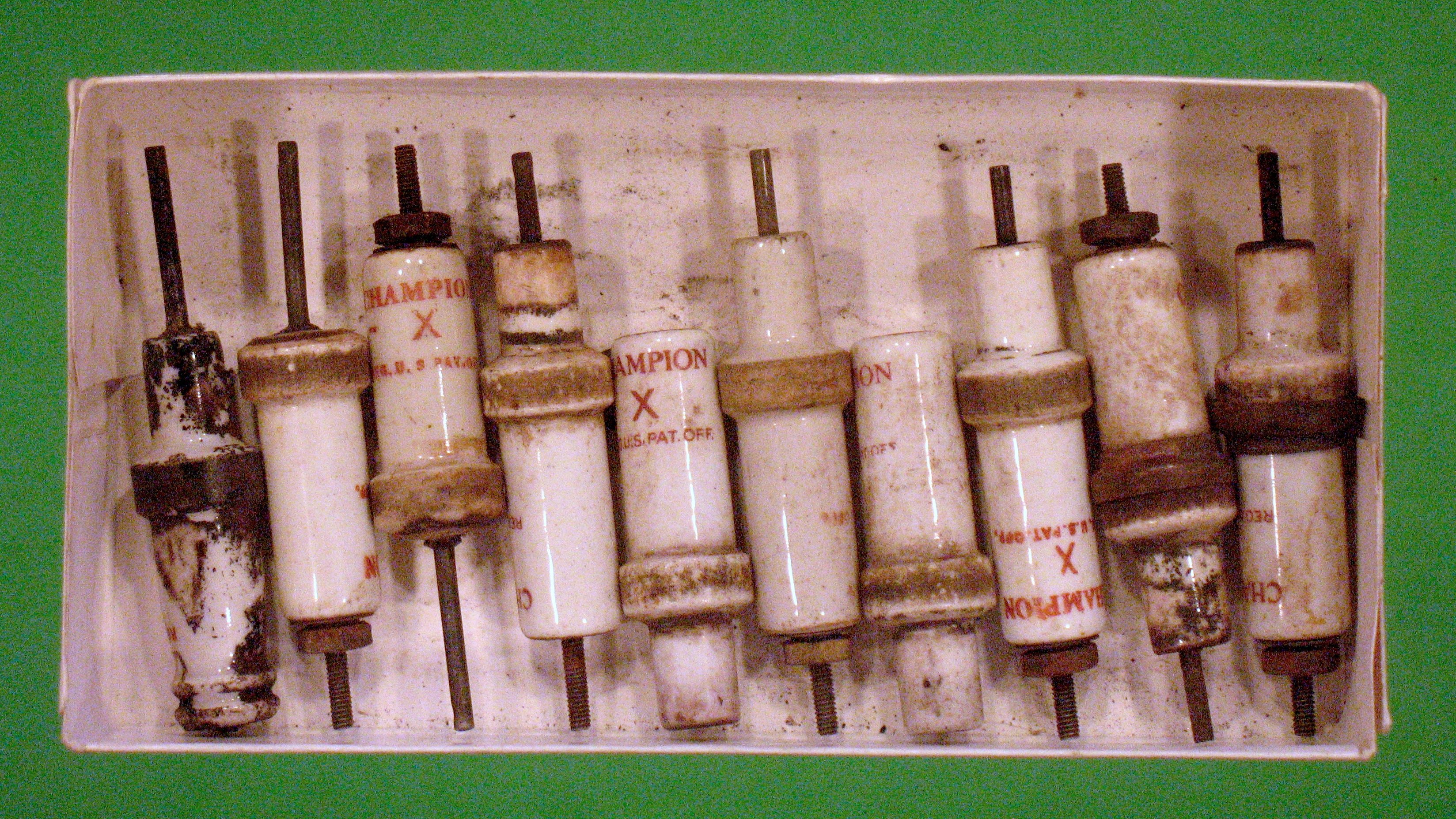

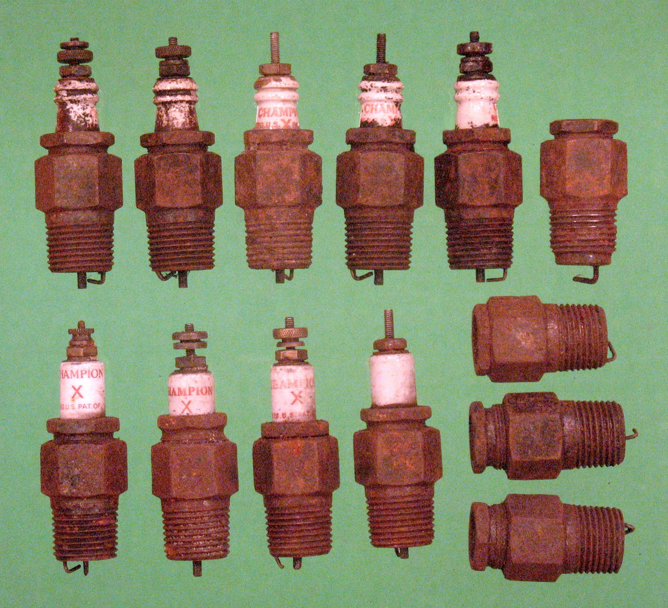

Re: What 1/2 inch Pipe Thread Spark Plugs Work in a Model T ?

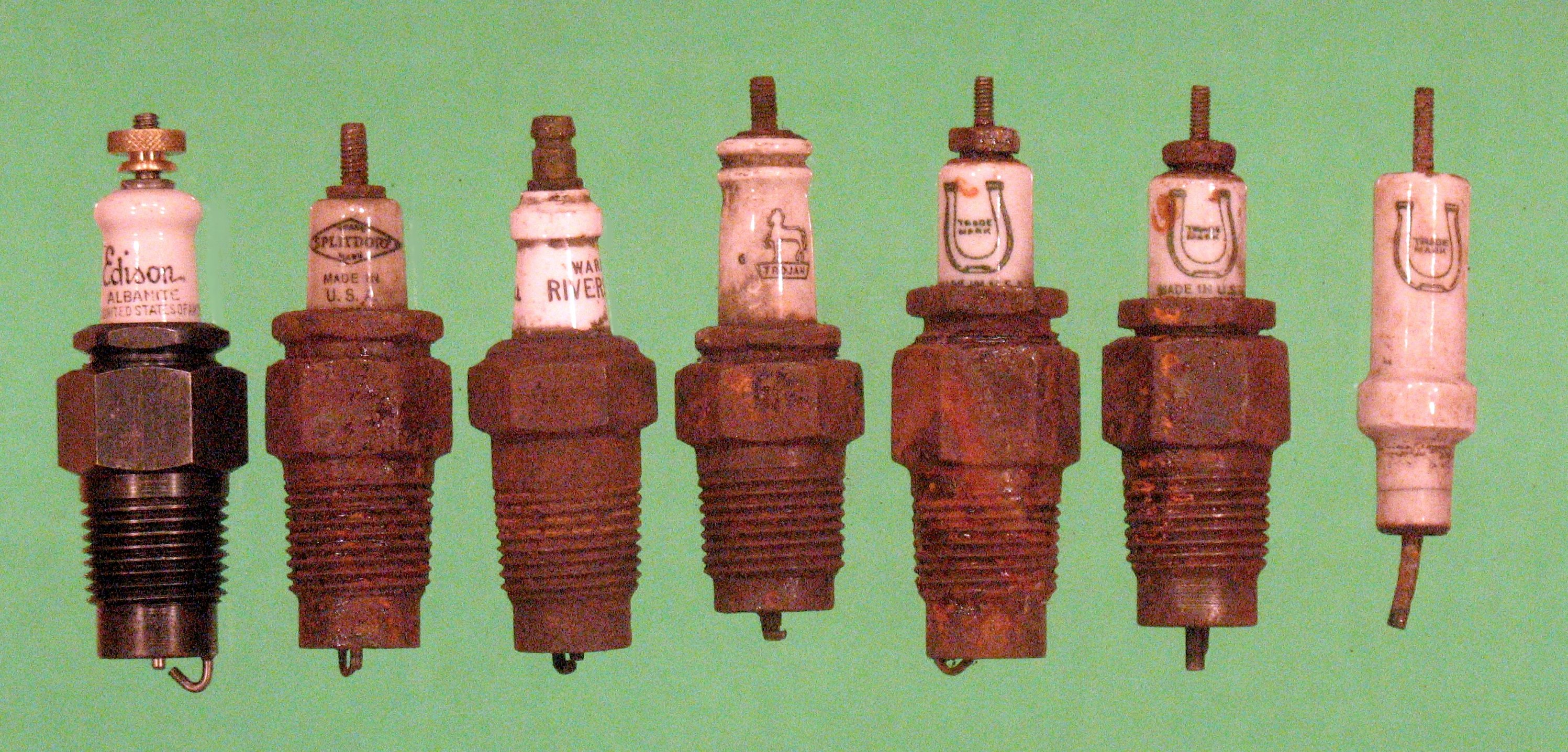

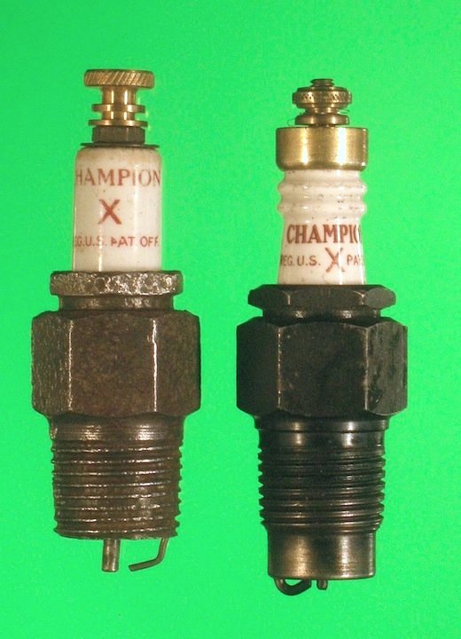

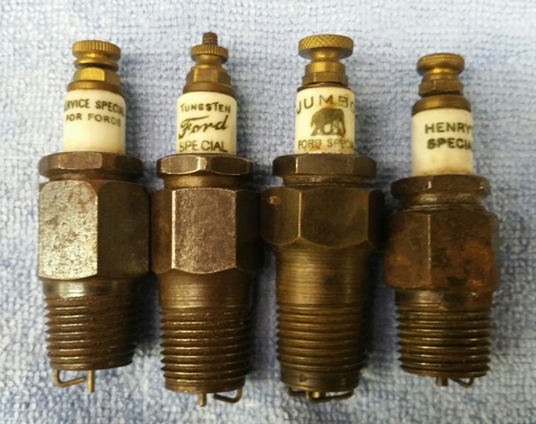

I've collected old spark plugs for over 40 years and probably 75% of them in my collection are 1/2" pipe thread. It was the most commonly available thread style used in the early days. That thread pattern fit the vast majority of early automobiles. The other popular thread type was 7/8." I'd venture a guess that any one of the over 4000 different plugs manufactured over the years, in 1/2" pipe thread would fit and work in a Model T. (work WELL is another matter however). There were a lot of automobile accessory manufacturers who sold plugs made for use in Model T Fords, and some even have the unauthorized use of the "Ford" name on them. While there are a lot of plugs that would fit/work in a T, the best recommendations seems to he Champion X, Edison, and Firestone. I've heard some of the one-piece plugs made by Autolite and Motorcraft are not as good, but I don't know from personal experience. The Champion X is what I've always used and have had no issues.
Terry
Terry
- Attachments
- Ford 5.jpg (78.38 KiB) Viewed 4427 times
- Ford 3.jpg (69.86 KiB) Viewed 4427 times
- Ford 2.jpg (72.34 KiB) Viewed 4427 times
- Ford 1.jpg (76.09 KiB) Viewed 4427 times

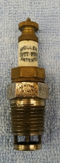

More history on plugs for t he Model T https://modeltfordfix.com/model-t-spark ... nthusiast/
Lots of additional pictures of plugs. Ends with ". A good rule of thumb is to tighten them finger tight (no wrench) then using a wrench tighten an additional one half turn. This is not very tight, and that is what you want.
I see soot escaping around the threads? What should I do? This is not a problem, but it alarms some folks. What you can do is use a conductive anti seize product. Some common brands are Nickle – Eze, KW Copper Coat, and C5A Copper Anti Seize. Again be certain that you don’t over tighten the plugs.

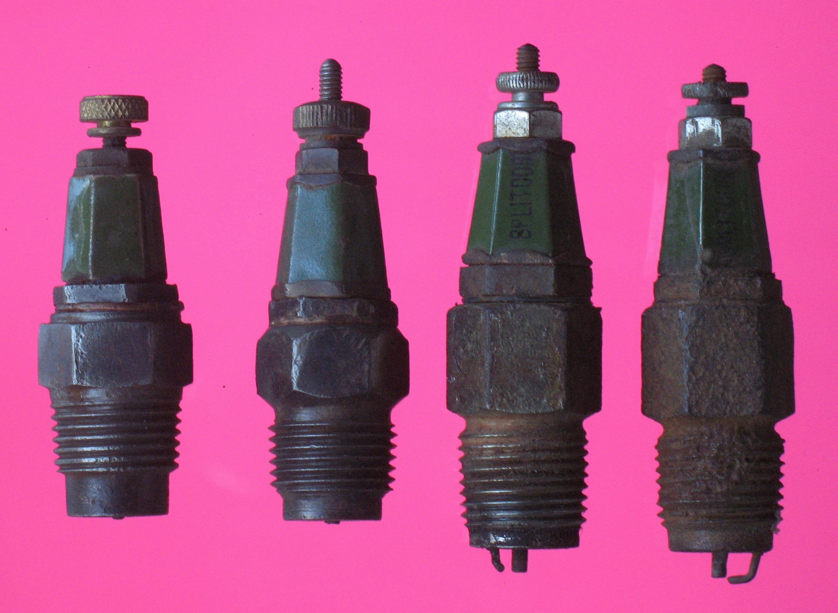

- Posts: 7413

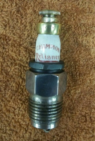

Here are a few more ½" NPT spark plugs.
Champion X plugs found at Hershey. I believe I paid $2 each for these. Most are quite restoreable and usable.
Cores found at Hershey. Most of these too are usable and only need cleaning.
More ½" NPT plugs from Hershey. Some will be OK to use, and some will be for parts.
I agree with Royce on the Splitdorf green plugs. They look neat and are usually no good.
Terry, wasn't the 7/8-18 plug thread referred to as the "ALAM thread"? Seems to me I heard that somewhere but I'm no spark plug historian.
Terry_007
- Posts: 280
- Joined: Sun Jan 06, 2019 9:18 pm
- First Name: Terry
- Last Name: Bond
- * REQUIRED* Type and Year of Model Ts owned: 1914 Touring, 1915 Chassis
- Location: Chesapeake VA
Correct on the thread - ALAM.
Lots of info has found its way to the forum on the history of plugs over time, and there are always a few things that are not quite correct or are "moving targets". I can't recall the specifics, but I do believe there exists somewhere, a letter or order from Ford to Mosler to purchase plugs. These are either pre T or very early T. Years ago when I was editor of the Spark Plug Collectors of America newsletter I had a lot of info close at hand but the source of that info isn't something I can specifically cite now- however, I do have this plug in my collection - it's the very early style of Mosler stamped on the steel body "Ford Motor Company."
The Mosler plugs referenced in the Ford Fix article and shown in photos on that site are much later and were not the type that would have been supplied to Ford for factory installation in the earliest (pre 1911) Ts. The Mosler's shown as a set of four in boxes were produced in the later teens/twenties. Like most plugs with either an unauthorized "Ford" on the insulator or marked on the box as for use in the Model T, they are aftermarket accessory items sold for use in the T, but not supplied by the factory. All those in my previously supplied photos fall into that category except one that I'll discuss later.
The straight sided Champion X appears to be the plug supplied for Ts since 1911. Trying to pin a start and finish date, or even to try and determine which of the X plugs were used when would be an impossible task. For those X plugs, there were many variations in styles of printing, exact shading of the red, or whether there is a patent date of even "made in USA" marked on them. I'm sure there were also other types of plugs that continued to be installed until stocks ran out, once the Champion X began to be installed at the factory.
It wasn't until late 20's that the Bethleham plugs somehow became associated with Ford, and most of those seem to have been sold as replacement plugs through dealers or repair garages. I don't recall seeing evidence they were actually factory installed in Ts. Any information on this would certainly be welcomed and I'm sure would be published in our Spark Plug newsletter, "The Ignitor."
Like a lot of other things about the Model T - this is an area with loads of conjecture, speculation and guessing. But, we do know the later Champion X plugs with the "brass hat" were the result of Champion's purchase of the Jeffrey DeWitt Spark Plug company. Champion acquired that company during the 1915/16 time frame in order to obtain mineral rights to deposits of Sillimanite, which was used to produce an absolutely superior insulating material. The J-D spark plug company had been around since 1906. Champion adopted their "brass hat" type of plug following acquisition. The "Brass Hat" was used on a J-D plug branded as "the Reliance." Attached also is a photo of a "transition" plug where Champion obviously continued to use the Reliance name for a brief time before dropping it in favor of just Champion. Although straight sided Champion X plugs continued to be manufactured and sold (even long after the T ceased production), technically, the brass-hat style of Champion branded plug did not exist prior to the J-D acquisition.
A thorough survey of Champion advertising and catalogs would help determine when the brass hat was finally eliminated, but I believe such plugs might even be later replacement rather than factory correct for the T.
From my earlier photos the Third picture shows a one piece Ford script plug on the left. I have no idea what the source of information is but I was told by another long-time collector, a limited number of these were produced as ford began to experiment with manufacturing their own plugs. I've seen a few of them around but none seem to exist in boxes, and there doesn't appear to be any advertising for them that we've uncovered. Plugs were one of several things that ford procured from other suppliers and it's certainly probably there would have been an interest in controlling that by making them in-house. That's the story anyway - if anyone can provide more info, let it flow.
Terry
Terry
