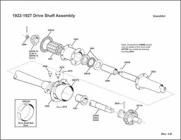

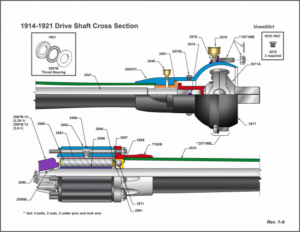

Here are a couple of Martyn's details. The drive shaft housing may not fit onto the open spool without modification.

As mentioned above get the housings straightened. Even the late ones bend. In the illustration above it shows a gasket between the D.S. roller bearing spool and the rear end. I don't believe Ford ever offered a gasket for that application.
