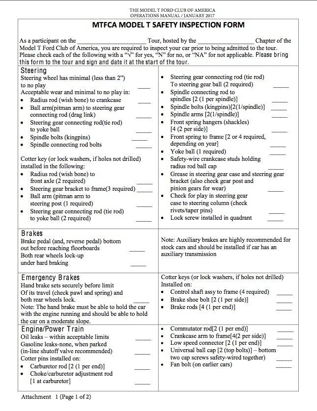

Post by Steve Jelf » Fri Nov 20, 2020 4:21 pm
I agree with all the advice so far. I gather you have studied the years enough to know you want a 1923. If you're not thoroughly familiar with that year's distinguishing features, study some more. It's very common for these cars to be titled and registered with the wrong model year. That's usually an innocent mistake. People misremember what they're told or get otherwise confused, or don't understand the difference between model year and calendar year. I bought a "1922" TT that turned out to be a 1924. My 1923 touring was sold to me as a 1922. The next time I bought a T I had studied enough to know that it was really the year advertised.
Another check you can make is whether the steering is tight or needs a lot of TLC. If you jack the front end off the ground, grab a wheel and shake, do all the components flop around? Is there 2" or less steering wheel play, a lot less, or a little more, or a lot more?
You won't use everything here, but some of the things on the club safety checklists would be good to check.

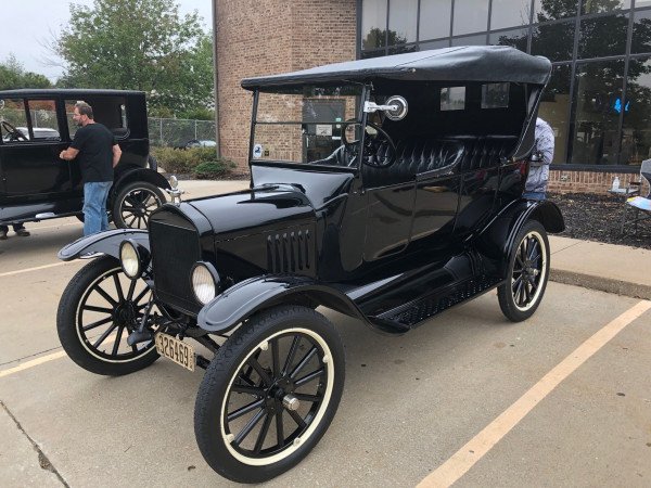

This is a great looking car. I would buy it for $10K without hesitation. The heavy lifting is done.
jwilliams81
Posts: 59
Joined: Tue Mar 19, 2019 11:35 am
First Name: Jarrod
Last Name: Williams
Big2bird,
Are you saying that car is for sale?
I agree it looks gorgeous and would be interested if for sale.

Steve,
Thanks for the safety sheets! That will surely help when I find one I like enough to inspect.
Big2bird,
I doubt it. I just used that picture as an example.

WOAH, Woah, woah!!!! That's my car "Gracie" pictured above and although I'm flattered you think she's righteous, (I do too) she's not for sale and certainly not for $10k. Unfortunately while driving it in October she joined the "Two Piece Crank Shaft" club. Luckily, I was going slow enough no residual damage occurred. Right now the engine is in the hands of none other than Mike Bender who is doing a top to bottom overhaul. We should be back in business early summer. Thanks!!!

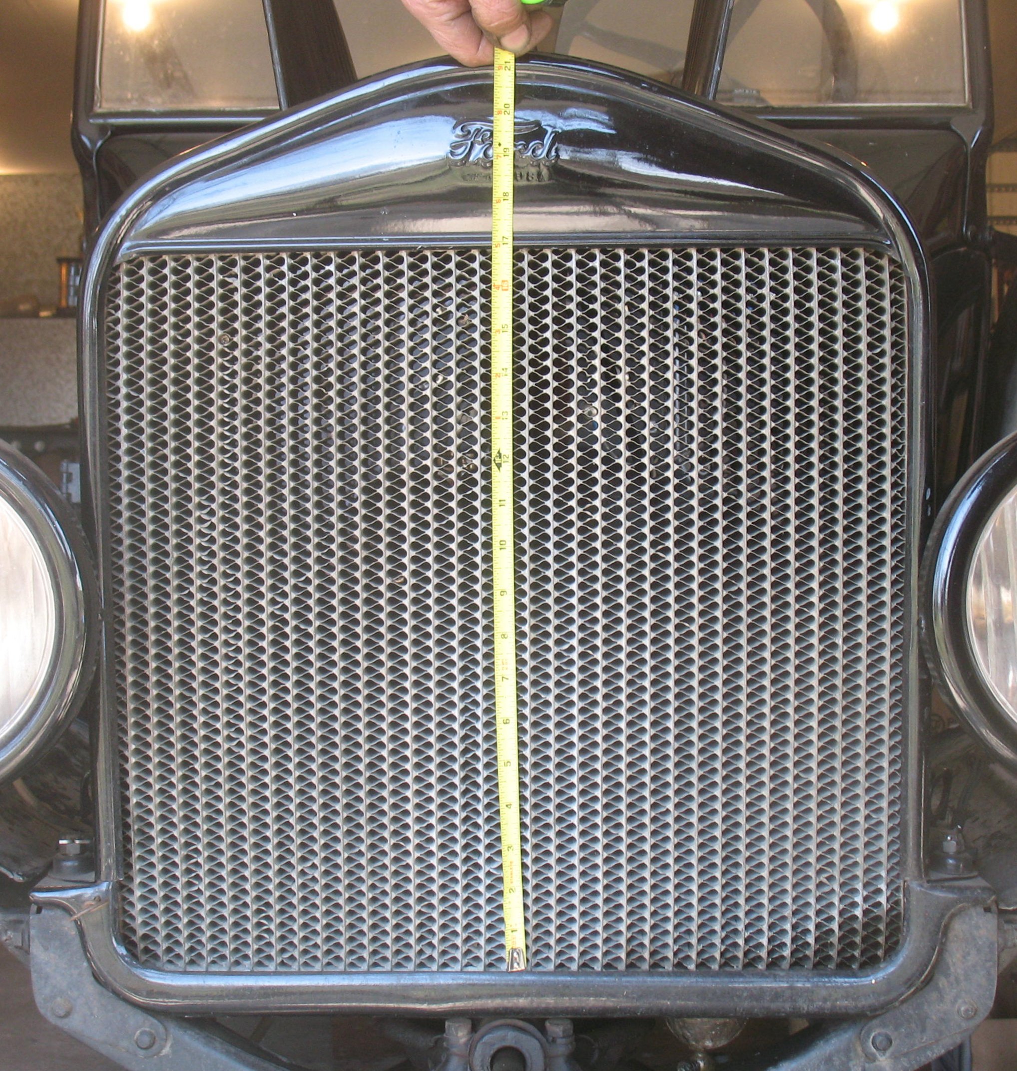

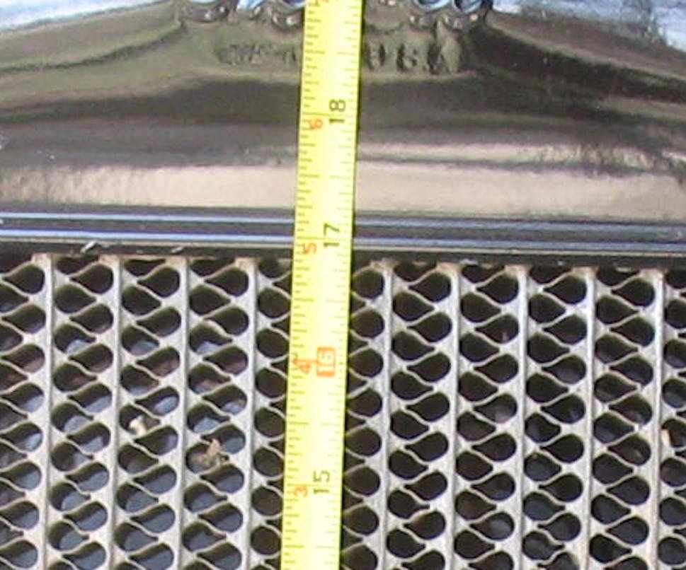

Understand the difference between ‘Model year’ and ‘calendar year’. As Steve touched upon earlier; you might come across a T made in the Fall of 1922 and titled as a ‘22 but should have the ‘23 model year features (1 man top, low radiator and slanted to the rear windshield.) Similarly, someone might present you with a T built in the Fall of ‘23 and titled a ‘23 but with Model year ‘24-‘25 features (high radiator, longer Cowl and radiator apron with a crank hole.)

Mr. Dow,
The Woah is right, that's what I said when I saw your Gracie. She is absolutely gorgeous. I'm sorry to hear about the engine, but excited for you to have it rebuilt. I just had my Model A engine rebuilt by Schwalms in PA and I'm beyond happy. But yes, I am looking for one restored to the level of yours, but I am willing to pay for it :) . Just have to find one. Thanks, Jarrod
