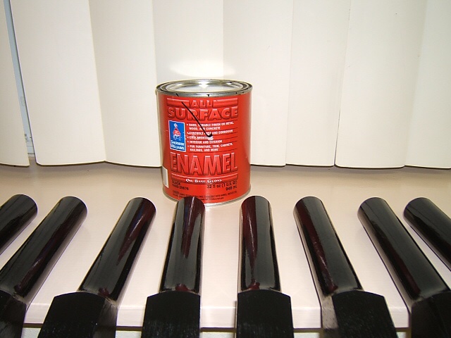

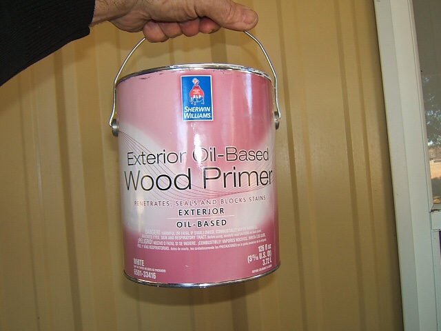

If there is grease or oil on the firewall, I would thoroughly clean it with lacquer thinner until all oil residue is off. After that, I would prime the wood with one coat of Sherwin Williams Oil Based Wood Primer. After it dries (about 4 to 5 days) I would apply a finish coat with 2 coats of Sherwin Williams All Purpose Gloss Black Enamel. Both Primer and finish can be nicely brushed on with a good 2” sash brush. I have posted pictures of the products. In the photo showing the can of black enamel, you can see the spokes I brush painted and how well it looks. Gloss is much easier to keep clean of oil, dirt and grease, than flat or satin finishes. Jim Patrick

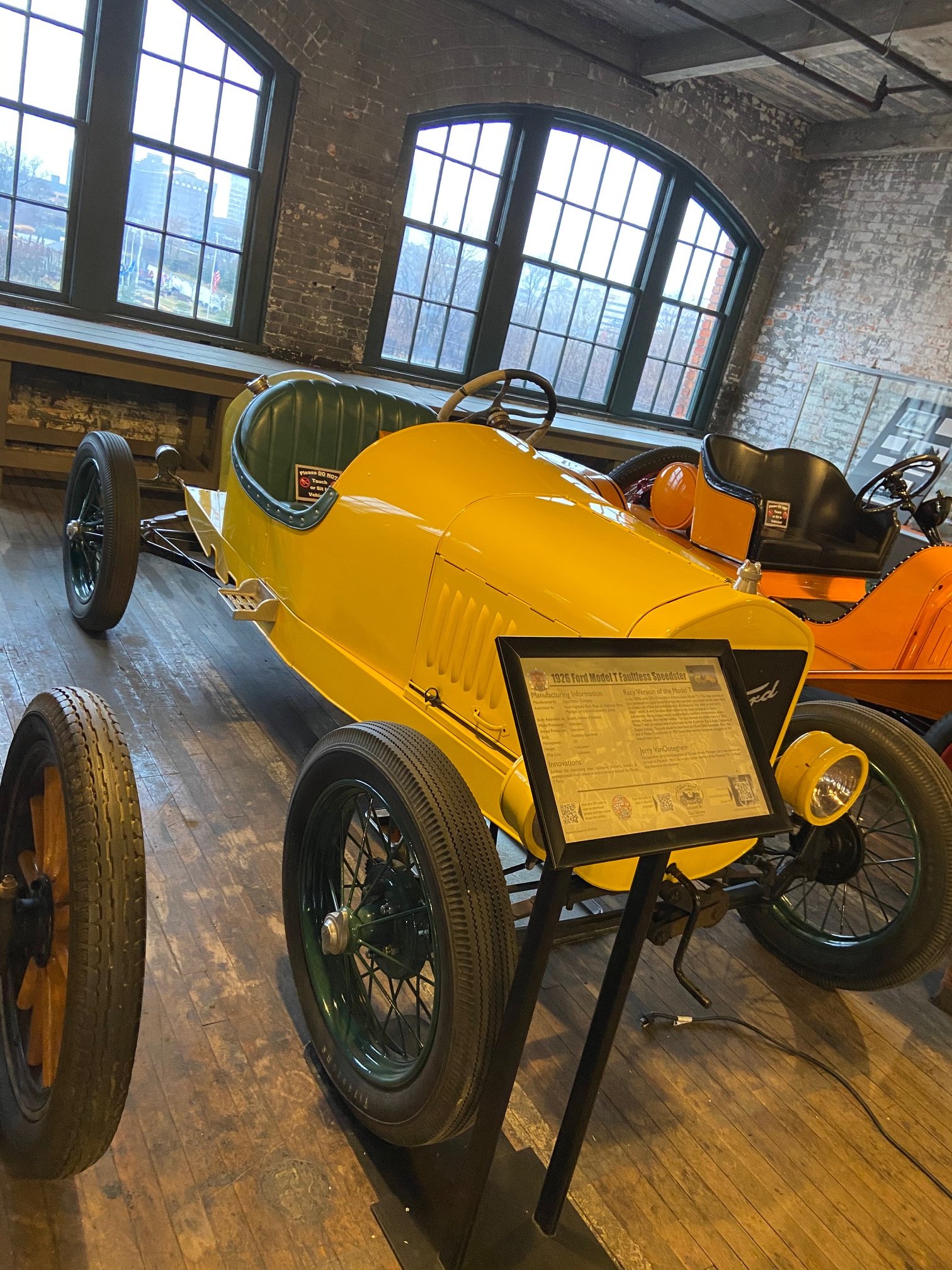

Jerry- the yellow car? Or do you have another one?
Jason,
Yes! The yellow one. I suppose you see it more than I do these days!
