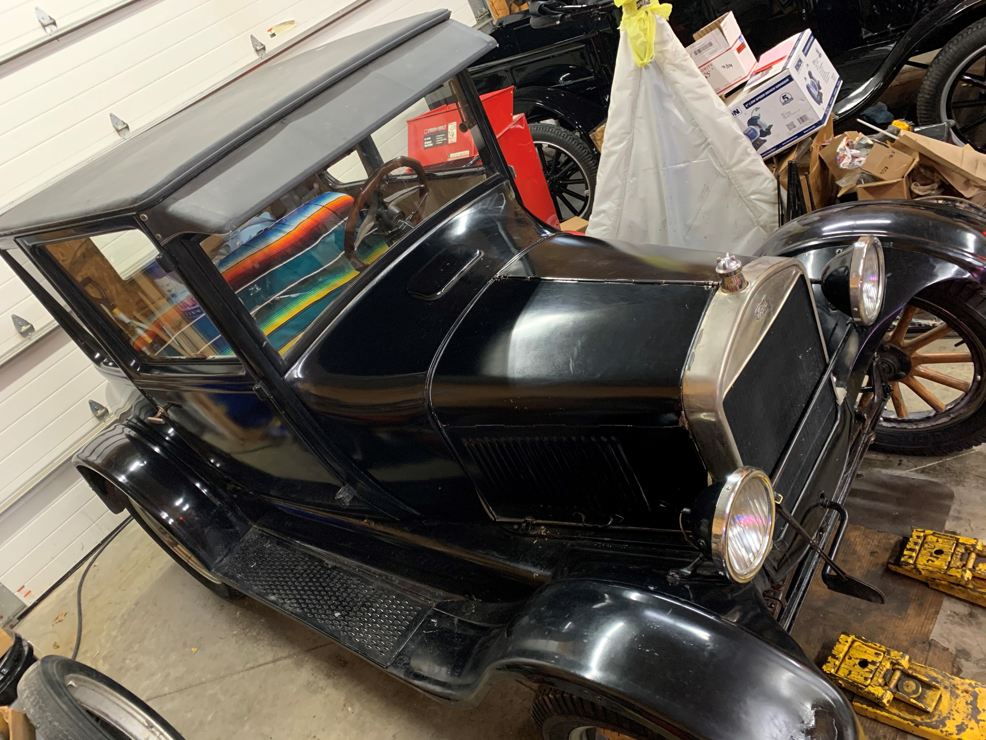

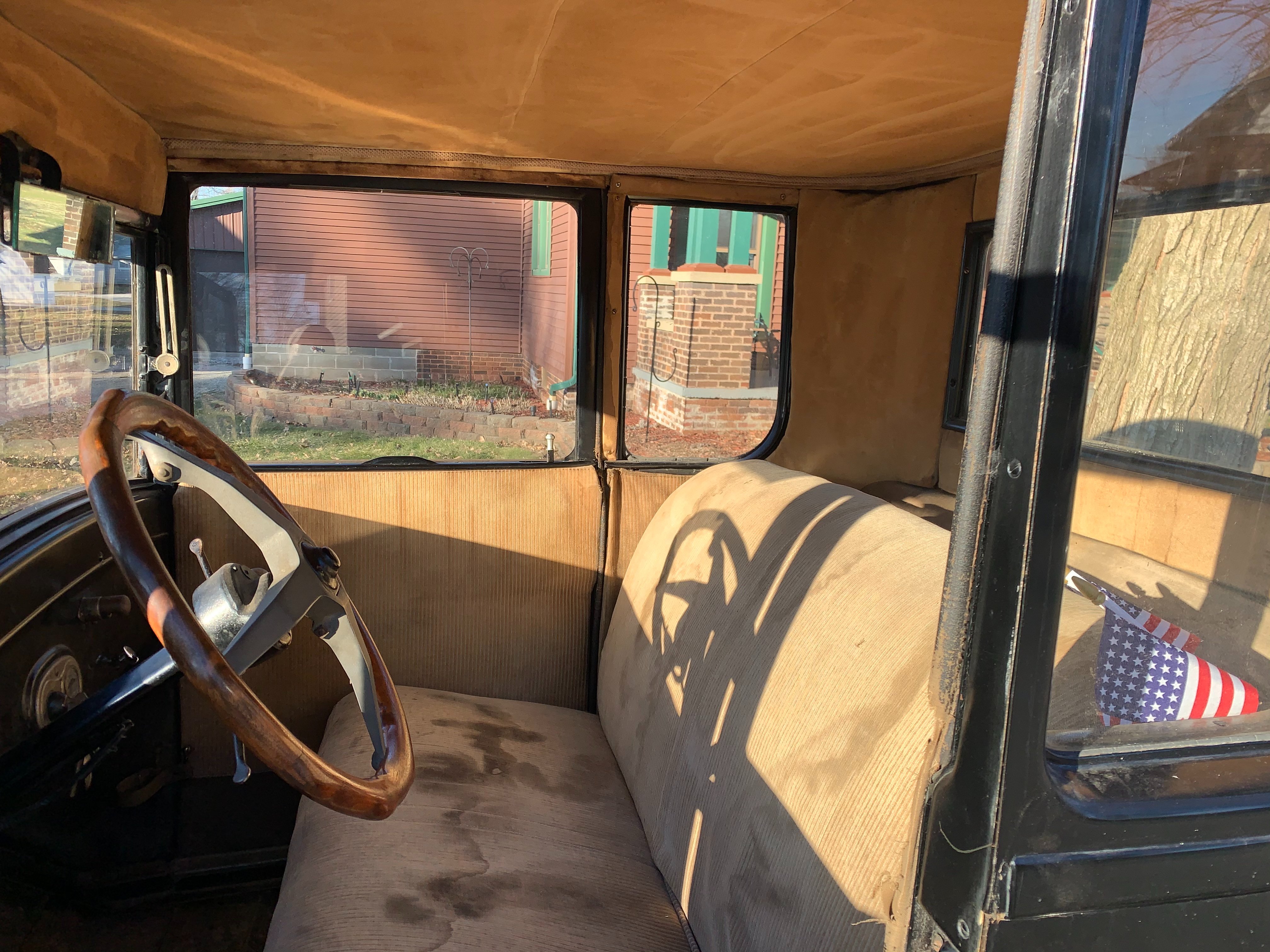

Post by Scott C. » Sat Dec 12, 2020 12:03 pm
My VIN is 13648885. I believe that dates it to 5/26/1926. I do not see any evidence of any other color than black. Here is a picture of the interior and the roof. The roof has obviously been replaced long ago.

jab35
Posts: 1006
Last Name: Bartsch
Location: Dryden, NY 13053
Re: 1926 Coupe Upholstery
Post by jab35 » Sat Dec 12, 2020 12:42 pm
Scott: My coupe is 13,606,xxx close date to yours, and mine was channel green, fwiw. You can get 'free' cloth swatch samples from the vendors, for a better idea of color and texture. I believe those samples are from Cartouche.
https://www.modeltford.com/item/SAMPLE-T1.aspx
I'm sure Mike Francis at Classtique would send you swatches at little cost. Nice car, jb

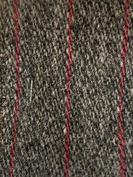

I contacted Mike at Classtique and he sent me 3 samples. They were grey with green stripe, grey with red stripe and grey with white stripe. He sent me 3 different options for the head liner, dark grey, a lighter grey and another that looked like a woven vinyl with some brown it. He said that all 26 Coupes were grey. I was curious if my interior was original, or not? Not sure if I want the grey? It might darken the interior quite bit? I have searched the net a little bit and have not found many pictures of a 26 Coupe interior. I am thinking that a tan and brown would look good. He is sending me some more samples from an earlier year.

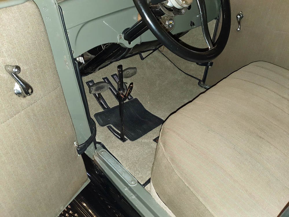

My green '26 Coupe has fabric that is green with brown stripes, and tan headlining. I believe it came from a US supplier as a kit around 1990. The carpet is new and home made.

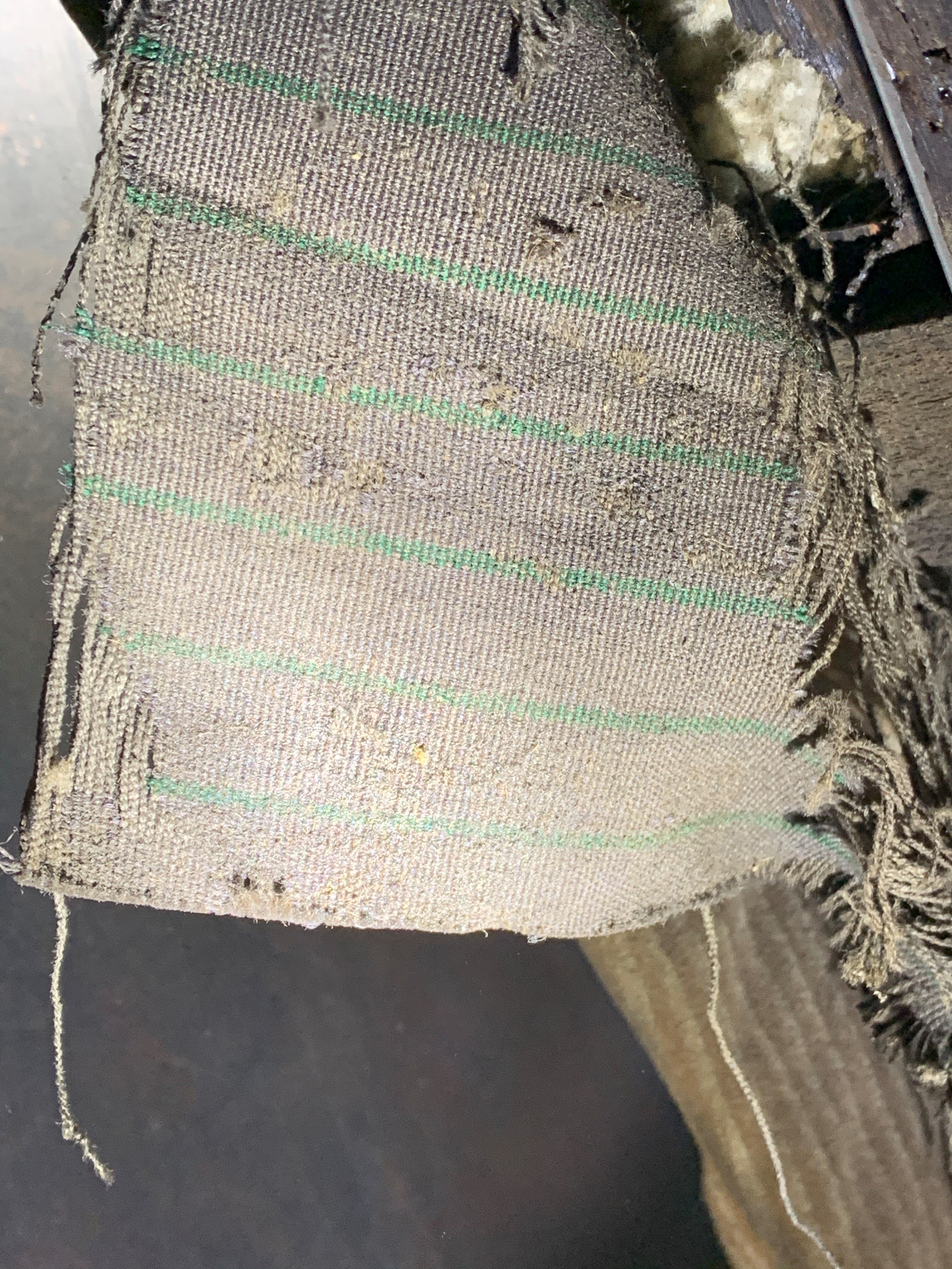

I found some original material on the back of the seat!

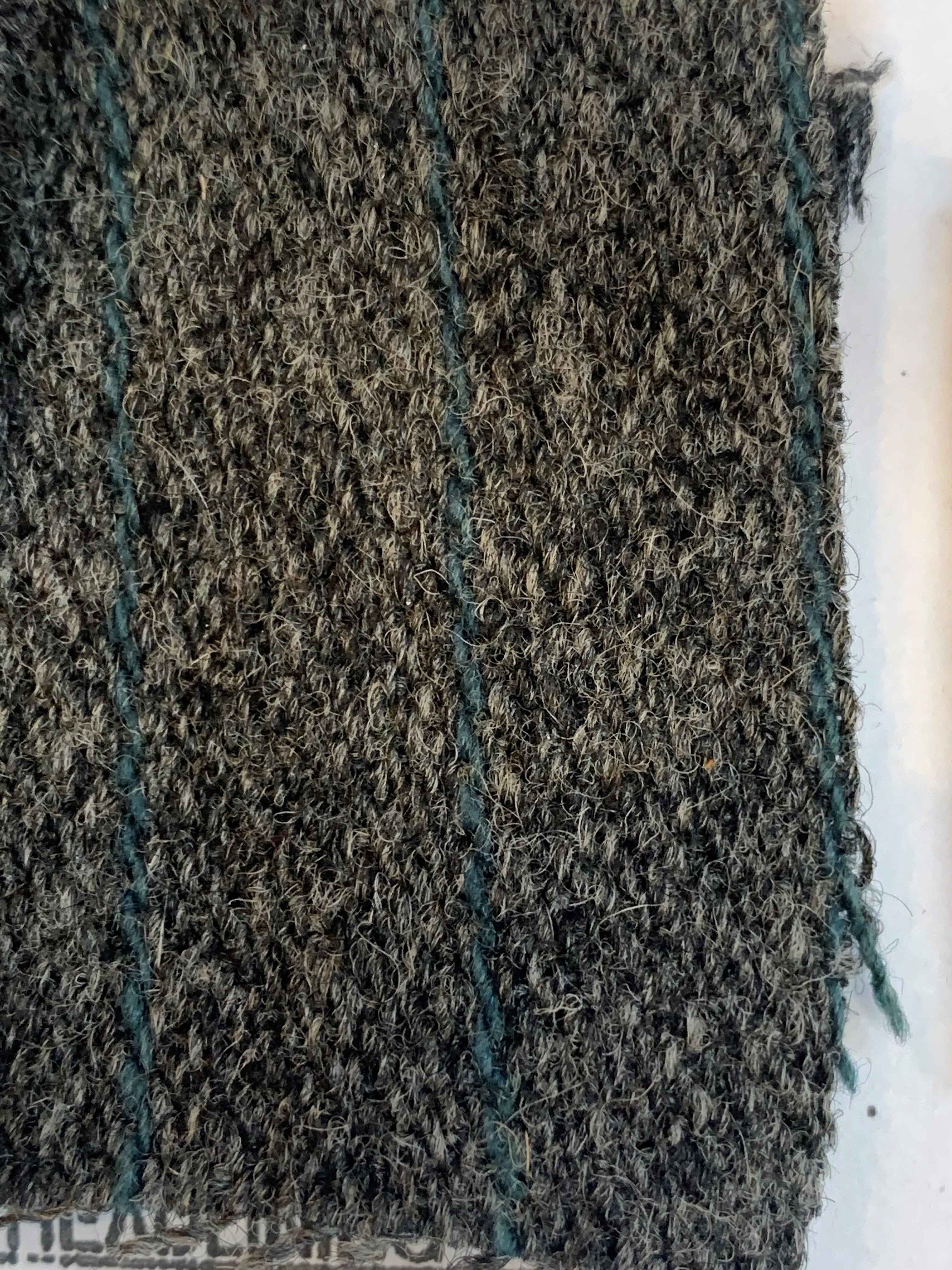

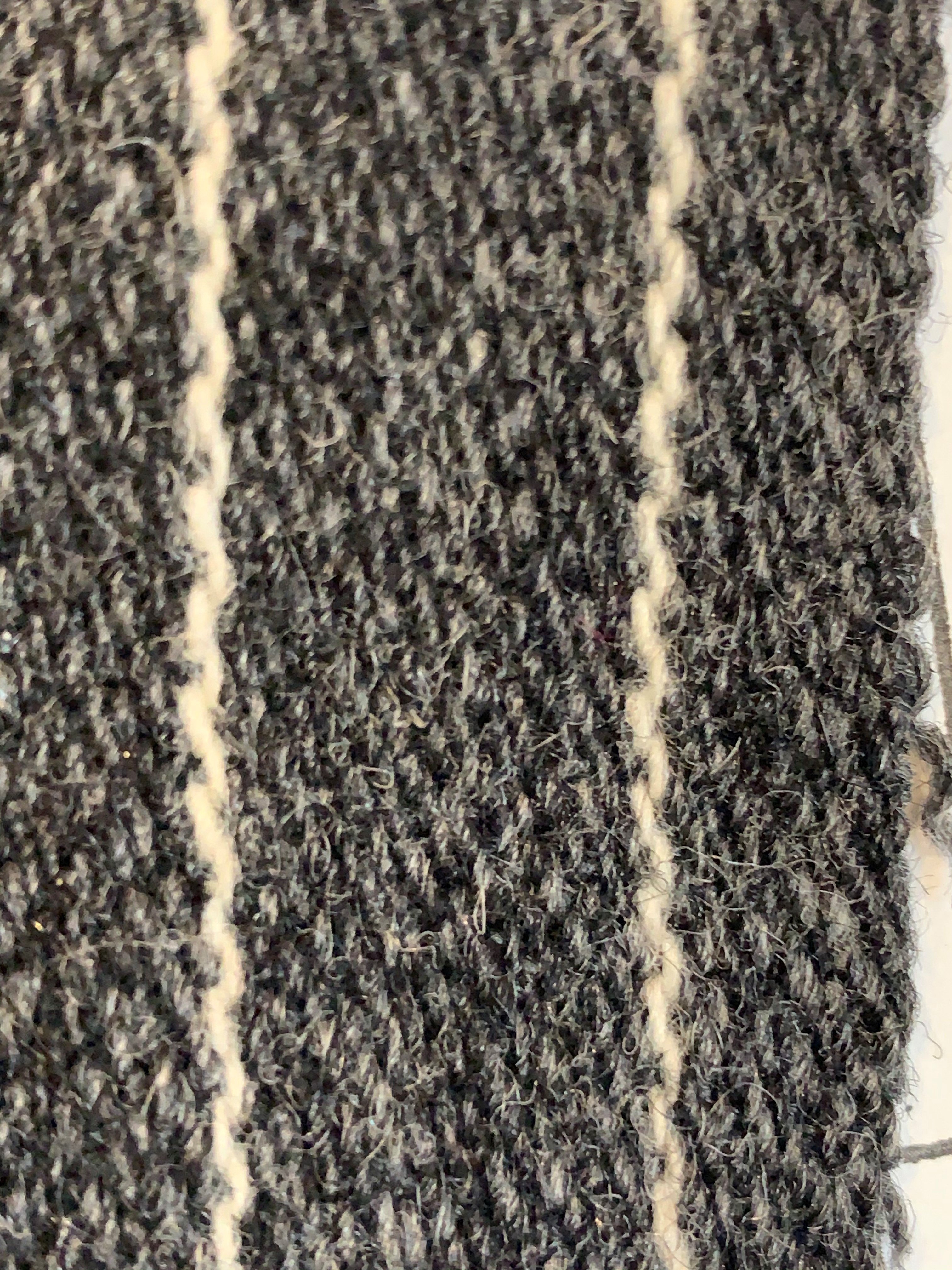

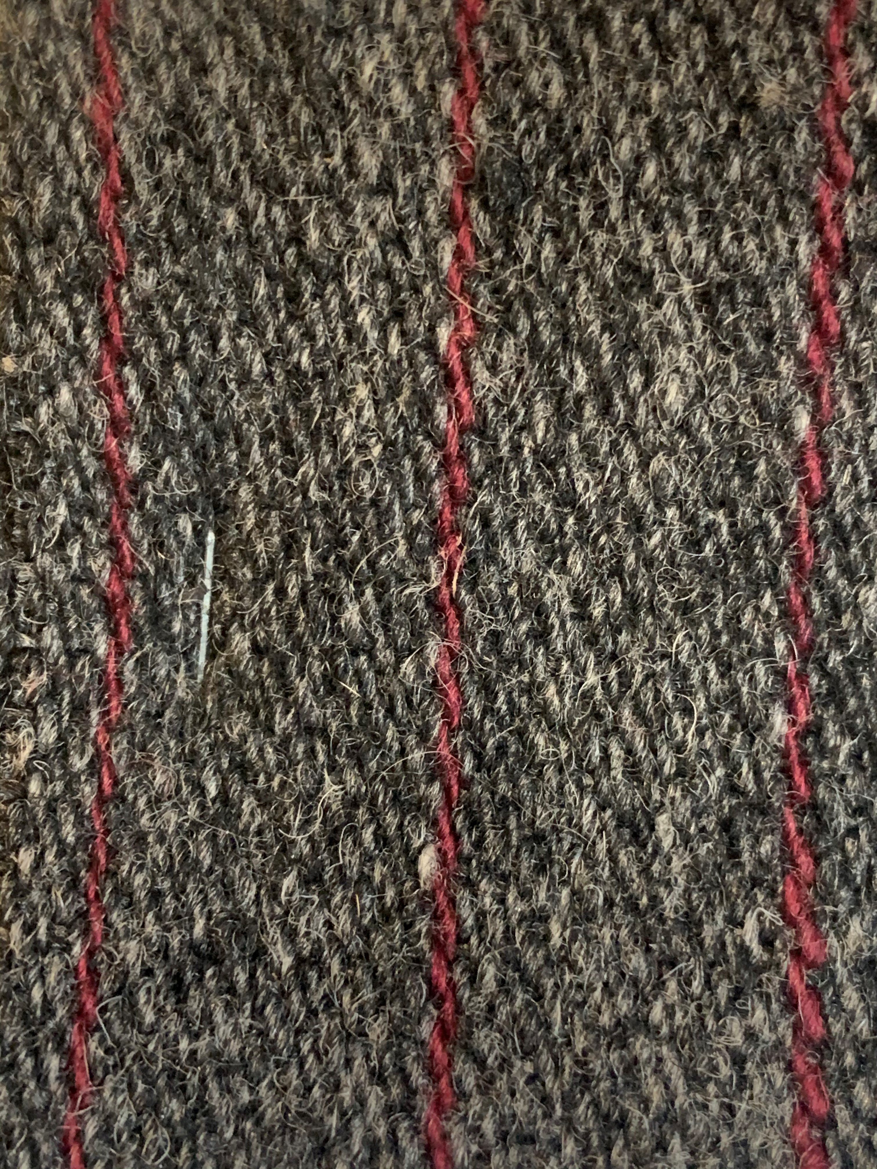

Here are the samples that he sent me.
Grey with green stripe.
Grey with red stripe.

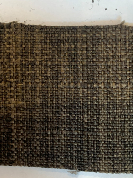

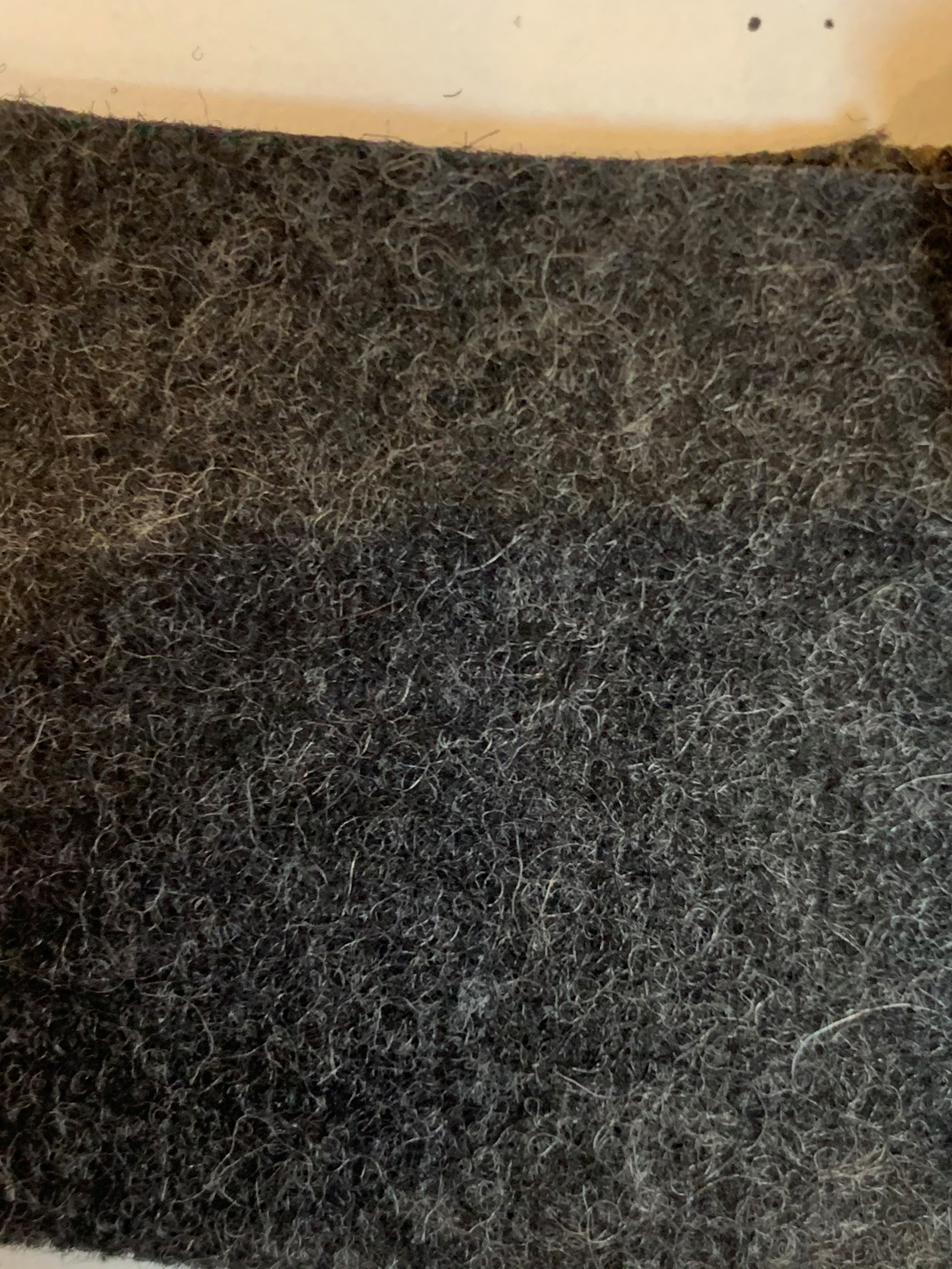

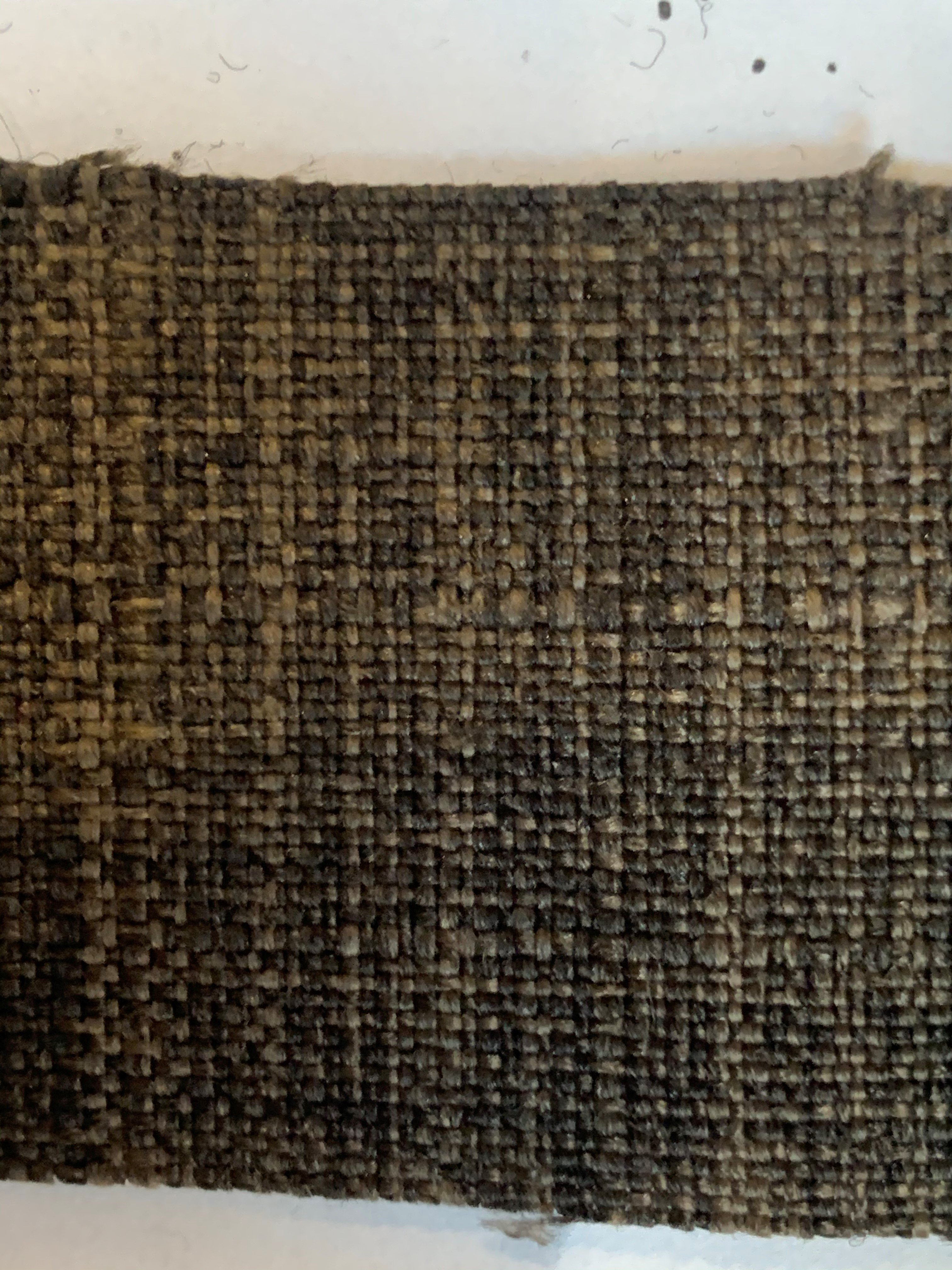

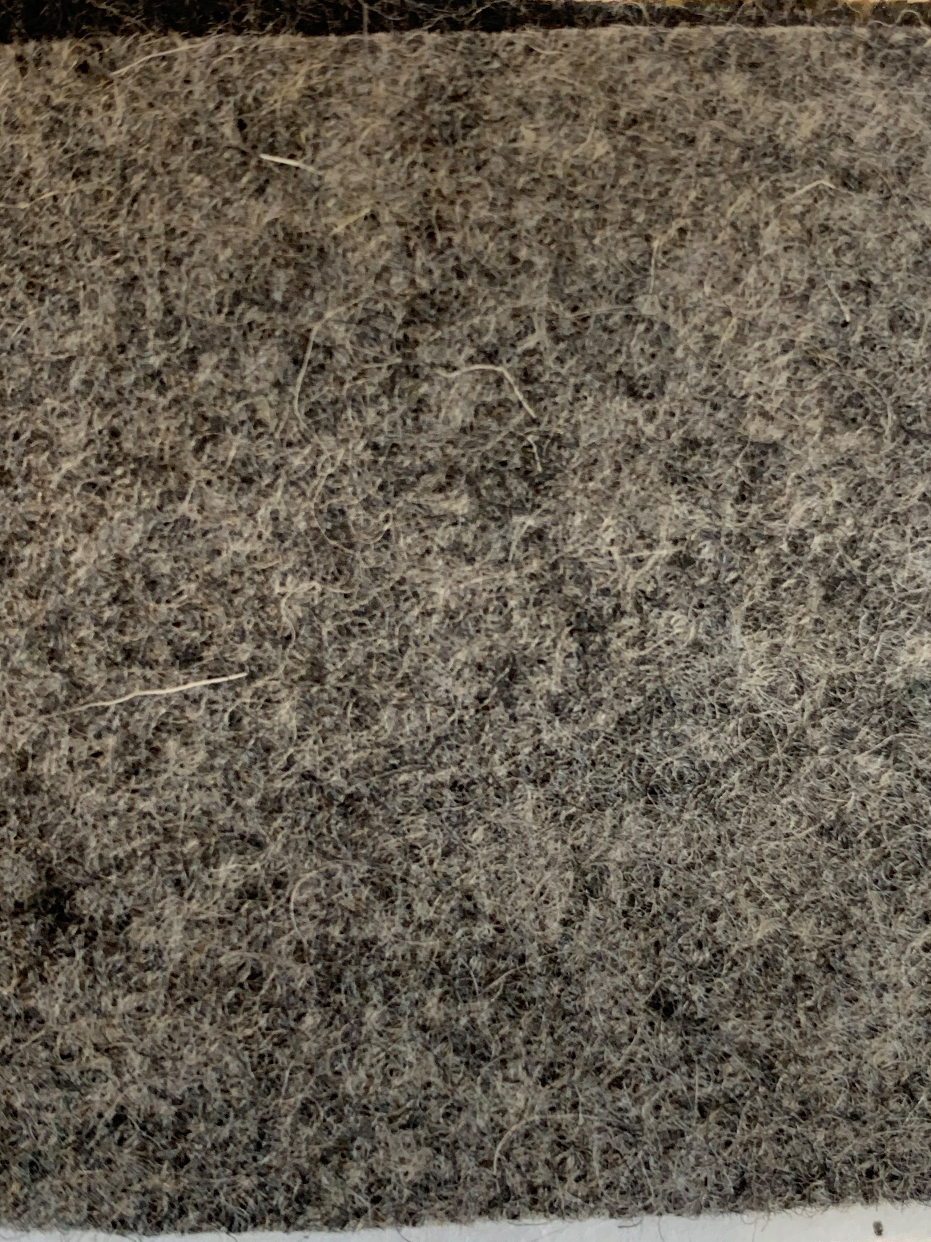

Here are the panel and head liner samples.
Light grey.
Dark grey.
And this.
Susanne
Posts: 1119
First Name: Susanne
Last Name: Rohner
Post by Susanne » Fri Dec 18, 2020 12:07 am
Scott C. wrote:
Thu Dec 17, 2020 12:29 pm
I REALLY like the way that Chrome Oxide Green stripe pop against the gray. It makes what we have now look too dark...

That's what I think too. I wonder how much the colors have faded over the past 94 years?

Scott C's sample is like what I have on my car, but mine was done in 1990.
Susanne
Posts: 1119
First Name: Susanne
Last Name: Rohner
Post by Susanne » Fri Dec 18, 2020 1:42 pm
Scott C. wrote:
Fri Dec 18, 2020 1:05 am
I think a little of both... but the greens are a different hue (the modern one is too bluish, the other one is definitely a green green)... then again, a lot of options for dyed cloth that were available (and common) in the early part of the last century are for the most part heavily regulated or outright banned - some of the pigments (that have lead, mercury, chromium, etc.) take jumping through hoops and filling out forms to get, where before they were commonly available. (We do historical egg tempera iconography and frescoes - getting the materials can be "interesting" to say the least!)...
If you look closely at the original VS the repop - the repop uses a woven-in thread for the green stripe... the original looks like it was dyed (run through rollers?) over the top of the fabric; it spans 3-4 "courses" of the fabric weave where the new is one course of thread, and has some skips on the edges in places... Regardless, it's fun to see the differences between then and now!
