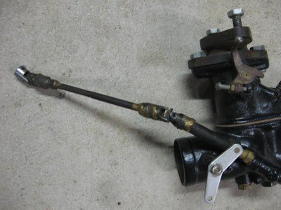

Here is a photo of what I did to use the over the top linkage on a Winfield Carb. My engine was originally a Vaporizer. When I bought the car it had a Model A Zenith using this setup that I modified for the Winfield. For the Zenith choke a couple of 1/4" drive universals were braised into the choke/adjuster rod.
