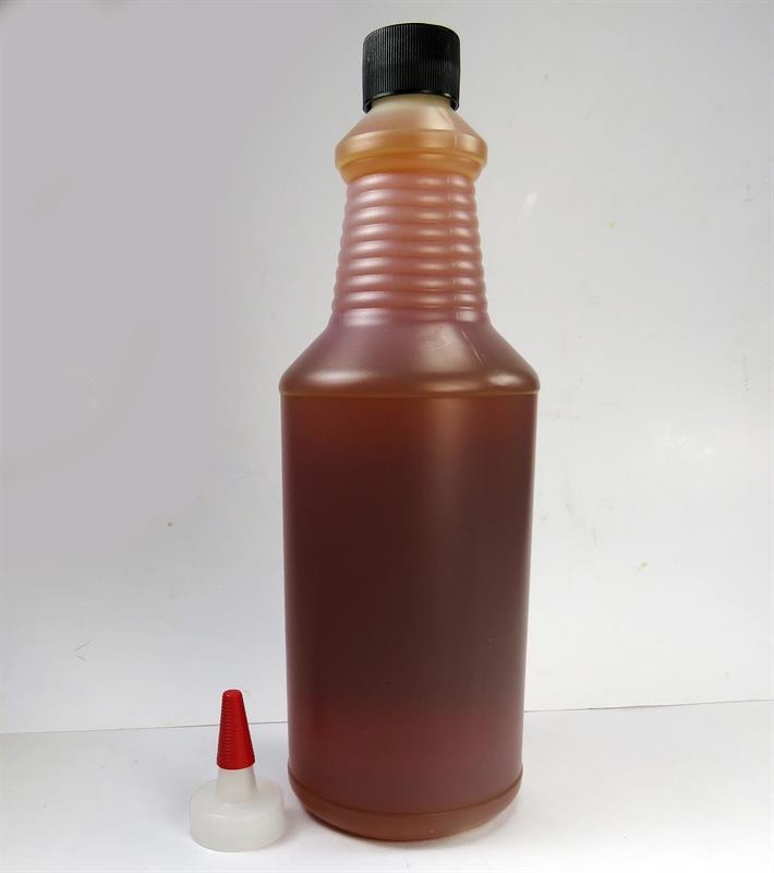

Jace,
I asked a similar question earlier this year and this was the most common response for the differential, 600w rear axle grease from T suppliers, like Lang’s:
https://www.modeltford.com/item/600W.aspx
