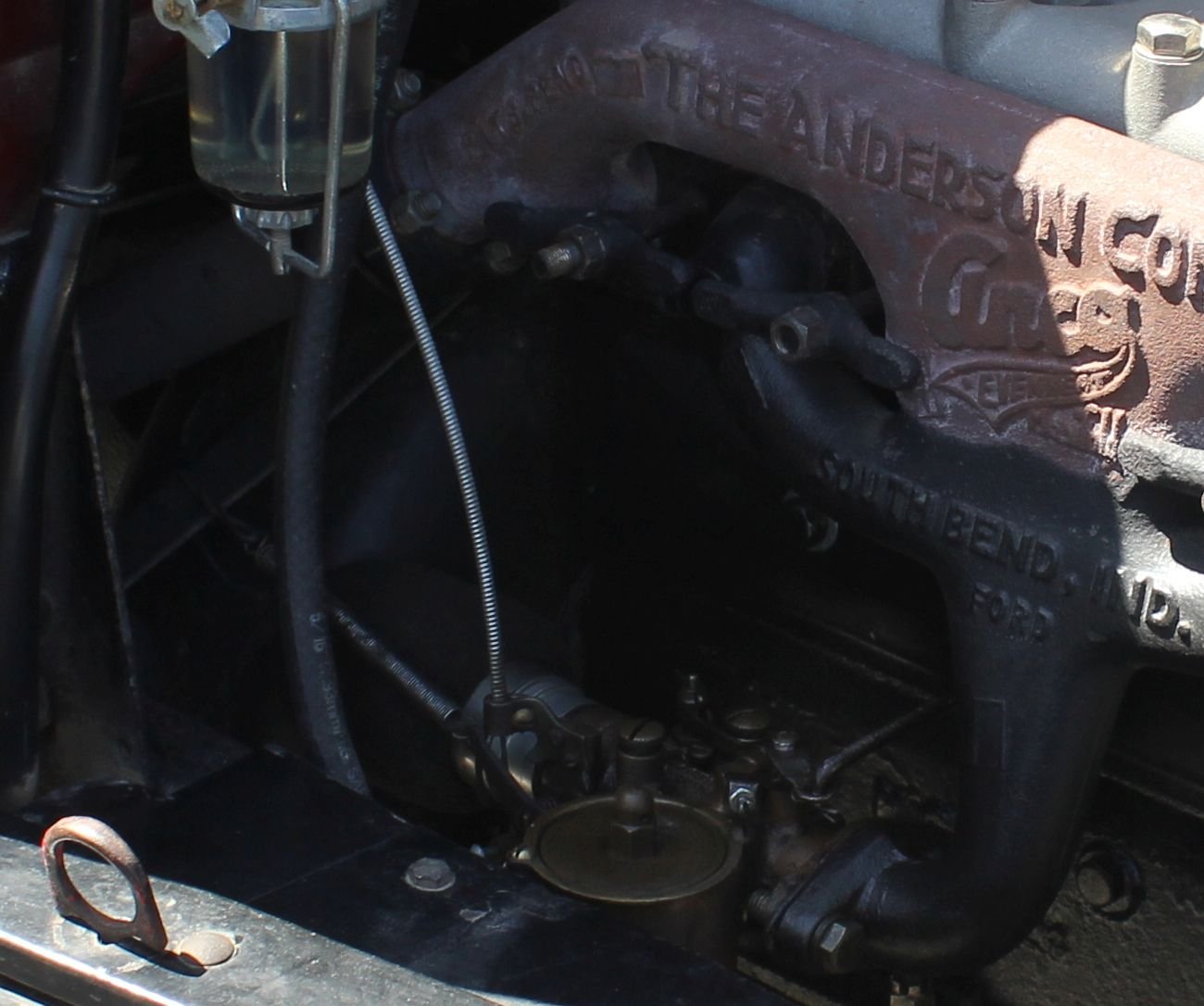

Here is the set up I’ve had on my ‘19 for the past 20 years. The vertical rod is just a piece of coat hanger....

Ohh .. ok, so you are connecting it to the arm meant for a cable. This isn’t made for choking ... but for an adjustment for making a lean mixture for driving. So I guess that adjustment isn’t so important then. Yes, I have the original rod for that bell crank to the old carburetor. Thanks.

Mark Osterman wrote:
Sun Feb 24, 2019 8:04 pm
Yes, both ends of the “y” arm on the carburetor are for the choke plate. Top arm for rod out to the radiator and bottom arm for wire to lever near steering wheel for choking while in the driver’s seat.

Mark : Do like Michael says and use the lower lever on the choke control. It's almost the same as the arm on an NH but the Stromberg has no return spring built into the mechanism. If everything is totally free, the choke will usually open by gravity, but I attach a light spring to pull it open. The choke arm has nothing to do with adjusting the mixture for driving (like the mixture control on all the original T carbs). Once the two adjustable jets are set, no more adjustments are required except for maybe idle speed occasionally. Cheers : Bruce

I added a return spring to mine also and used the original choke rod.
The Stromberg likes a little choke till it runs for 20-30 seconds. I also put a piece of vacuum line around the choke rod where it goes through the firewall to hold it in place.

This is my set up. I used a choke cable with a knob that looks like the original choke control. Also used a spring. Works good.
