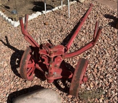

This is the one I have. Quite a bit different than the pic you posted.

Thanks for the input Tim. I would guess the there were various iterations of the Auto Ambulance because it either developed over time or there were different applications.

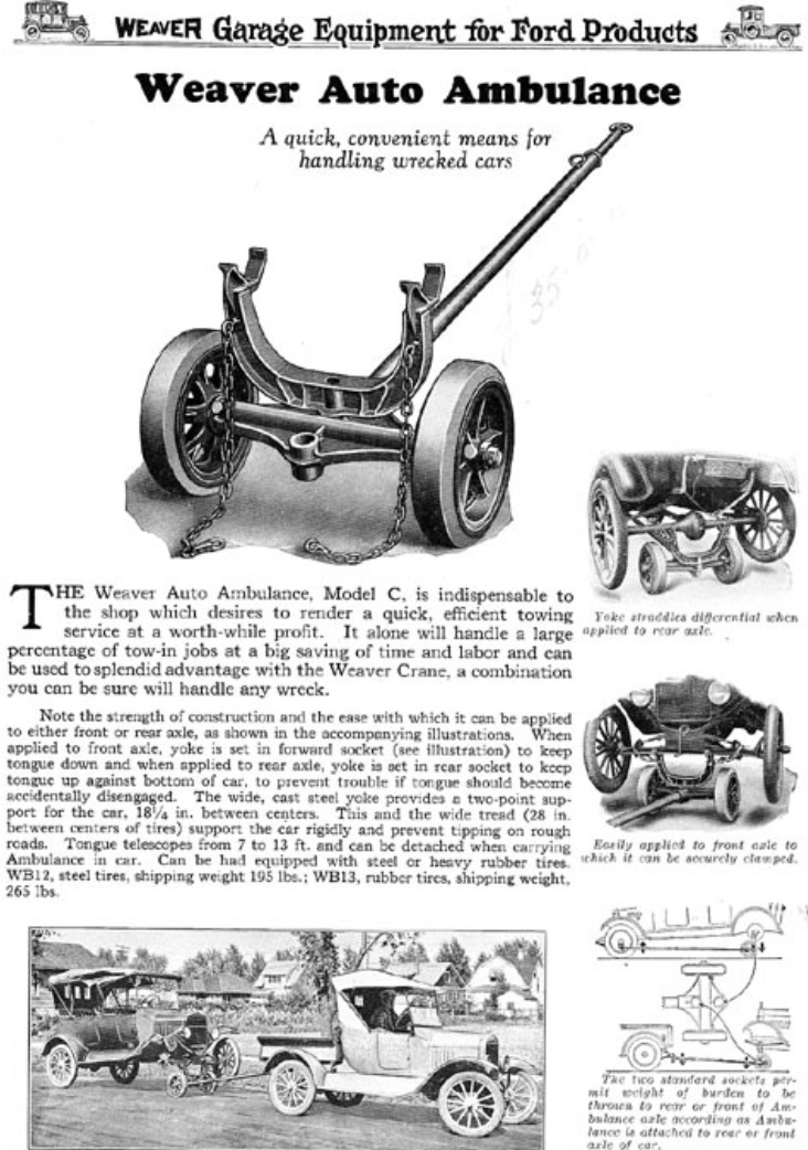

Post by Herb Iffrig » Tue Nov 24, 2020 8:06 am
Thanks John.
That is a good site.
The one I have is like the one in the first ad on the site:
weaver ad 1918.JPG (51.09 KiB) Viewed 1767 times
If you look closely mine might not need the need the attachment , it is not used in the photo. It might need a piece to clamp it to the front axle.
That is good news.
