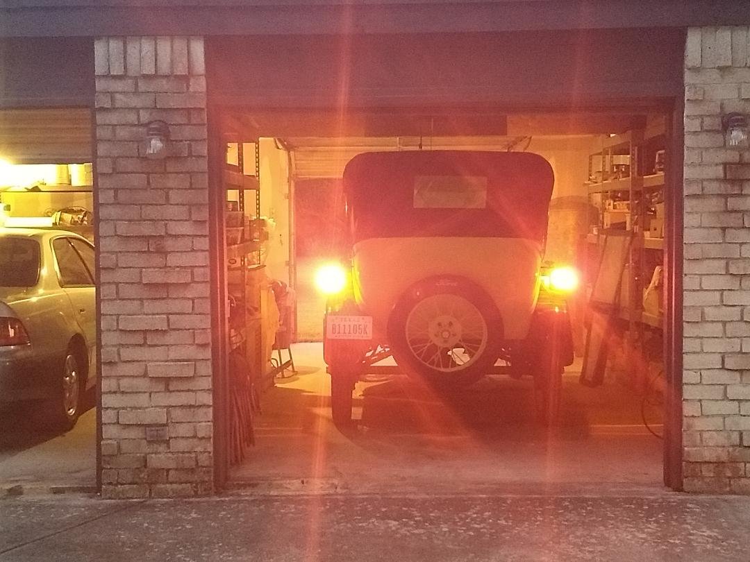

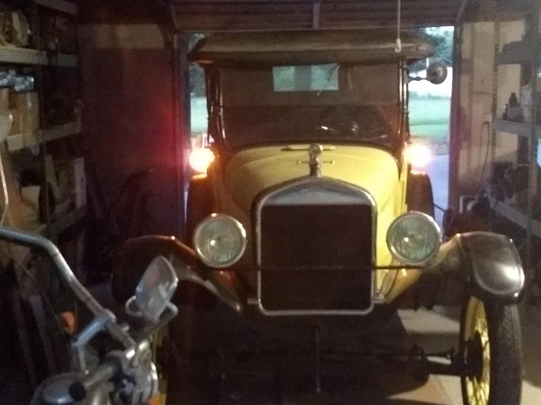

INVISIBLE CAR
This is the set up on My 26 touring. Dual color HF trailer lights amber front. red to the rear. mount to top tie down saddle posts can be removed with quick disconnects and stowed out of sight in five minutes. color washed out in photo. Your butt! Your choice! small stock tail light on a black car or something that can be easily seen. They can still hit You while distracted or texting but they can't say You were invisible.
