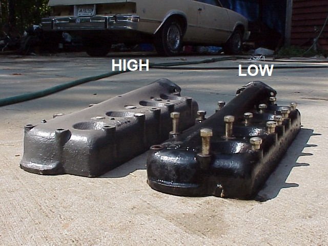

- Posts: 6544
Re: Low Head High Head?
Found a picture
