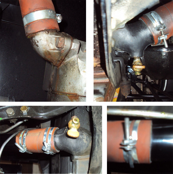

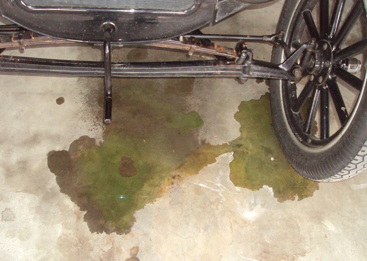

After taking these photos I see several problem areas and will return the car to the shop.
The first photo shows the car parked back slightly from where the leak first occurred. It also shows which way the floor slopes. The second photo shows drips at the upper and lower hoses. The antifreeze at the bottom of the water jacket probably came from the hose, not a crack but I will check there. Taking photos works better that trying to look to see. Thanks for the suggestions.

That's a bigger puddle than I thought I would see. From looking at the pictures, it looks like the upper hose leaks at the bottom end. You can see from the rust stains, that it has been going on for a while. It looks to me that the clamp is quite high on the hose. If you remove the hose, you might find that the fitting is rusted toward the end where the hose is clamped. It is possible there could be a hole rusted clear through maybe hidden by the hose, but below where the clamp is located.
I would suggest that you remove the hose, and clean up the fitting as well as you can, looking for deep rust pits or possibly the ridge at the top of the fitting is rusted where it is clamped under the hose, leaving a groove where the coolant can leak through even when you clamp down. Perhaps you can smear some ultra black in the area and let it set up about 15 minutes, trying to cover any holes or pits in the metal. Then install the hose again and place the clamp lower on the hose and preferably over the area which was smeared. Then let the ultra black dry for about 24 hours before you fill again.
If that doesn't fix your problem, then I was wrong and the leak is somewhere else.

That's coolant (as we all know). I have an issue with my repop rediator leaking from the radiator inlet (top hose) and am planning on pulling and (hopefully) repaiting it.... but I still think there's other forces afoot. I'm consulting my 100 year old Tarot deck, but all it seems to tell me is (a) I need to get my hair bobbed, (b) practice your charleston before the next dance marathon, and (c) get a horse. No help. I think I'll go back to casting spokes and reading T spring leaves...
