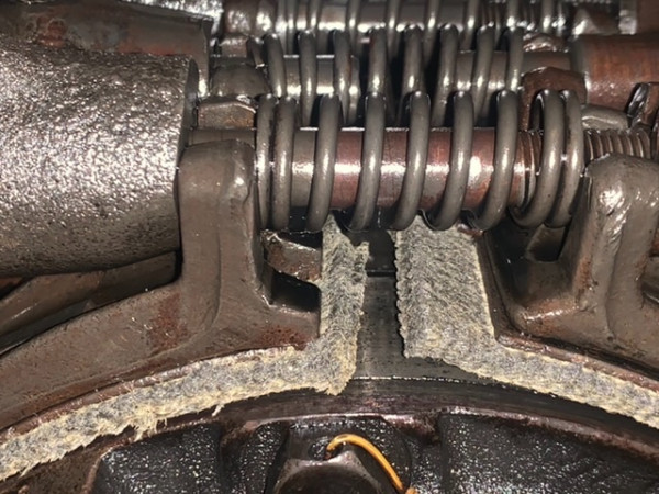

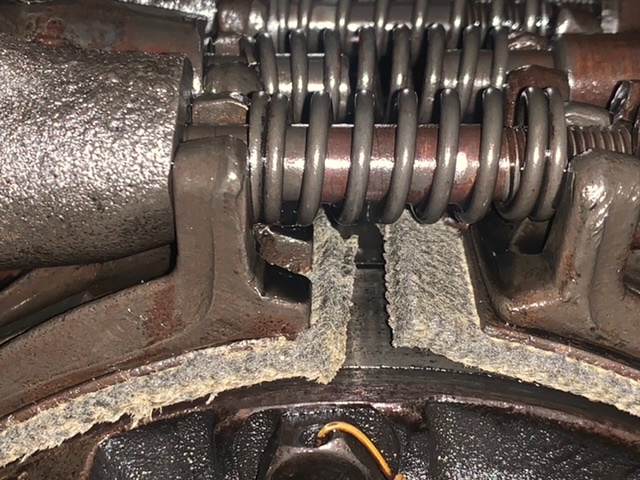

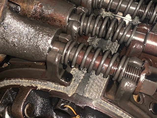

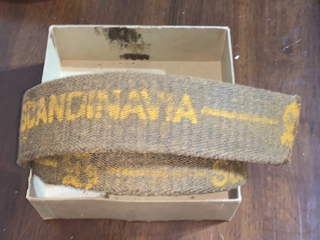

On another thread I was asked about the band type currently in the 13T. I didn’t install these bands, so I don’t know the type. I’ve previously found a box of Scandinavian bands in one of the parts boxes, possibly a clue. I’ve attached a pic, do they look like the Scandinavian type bands?

They look like Kevlar bands to me. I like to adjust them just enough so they work well. That way, maximum clearance is maintained between the band and drum when they are not in use, and there is no drag. The distance from floorboard measure may have had some relevance when the cars were new, but with 100 years of pedal tromping, bent pedals, worn pedal ramps, recut floorboard slots etc, it is not all that reliable a reference these days.
