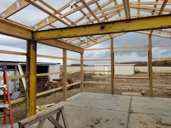

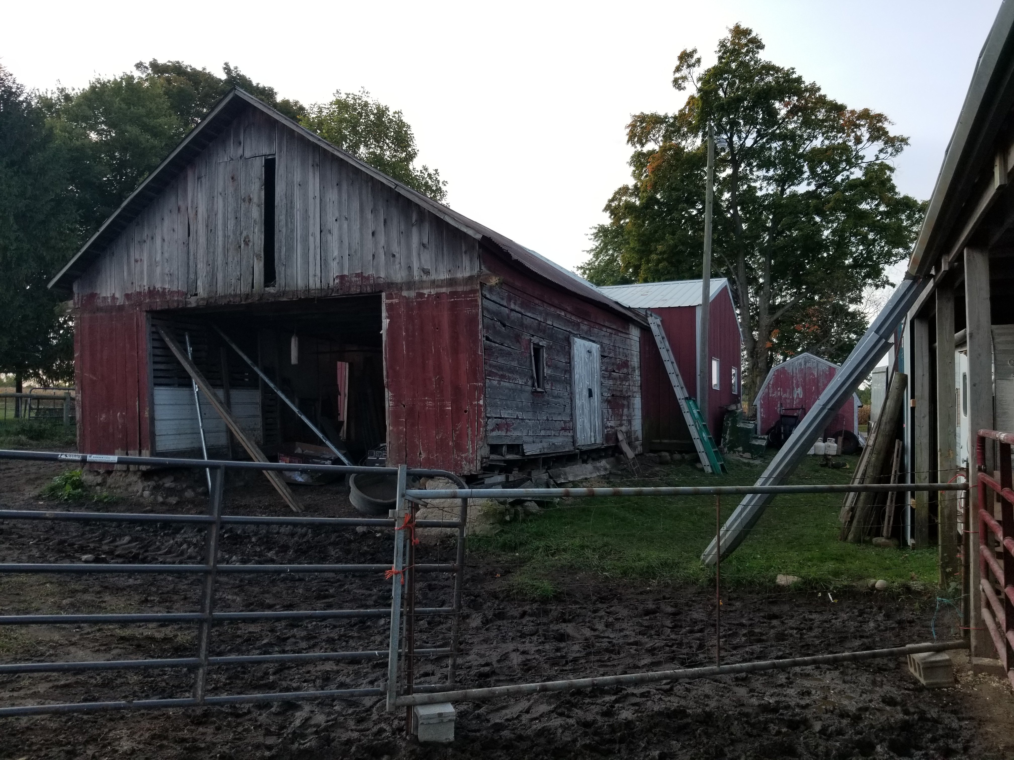

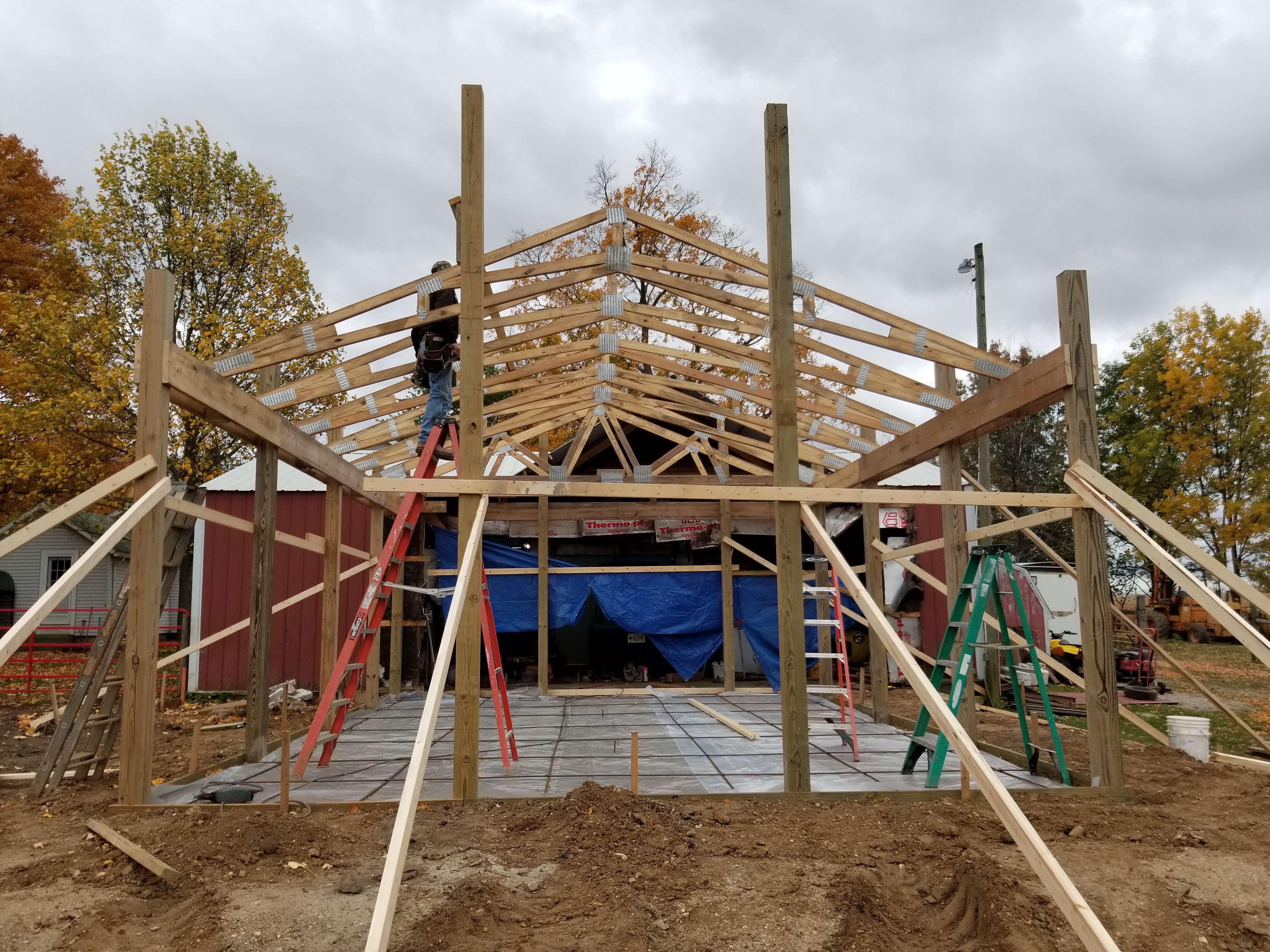

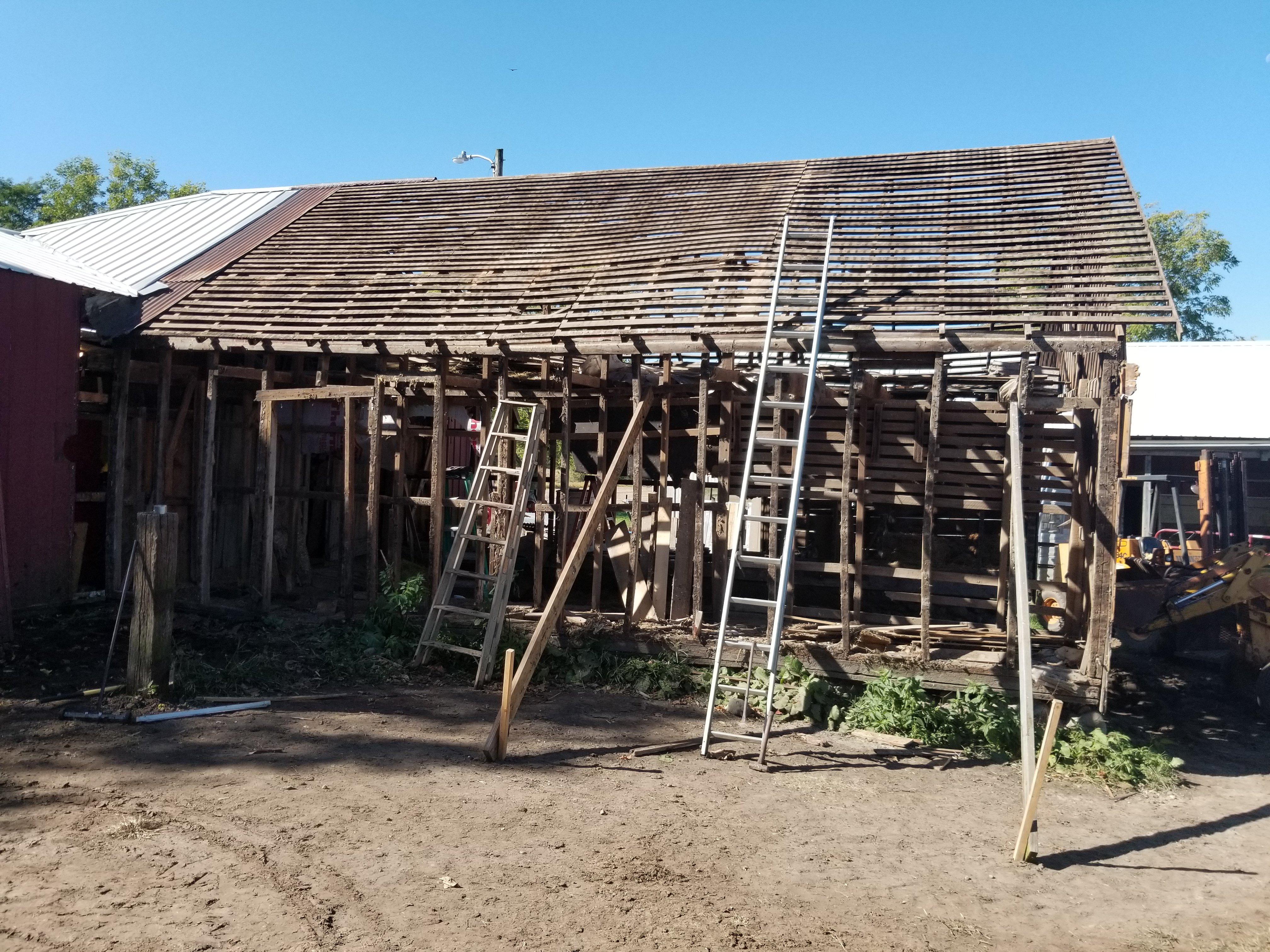

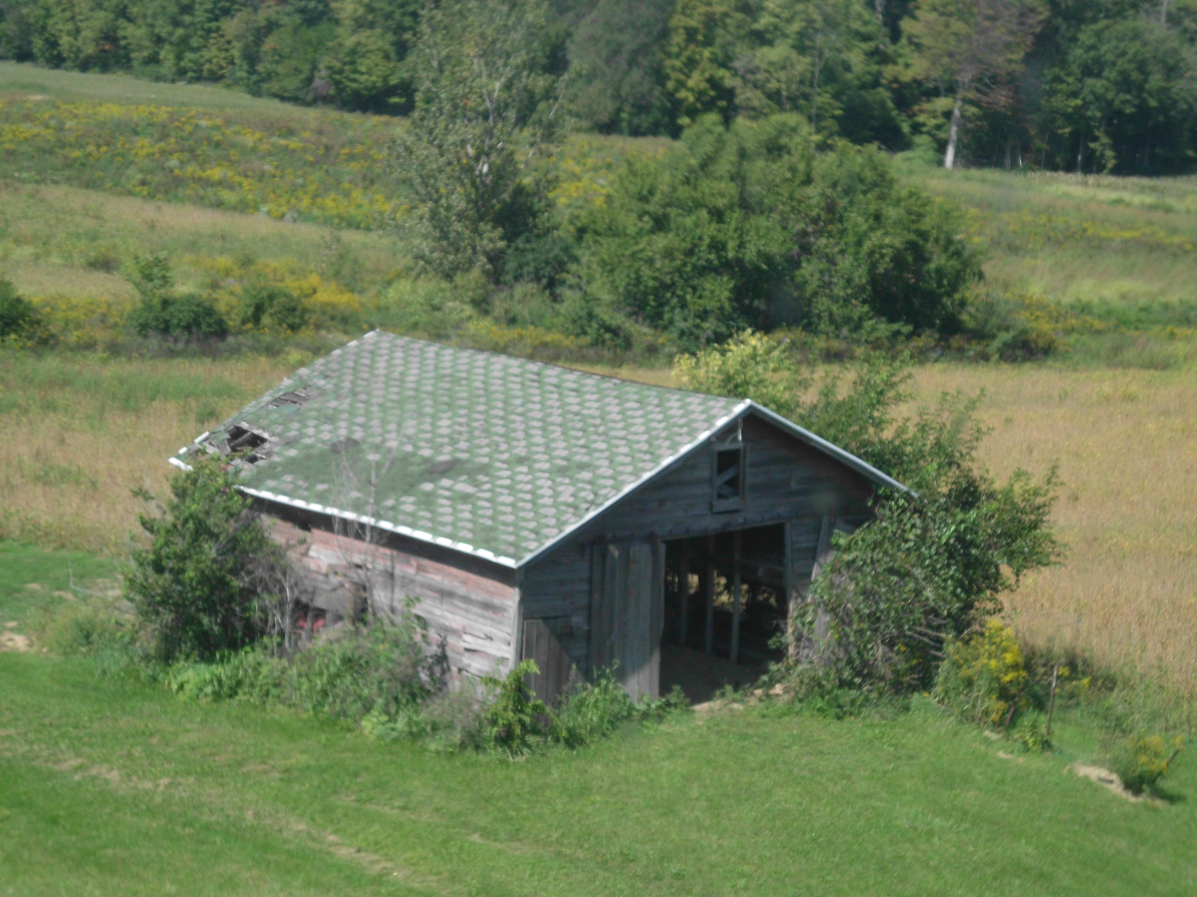

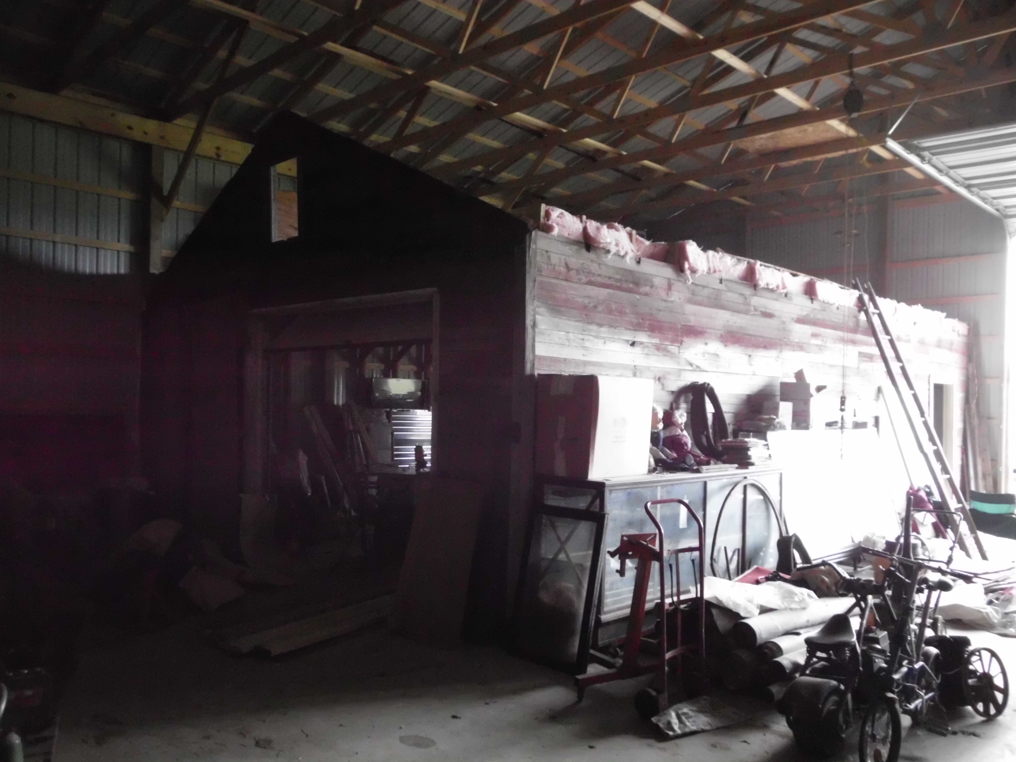

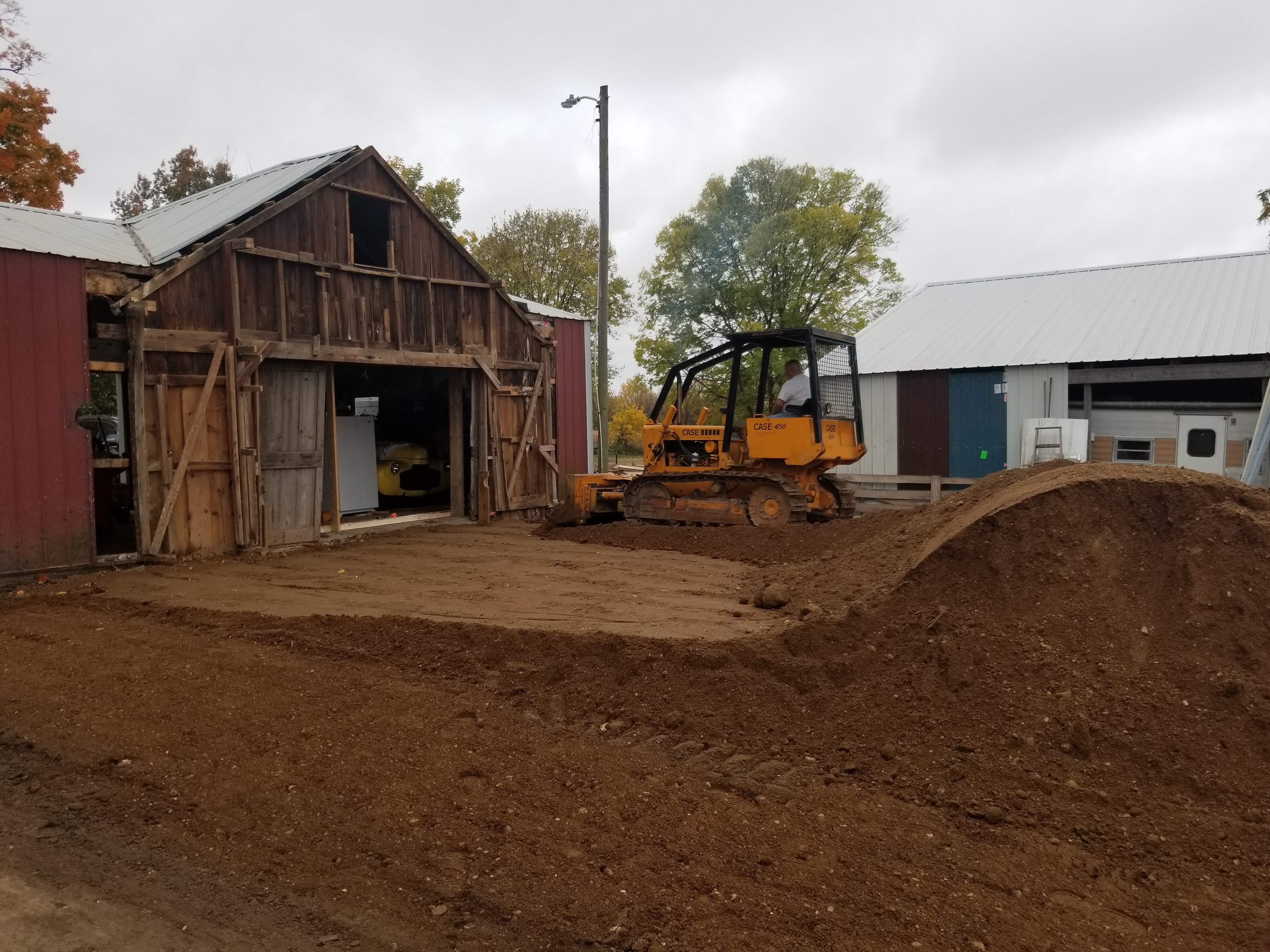

I havnt posted much this fall. I have been doing a project I have put off for ten years or more. My customers projects always come 1st. Since material prices have delayed a couple large projects for me, I pulled the trigger on my new shop.
I have collected materials including trusses that have been stored in my big barn for years. I 1st had to modify the leen-to on my big barn for hay storeage and horse shelter. Another factor in the project timeline ( didnt think my horse would live this long).

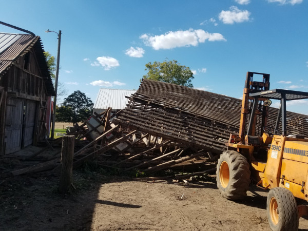

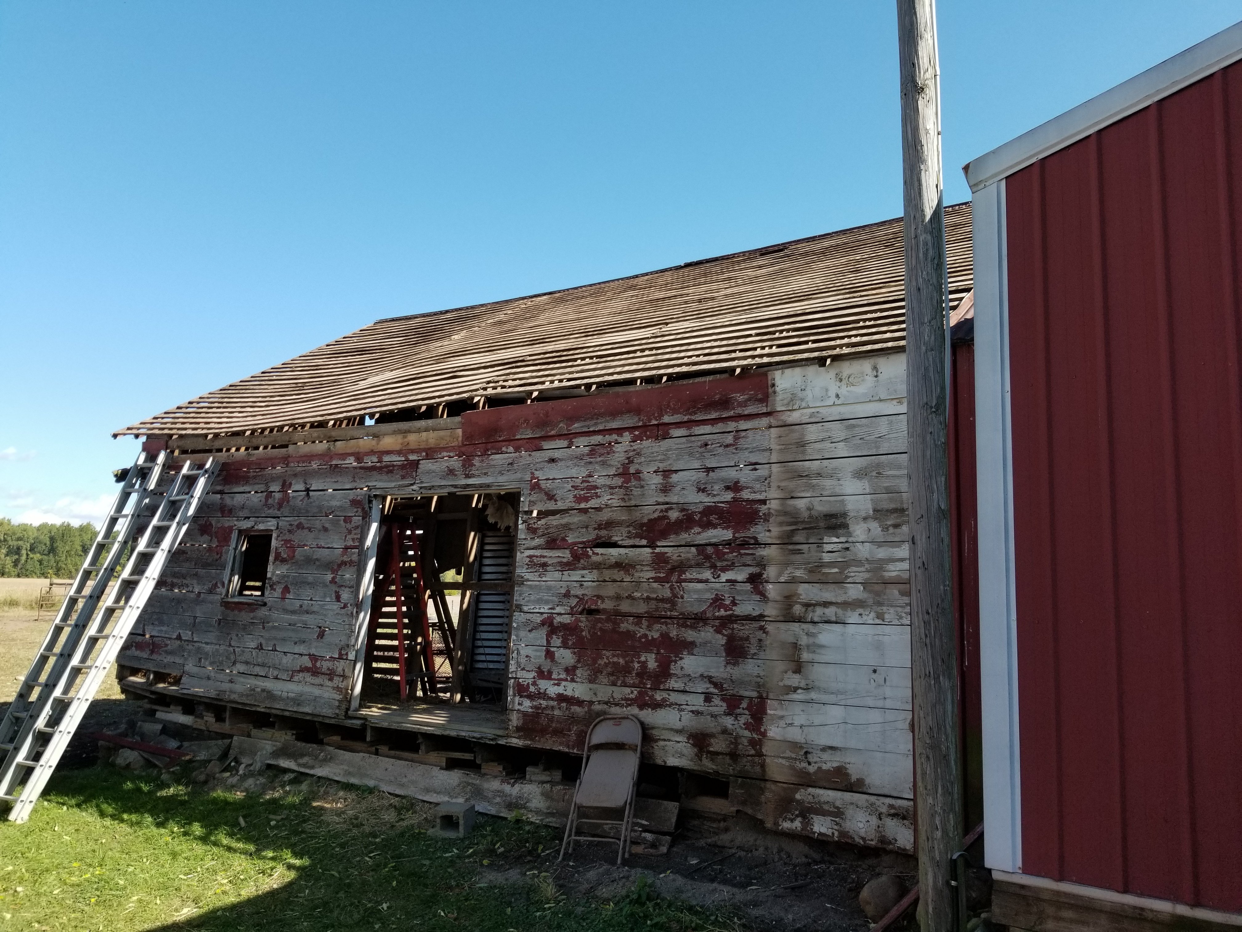

Then it was time to remove all the stuff I could use in my new shop from the old barn. I loved the look of the old barn but everything I put in there was covered in bird $hit. My garage/ shop was built onto the front of this old barn by a previous owner that thought it was a good idea. The back of the shop was supported by this old building that was leening and crumbling. I had to support 32 ft of the garage/shop to demo the old barn.

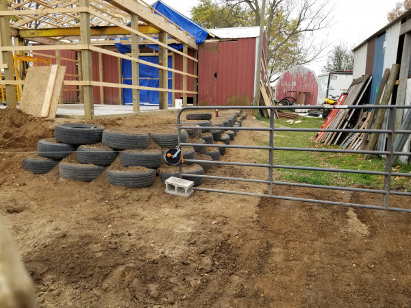

Then the building pad and retaining wall. Yes gravel packed tires for a retaining wall. Tired of beating gravel with a sledge! I will start posting photos and see how that goes. I think the T's will feel at home in my new T shop. Building to be removed More photos coming

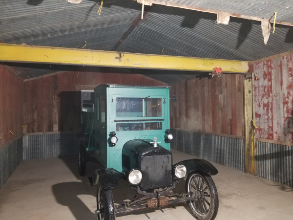

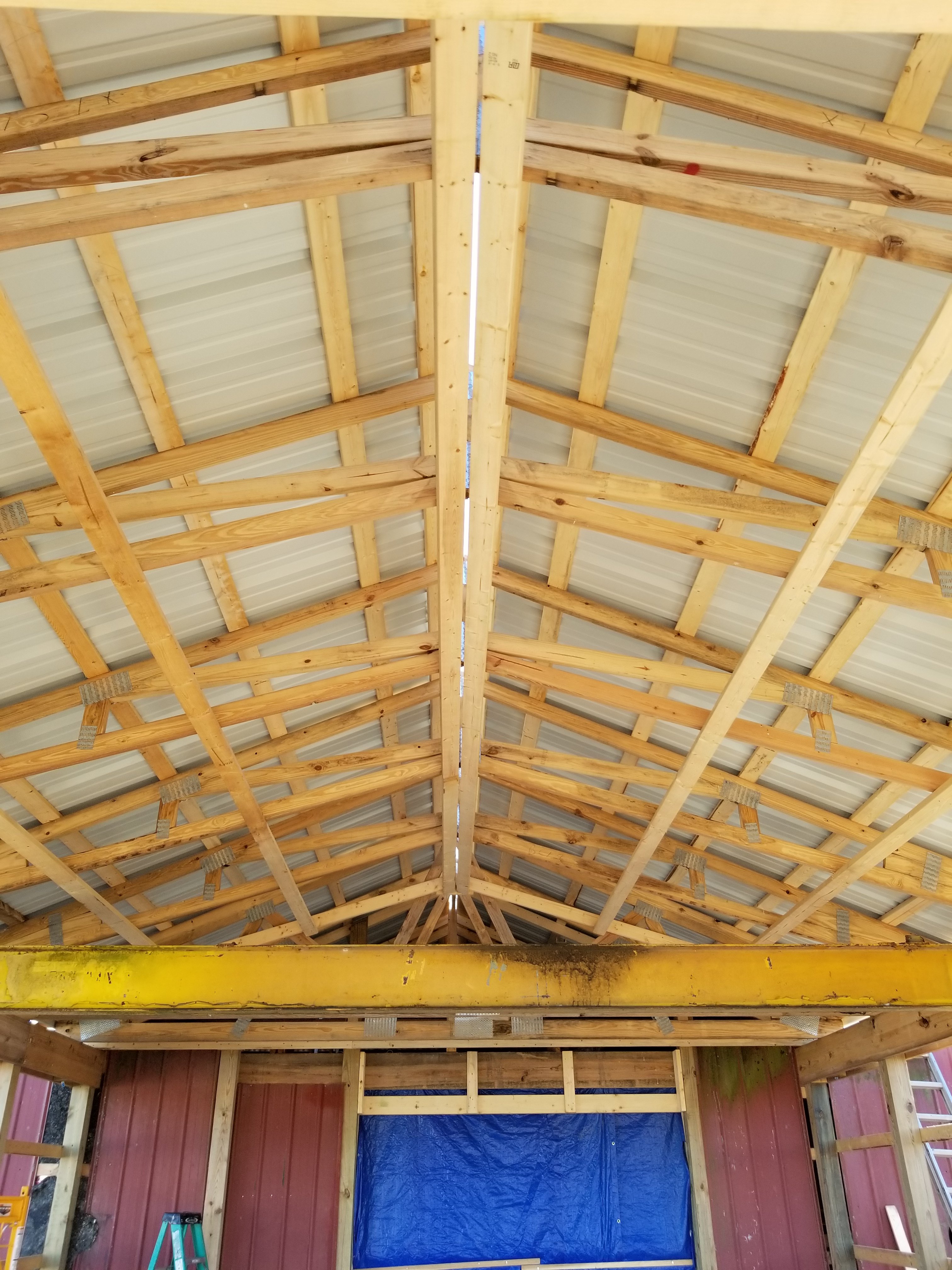

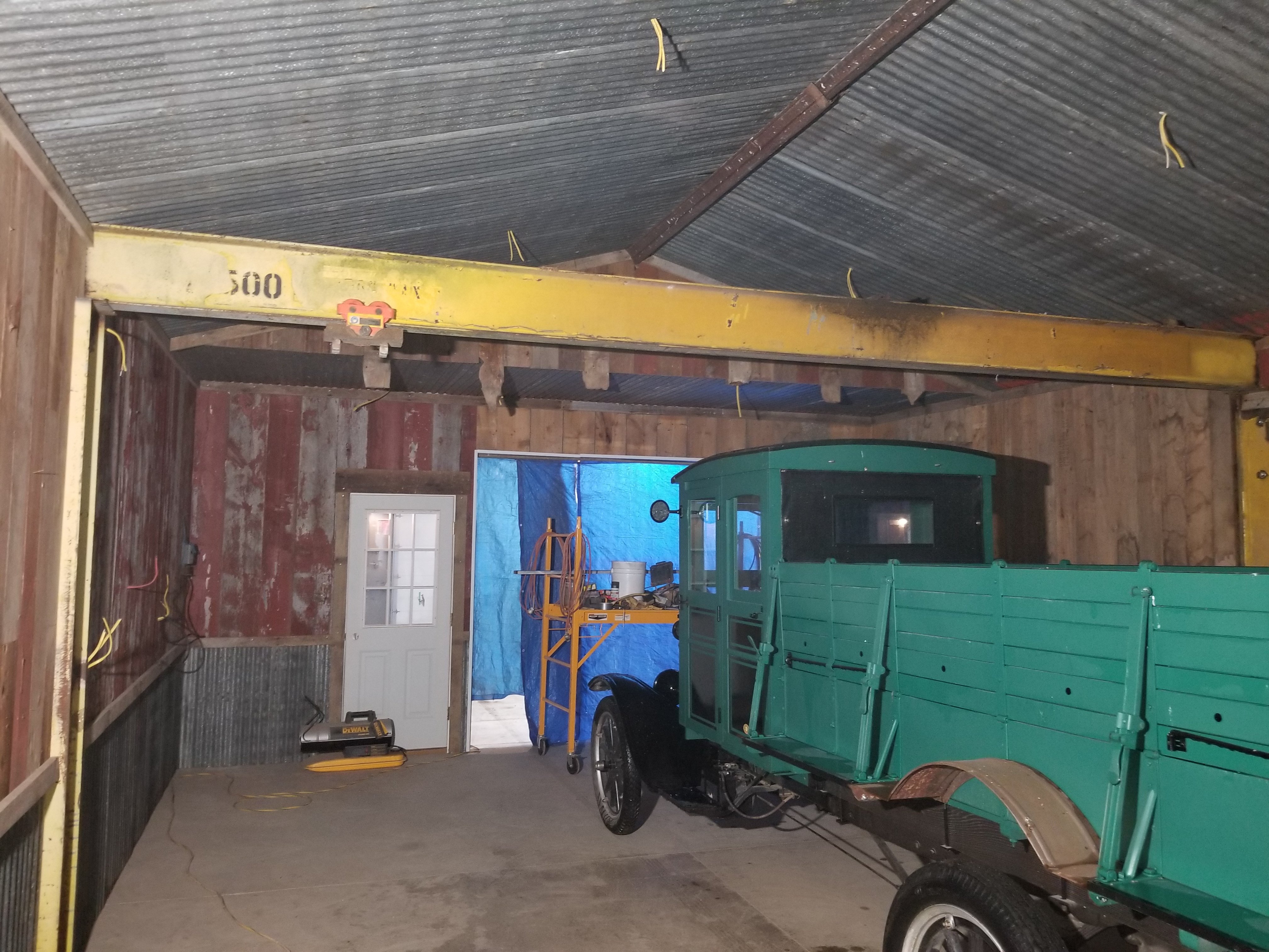

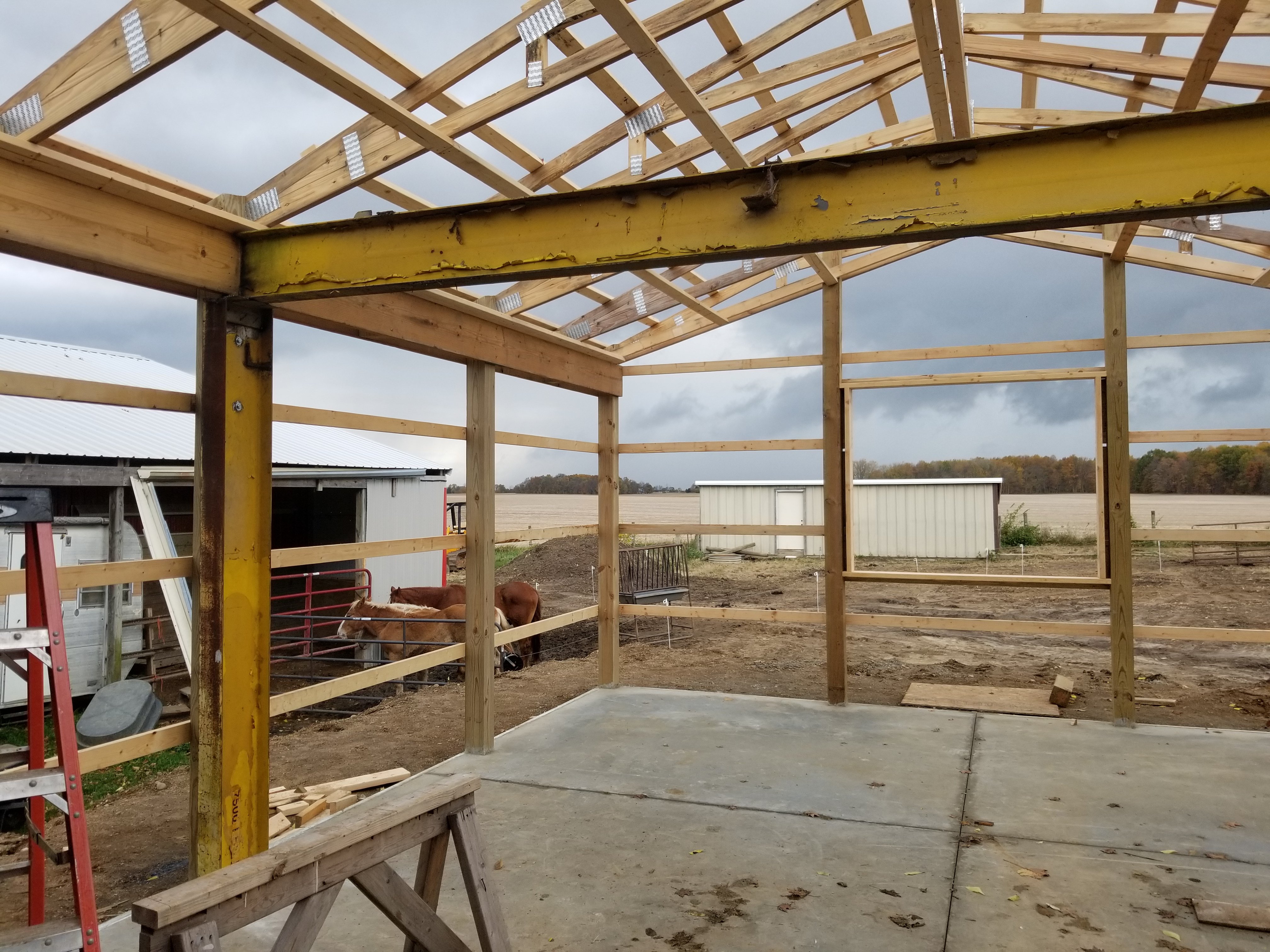

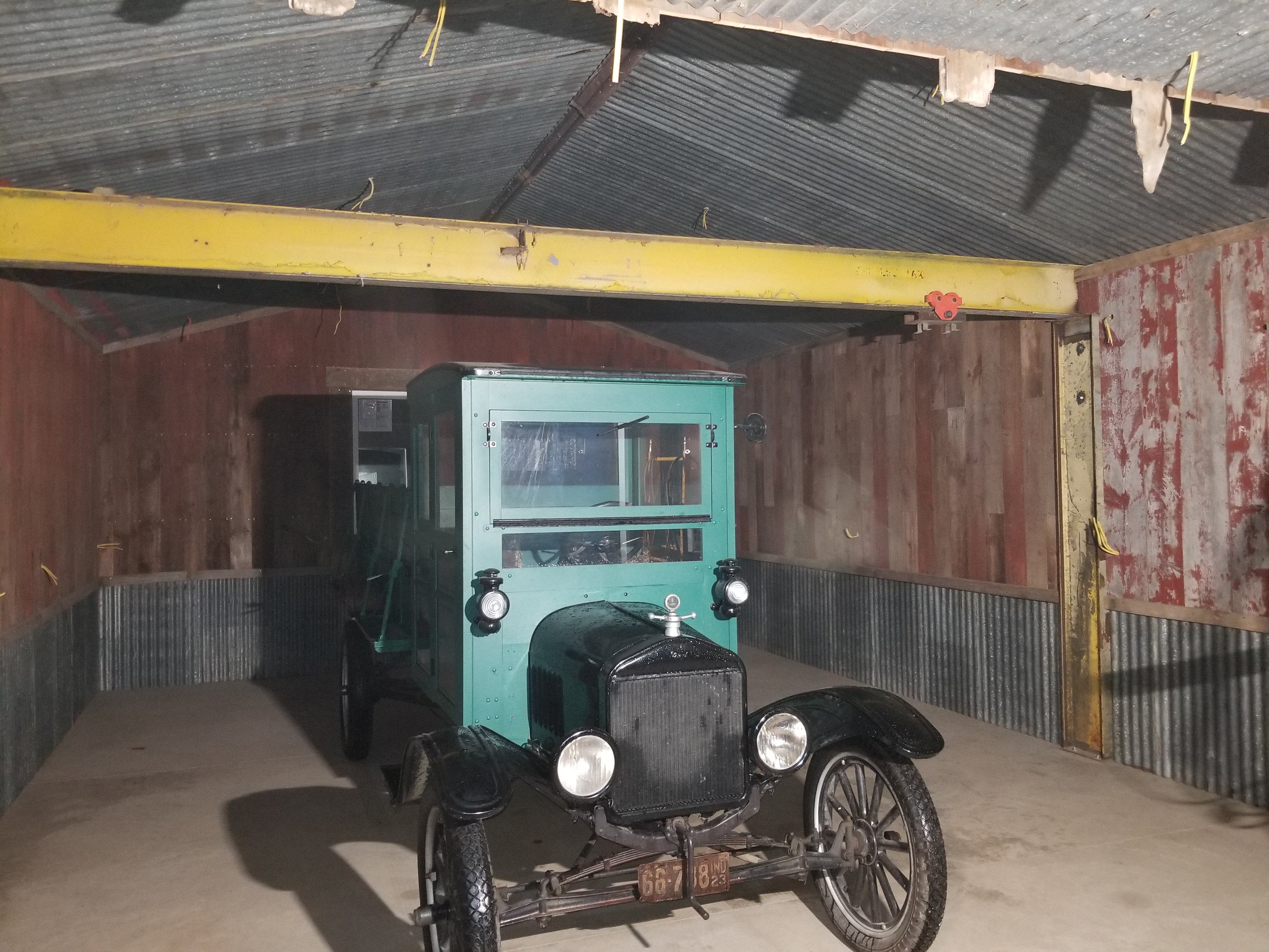

Yes I had the beam, trolly and electric hoist
The retaining wall will disapear with grass and some ground cover vines

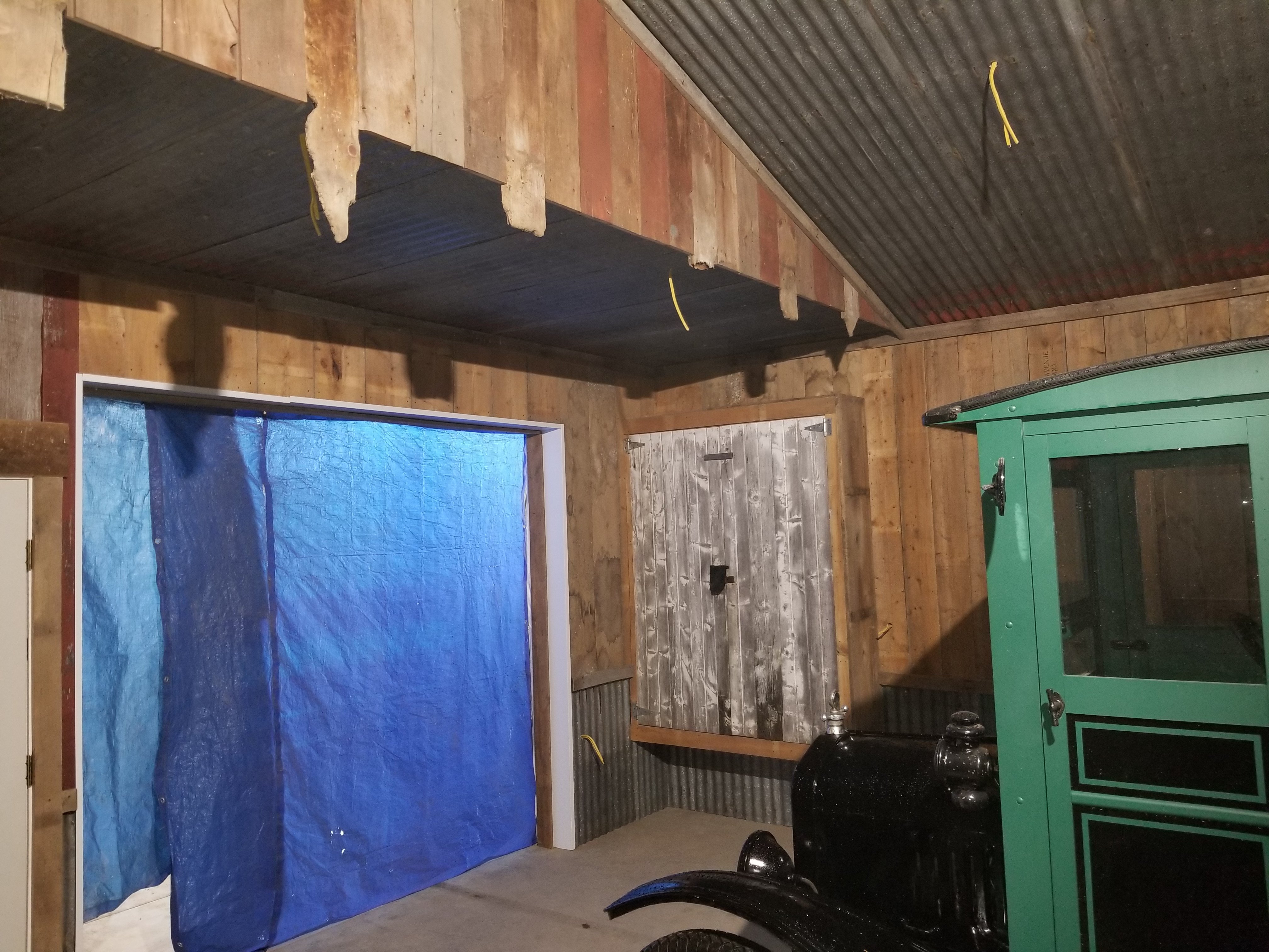

There is a TT in the photos

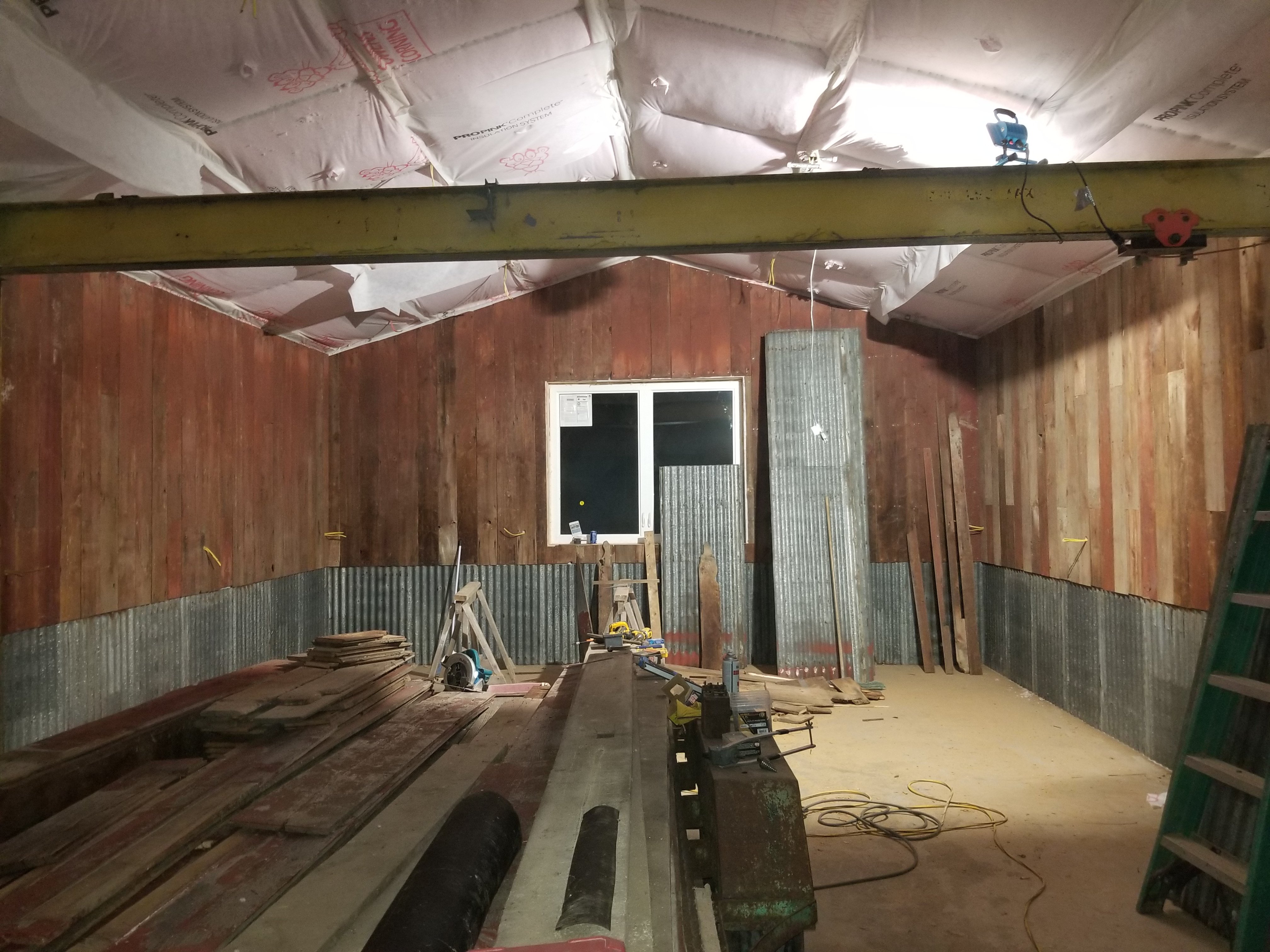

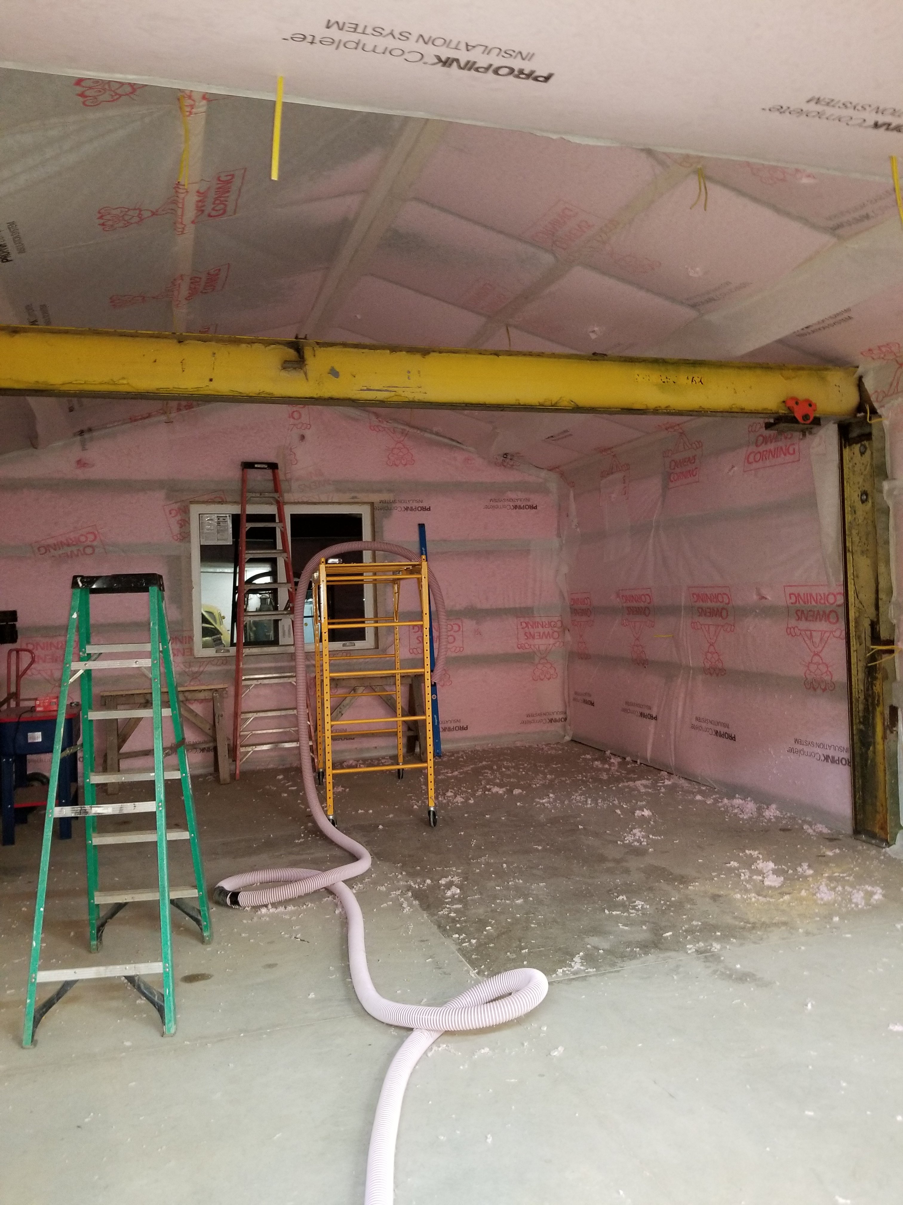

8 inches of blown fiberglass in the walls and 16 to 20 inches in ceiling. Finally a shop I can keep heat in all winter.

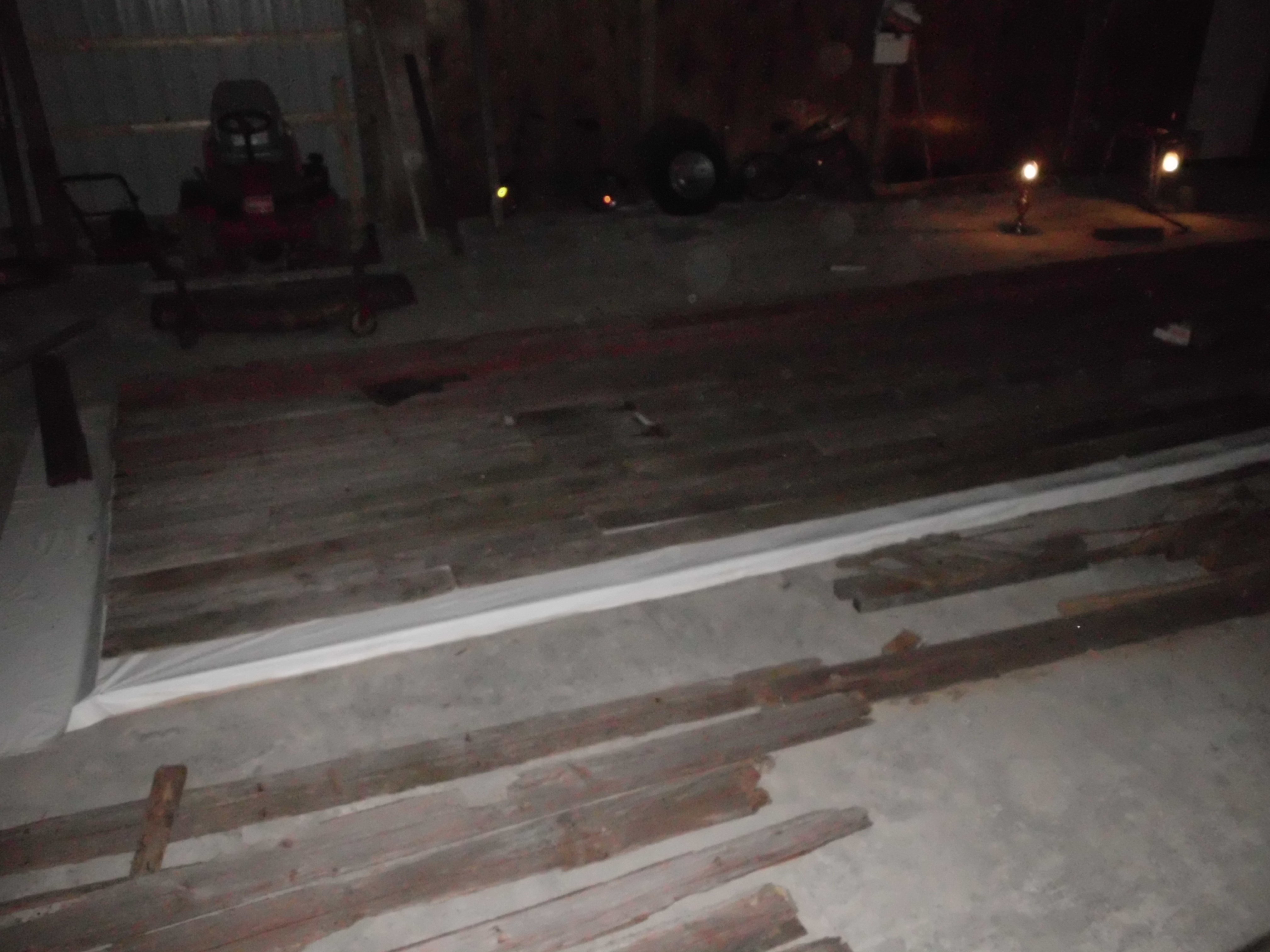

Anyone that has used reclaimed lumber knows the work involved to get it usable. Then sorting and making the most of your marerial as you cant go to the lumberyard and buy more.
Topic author - Posts: 2843
- First Name: Dallas
- Last Name: Landers
- Location: N.E. Indiana
Re: A period looking shop.

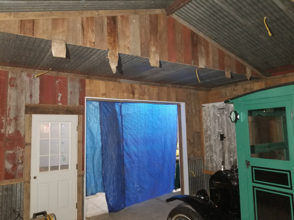

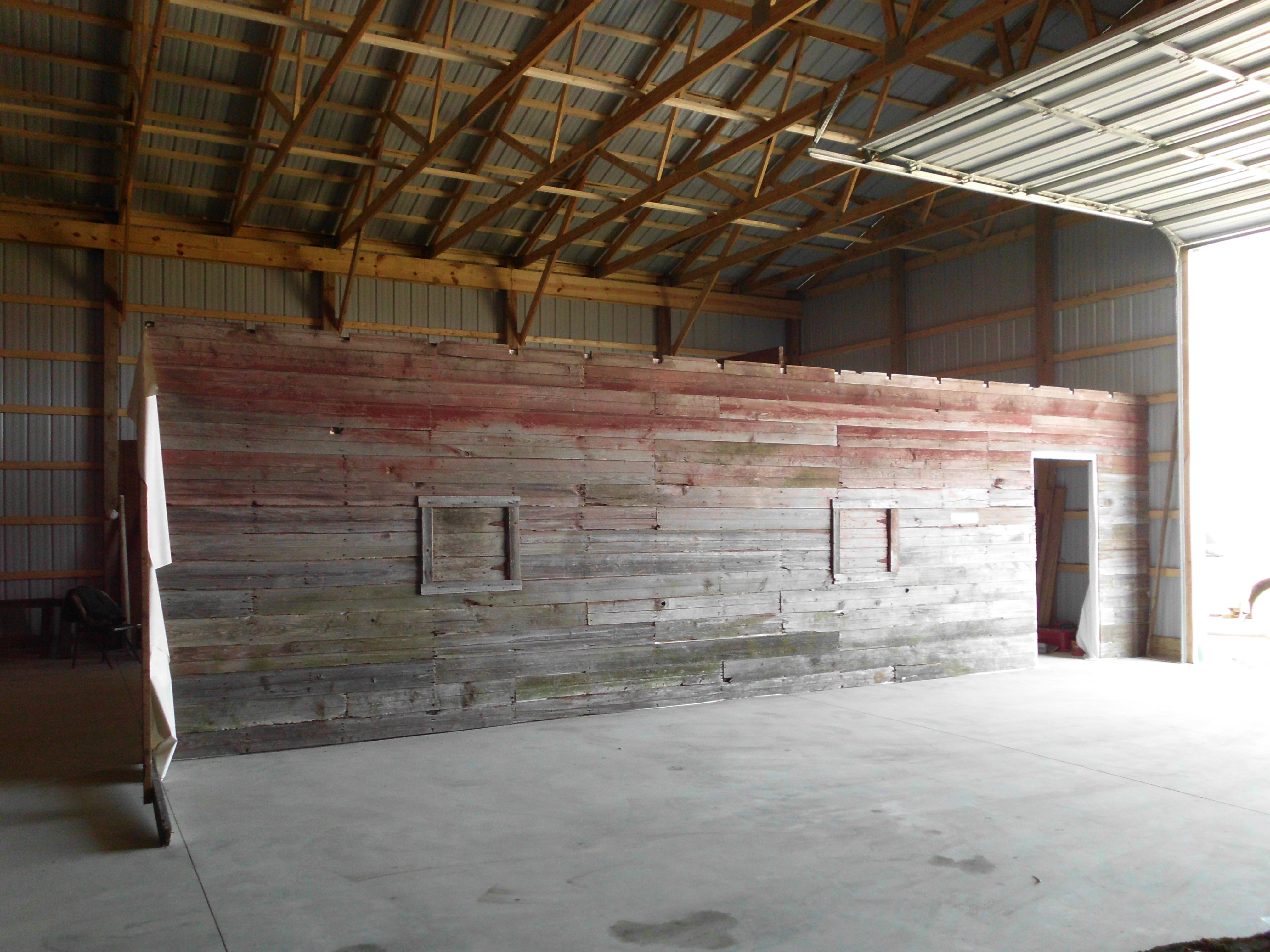

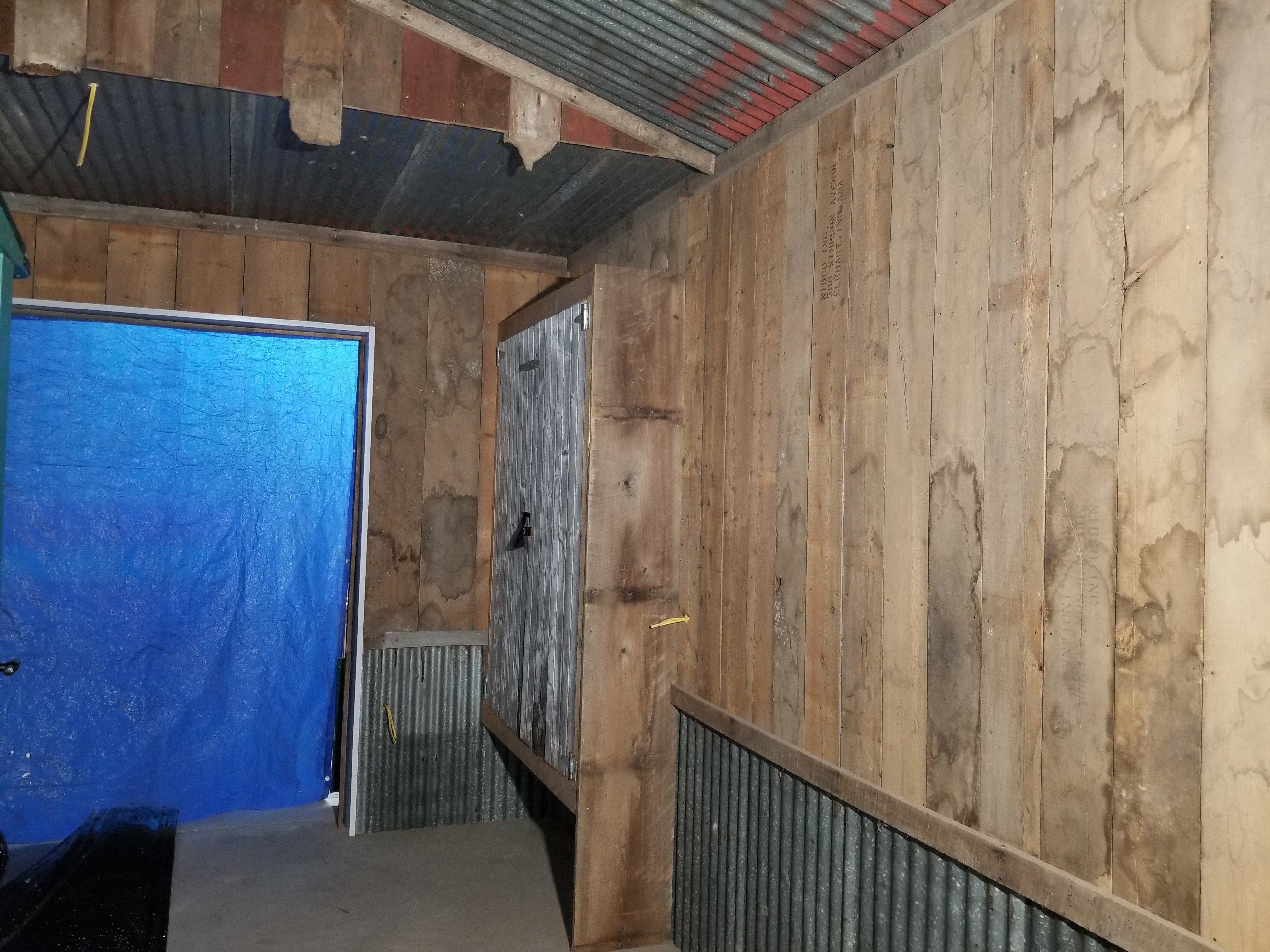

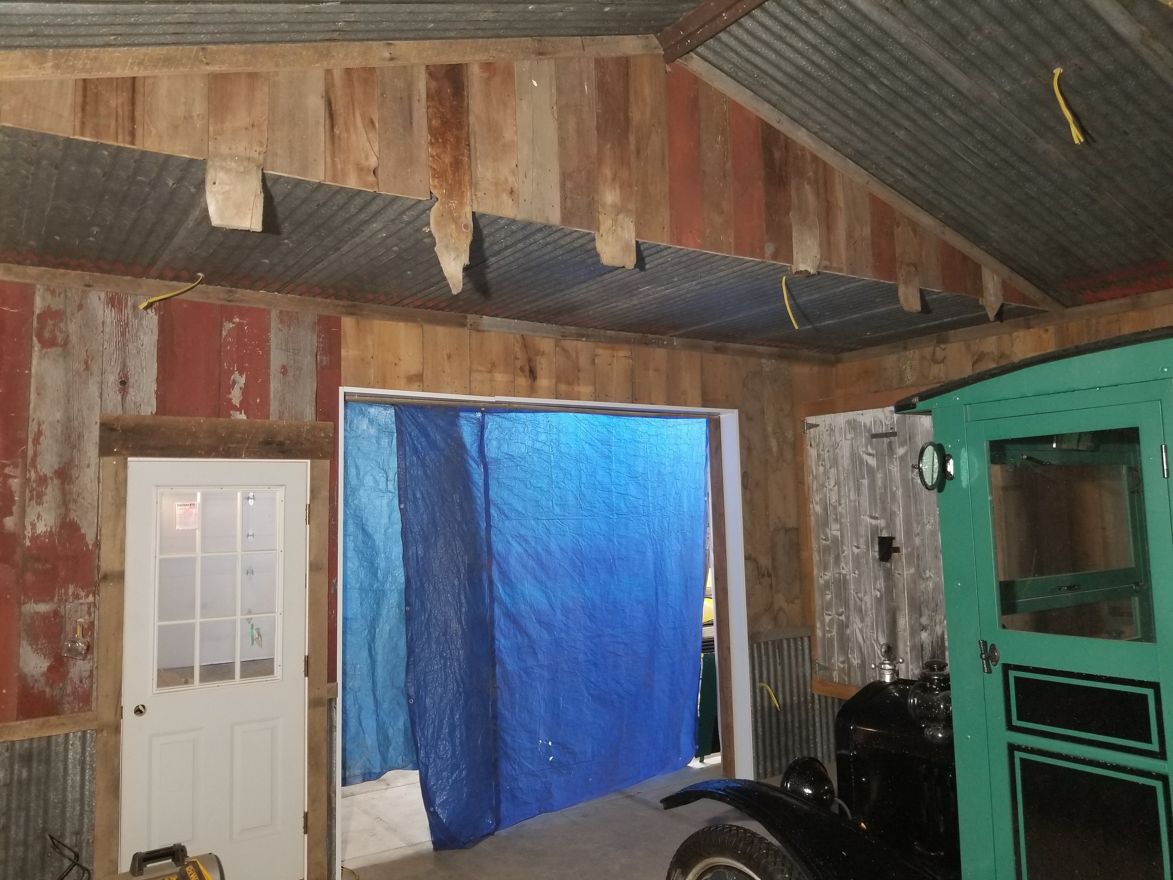

100% of the interior came from the old barn
I have a 4-5 week wait on my overhead door
I could not resist using these boards with teeth marks and oozing character

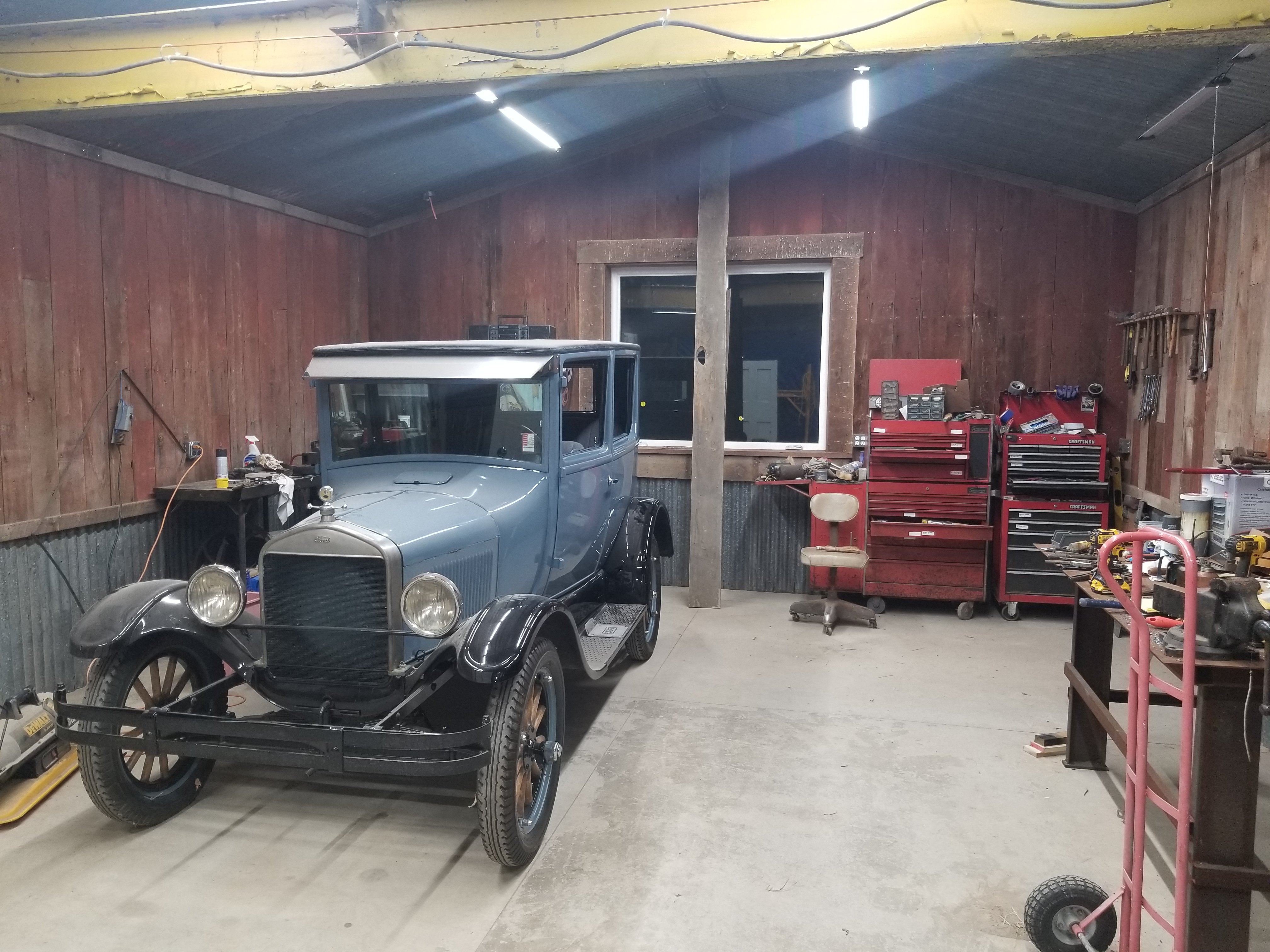

The doors on this builtin cabinet have had 3 lives. My father inlaw built them for his shed. We updated the shed with steel doors and the old doors came to live on my old barn ( as seen in 1st photo) now they are living on, inside the shop.
I think " The Big Green Truck" is happy with the new shop. He is the 1st T to spend the night.
I will hook up all the wiring tomorrow and be ready to install the led lighting when it arrives. We are going to my sons friday for Thanksgiving. I hope you all have a great Thanksgiving

Thank you Hank. Everyone says its too small but 20x30 is big enough to work on one T at a time. And I still have the old garage/shop.

Nicely done Dallas. I was interested in the way you blokes do things. I am not familiar with the roof trusses which do not have the flat tie across the base. Do they have the same load rating as the triangular trusses?
I gather the corrugated iron is used to make the old timbers you had go a bit further. I did the same when lining our wool sales room, panelling the top two thirds with 6 sections of different feature timbers, some Oregon and your red pine included. Our really old corrugated iron came in 6' sheets. Longer sheets like you have in the ceiling are a much later development. Nowdays, almost al corrugated is colourbond coated and we are in the grey fashion era. The rest is zincalume. shiny but evenly coated, and not able to be soldered. To get a genuine galvanised sheeting we have to order heritage galv sheets, at greater cost.
I can sympathsise with your being fed up with filling tyres for a retaining wall. i had to fill just two truck tyres with soil just to put a small rainwater tank at a usable height. I coludn't even manage that and now the tank has a considerable lean.

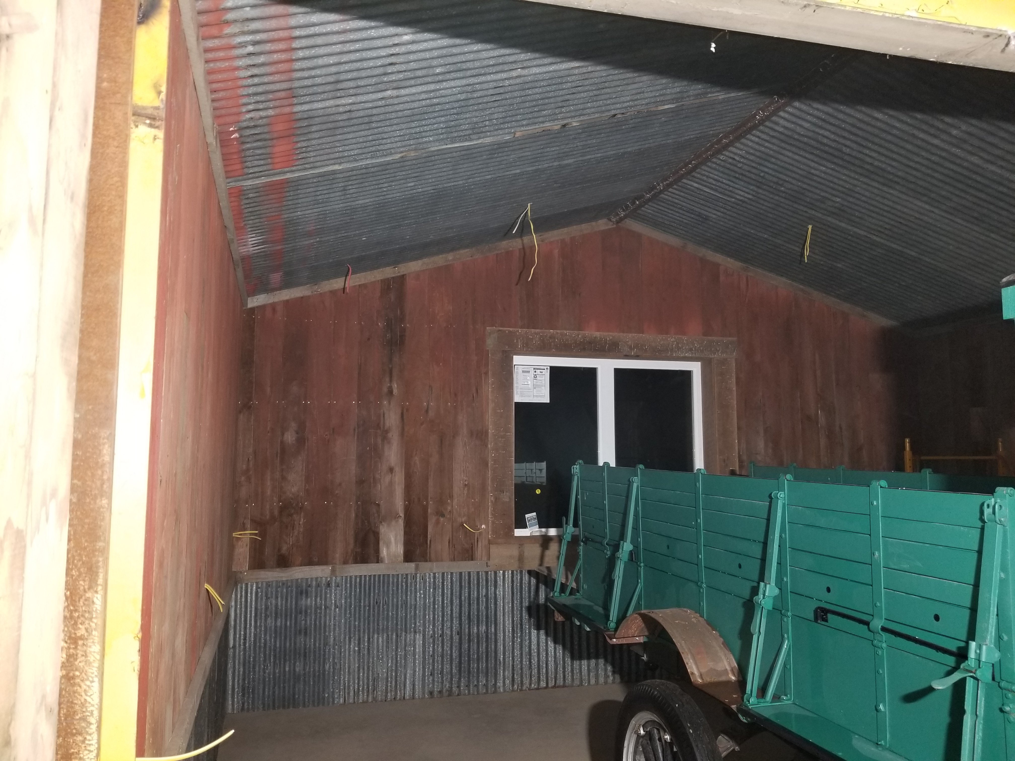

Thanks Allan, the metal on the ceiling was the old roof metal. Rusty side up and the large panels were exactly 10ft- 1in. Perfect length for new shop ceiling. Of course I planned it that way

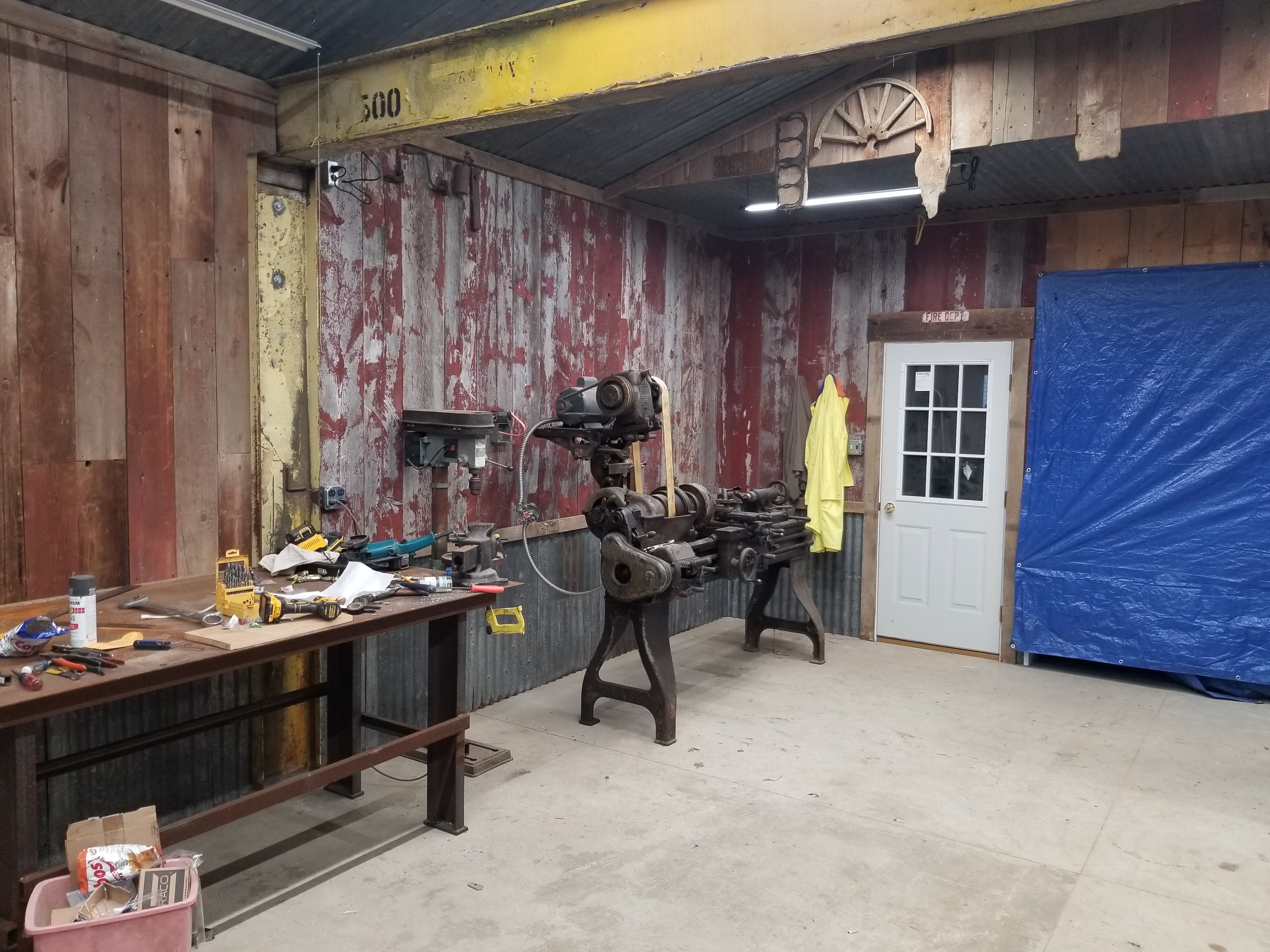

Today was an exciting day. Lights and moved the lathe in. Looks at home I think.
- Posts: 5618
- First Name: Henry
- Last Name: Lee
To be correct, pour some old nasty motor oil here and there, reverse the suction on a shop vac and make it dusty. And take a chipping hammer to that too nice of concrete floor. Remember Dallas, patina is truth!
Your Down Yonderland Friend,
Hank
Hank
Duey_C
- Posts: 1558
- First Name: Duane
- Last Name: Cooley
- Location: central MN
After walking into Dallas' warm feeling shop is an old lathe? Absolutley!
Looks fantastic! Agreed, spill some oil.
We'll be waiting for a test bar from the lathe in its new digs. To be certain it's straight as a good arrow.

Mike, thank you. Even the beam for my winch is salvage from a bridge crane that was in a local factory. The steel bench came from a friend when he retired and closed his machine shop. I have a 2 inch thick butcherblock table top my late uncle made that will be at the end of the steel bench. Seems everything in here reminds me of something. That just makes it a joy to work in here. Sentimental? Maybe. Mental definately.

A standard size T fits a bit better than a TT with a 9ft bed.
Two T's will fit end to end if needed but one is perfect for working.

I like the rammed-earth tire thing. It's something I've been watching the guys at Earthship Biotecture do for several years now.

When we moved to our present location about 20 years ago the first thing we built was the shop building. I had guessed that our old house would take at least six months to sell, so there was no rush to start on the house. But as it turned out, the old house sold within three weeks and the buyers wanted a short escrow. So the first use for the new shop was storage of all our worldly goods.
The shop was erected very quickly and we began moving in storage stuff plus shop equipment as soon as we could lock the doors. Coming from the desert to a coastal region, I didn't think much about rust. What a surprise ! All that moisture from the fresh concrete slab migrated right into our stored goods, especially the steel tools and machinery.
I relate this story for the benefit of anybody else who is anxious to move into their freshly built shop. If I had to do it over again, I'd somehow delay moving in for at least a few weeks and let the building stand with all the doors and windows open to dry out that slab.

Alot of moisture in concrete and even lumber stored outside. My concrete is about a month old. The lumber inside is dry as a bone. The entire reason for this shop was to have a heated space to stop anything metal from rust. My old shop/garage had 5 single pane windows 2 overhead doors and a slider on the back into the old barn. Heating it all winter was not an option due to cost. I wont be opening the new overhead door into my new shop 2 to 4 times a day like a garage would be. The new door will be polyurethane filled for R 17.3 factor. I have heat in the shop now with 2inch foam in the OHD opening. Pretty toasty setting it up now.
