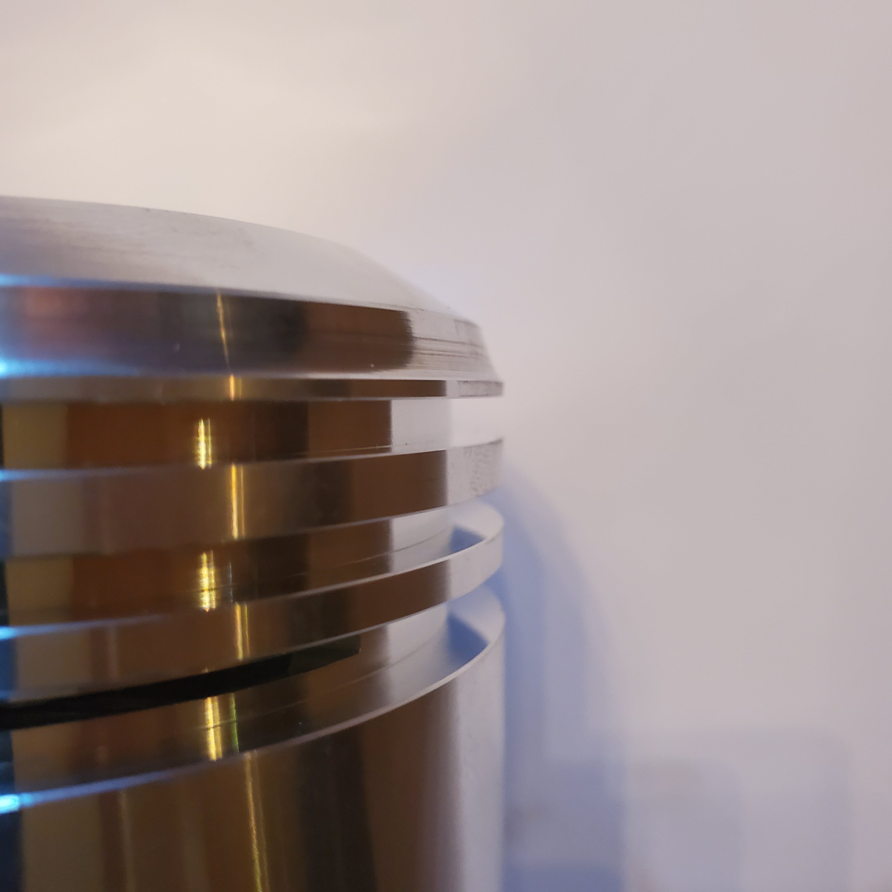

I'll second Frank's observations. there are enough differences between Z heads that each should be trial fitted before finally installing. I do this without a gasket first. Hand crank over to check for any knocks. Tap it back as far as it will go on the bolts and repeat. Tap it forward and repeat. On more than one occasion, the combustion chamber had to be relieved a little for the rising piston to clear. Once fitted, hand crank again to be sure.

Good advice Allen. Especially if you have large cylinder bores. My 27 is bored .080 OS and I beveled the pistons to achieve clearance on a Ricardo head.
