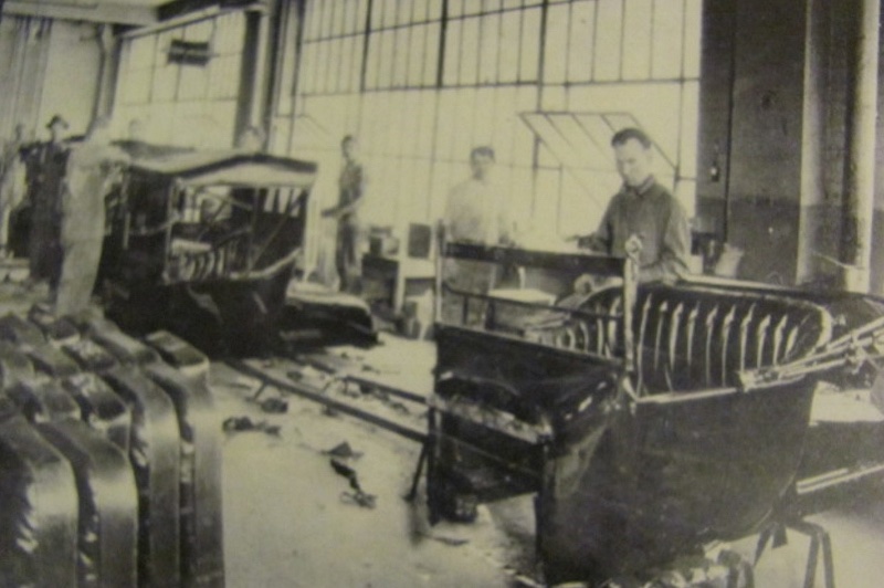

The top was built on a jig at the upholstery department with the rear panel left long for installation. After pulling into shape, it was trimmed.

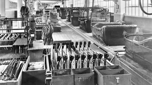

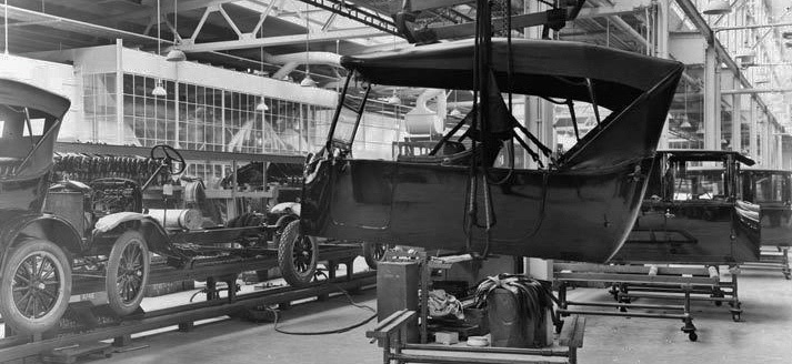

As with all the Ford Model T factory processes, they were constantly improving the time of assembly, early cars with more irons and top size took longer, later one-man tops were assembled faster.
Later assembly with parts stacked on left of line, note the top irons with covered bows, then behind boxes of cut and sewn ready to fit top covers, as the body moved the top was assembled.
And here the finished body with top is on overhead carrier going to the line for the body drop.

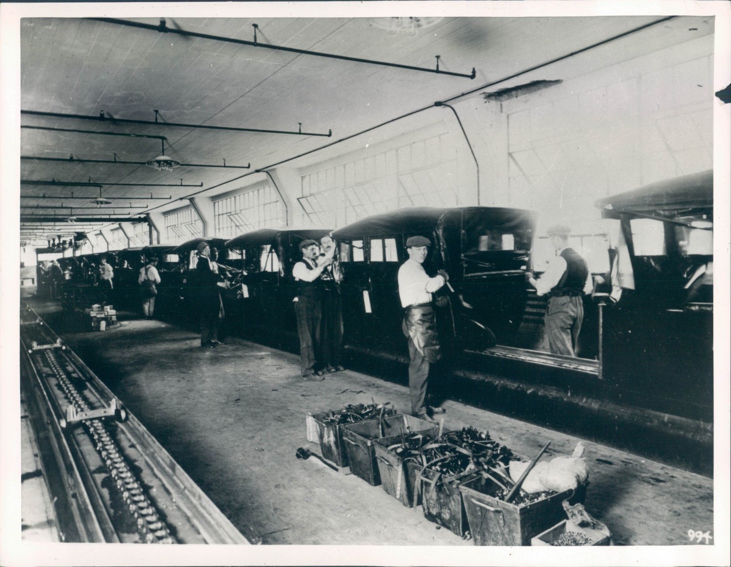

Side curtains also fitted on the assembly line.
