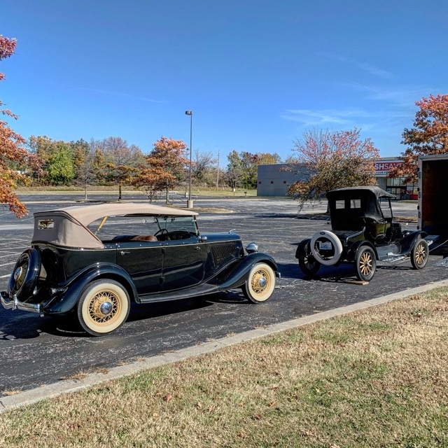

I have always designed my own trailers
and I have designed several other trailers
free of charge for other folks utilizing
what I have learned over the years.

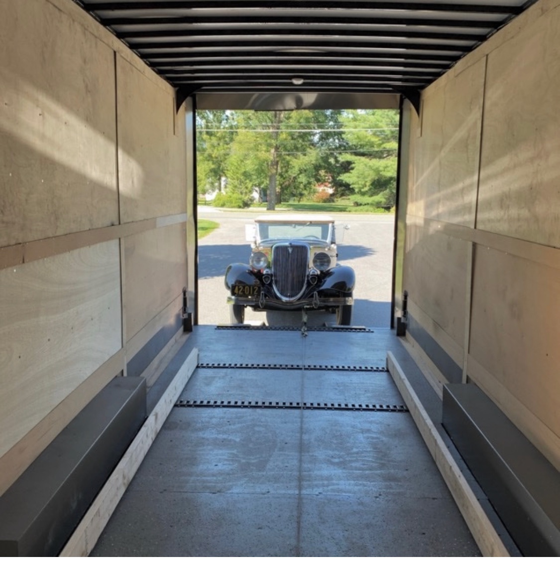

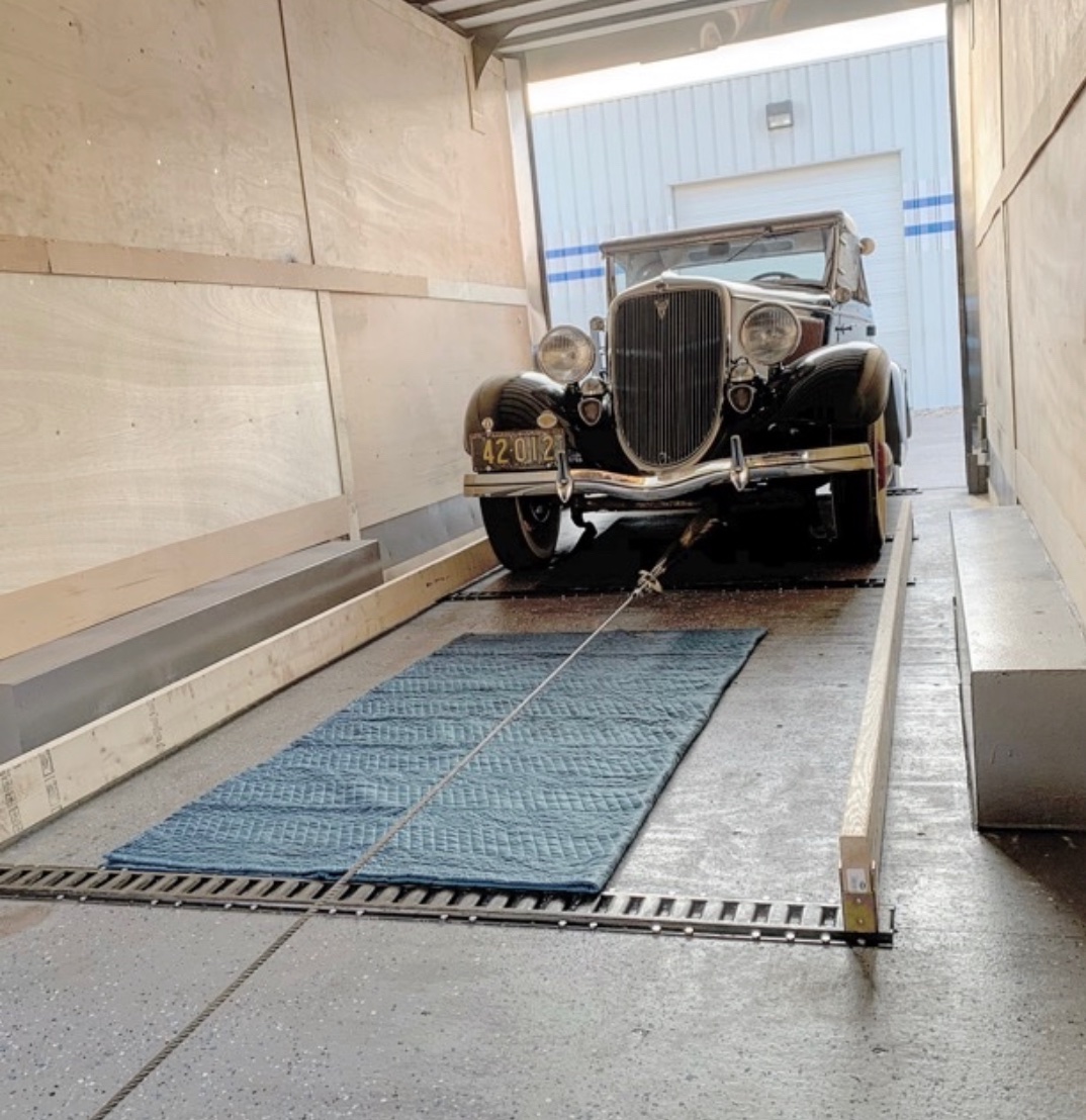

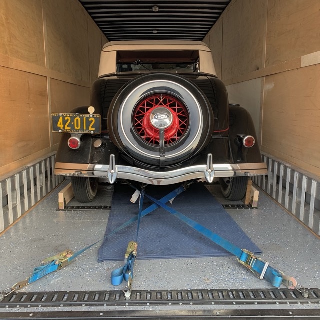

Above is a 1934 Ford Roadster secured with
a three point strap arrangement to minimize
side shift and keep the car from moving forward.

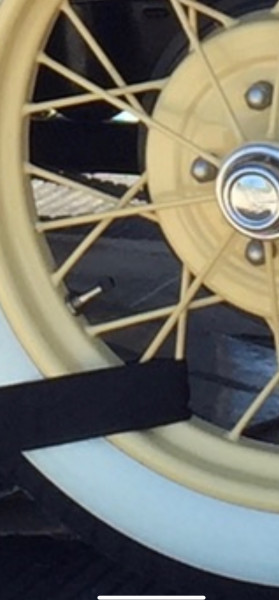

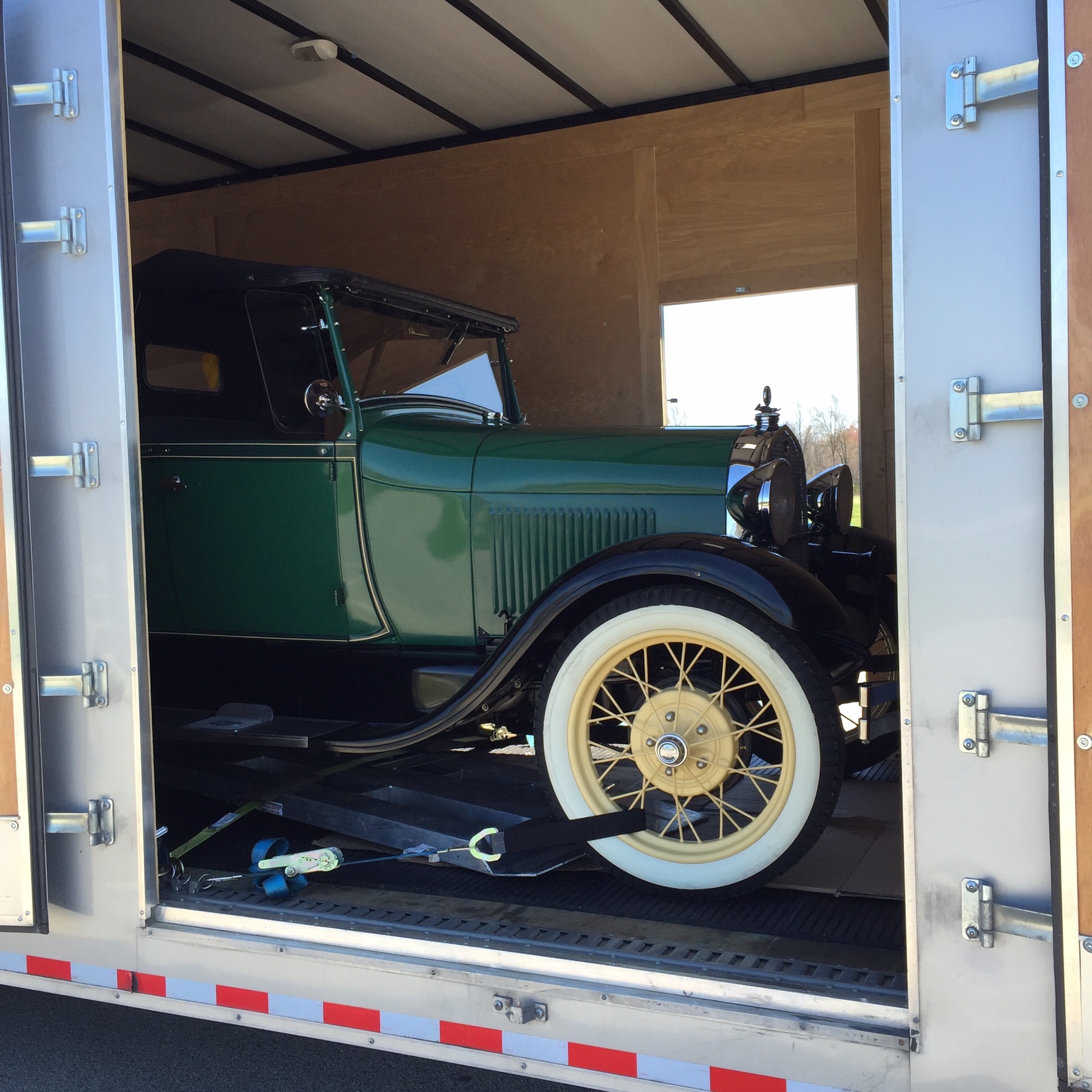

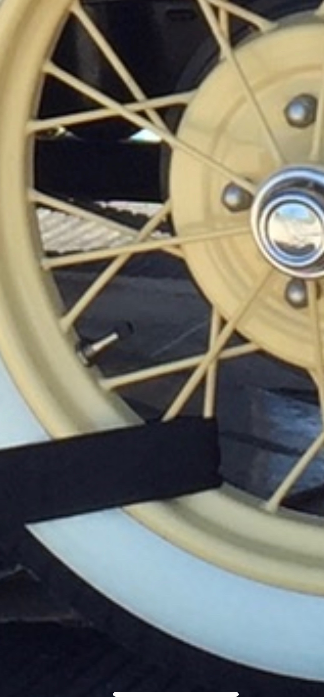

Looking at the first photo you posted of that Model A, I'd venture to guess that after several miles & bounces, that spoke you're pulling that strap against didn't stay straight long ! I surely wouldn't appreciate you "pulling" the straps tight right up against my spokes like that !

The preferred location would have been
where the valve stem is - but there was
a valve stem there.
No spokes were bent or damaged.
Model A’s are heavier than Model T’s.
The wire rim wheels are more stout.
Model A’s have a conventional transmission.
The strap prevents movement.
FJ

Rotate the wheel !

On Jim's setup it seems IF the tire slips on the floor of the trailer, the strap would then be loose. If the strap was thru the wheel and lined up with the center of the wheel and the tie down point, tire rotation would not let the strap loosen. Just an observation.

Angle Of Attachment
Dan
The higher the axle strap is on the rim
the steeper the angle is to the point of
e-trac fastening.
The steeper the angle is - the more likelihood
there is that the running boards will be damaged.
If the wheels are in good condition
and If the spokes are tight and if
the wheels are secured to the spindle
and if the wheels are in line and the straps
are oriented in line then the Model T
stays in place for the trip.
This is what works for my transport purposes.
FJ
