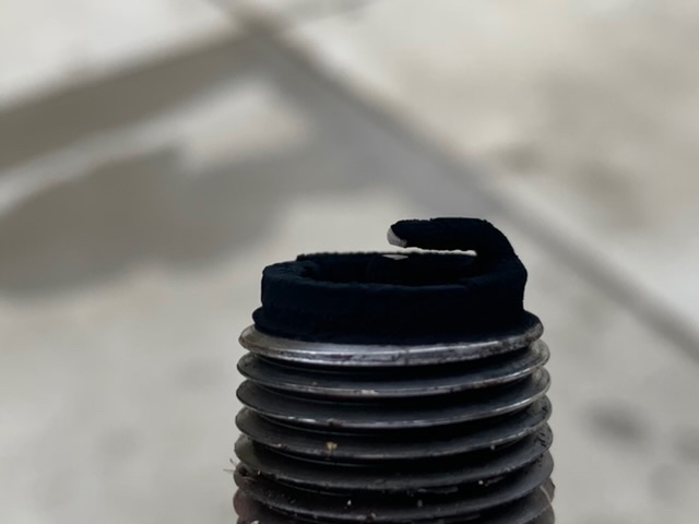

I had a fan pulley go bad. Took off the radiator, replaced the fan pulley, and knocked out a few other little projects/maintenance. I was redoing the timing so I took off the #1 spark plug... I was surprised to see it appeared fouled. Took off the #2 plus since I’ve heard the front spark plug can be the most fouled. #2 seemed fouled, also.
So, mixture. I’ve set my Holley carb per the instructions on the MTFCA encyclopedia site:
http://www.mtfca.com/encyclo/holley.pdf
I have to run rich to get the car to initially start and then can dial it down quickly. 13T runs about one and a half turns open. Car runs smooth... seems to have the power I need.
Reading previous forums on fouled plugs I ran across this one:
http://www.mtfca.com/discus/messages/29 ... 1191186168
It mentions motorcraft plugs and gap as potential issues. I have motorcraft plugs gapped at .030.

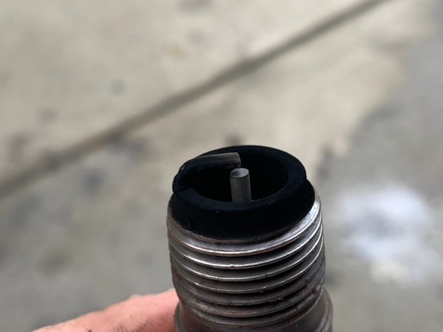

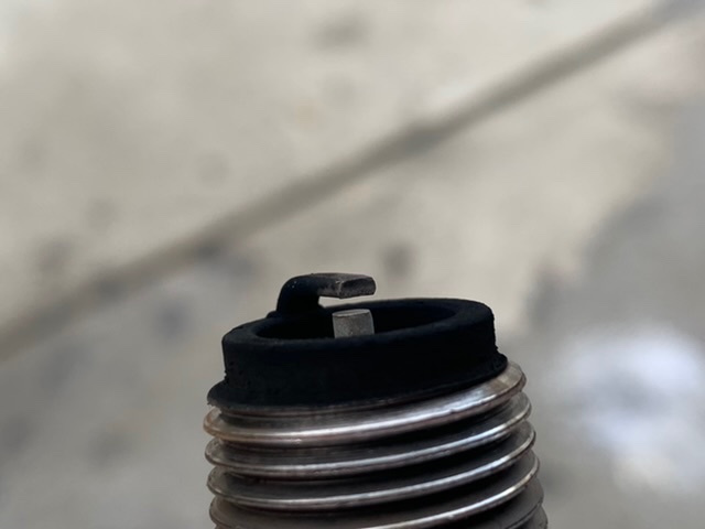

I’ll attach a pic of two of my plugs... would you consider this fouled? Or would this be acceptable?
Darin

If the car runs well and does everything you ask of it, then I would not consider that plug to be fouled.
You could try leaning it out a bit more perhaps. I usually lean it out till I notice the power going down a bit, with slower acceleration, then I richen it up from there till performance comes back.

Your plug looks about right for one which has been used. The contacts are clean . If it were fouled it would be all carboned up including the gap. Does the engine run smoothly?
There are two things which can foul a plug. One is an excessively rich fuel mixture which produces black carbon. If the spark jumps down through the carbon to the ground instead of across the points at the top it would be fouled. The other reason for fouling is excessive oil leaking through the rings. That leaves a black oily carbon around the end of the plug. Even the inside of the cylinder head and top of the piston will have carbon on it after the engine has been run for a while. If you have access to a spark plug cleaner, you can clean the plugs and they will run fine.

I took out each plug and noticed the common result of the plugs looking progressively better the farther back ya go. I cleaned the plugs with a soft brush I usually use to clean carbon off my firearms. I found almost all the material appeared to be like a soot. Came off very easily with brushing. There were some small areas of a harder deposit which I was able to mostly get rid of with a fingernail. Rechecked gaps and put them all back in.
Jerry - Thank you for the “sniff test” way of looking a the issue. The 13T has been running just fine, acceleration and idling all seem well.
Norman - Yes, it seems to run smooth. Once again, I have nothing to compare it to because I’ve only been around this T... but I’d guess it runs just fine.

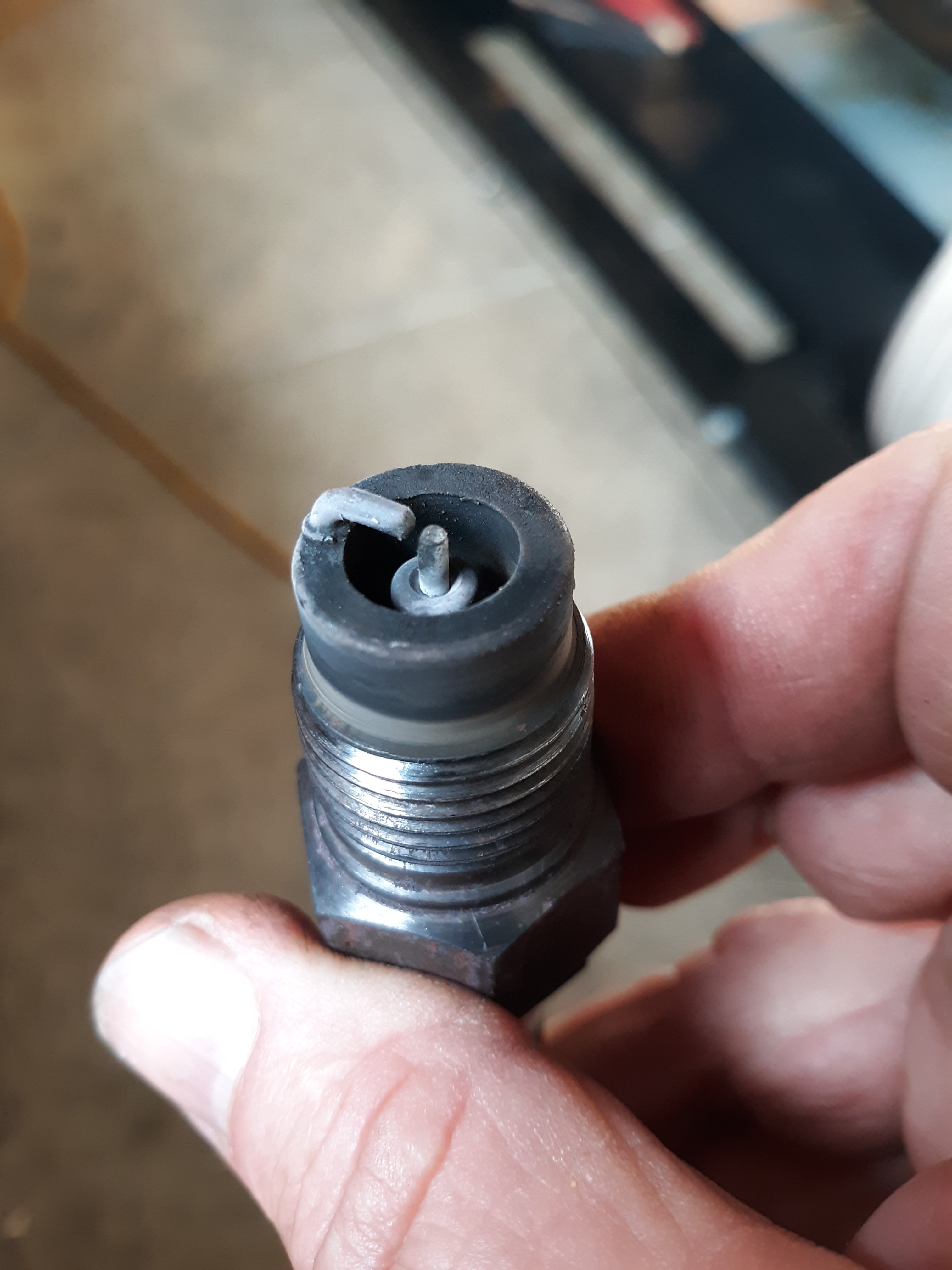

I agree it really doesn't look all that bad, the important parts seem clean. Here's my #1 plug off my '13 when I too was doing some routine maintenance two weeks ago.

Myself, I wouldn't call those plugs "fouled". "Sooted", maybe, but not "fouled". #'s 1 & 2 tend to collect soot more than 3 & 4 because they are at the front of the engine and tend to get the coolest water coming from the radiator, therefore don't burn the fuel as efficiently. I think what you are seeing is perfectly normal unless the sooting occurred in an hour or less.

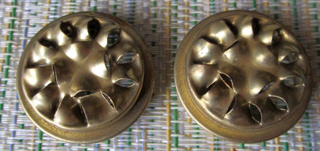

I suppose fouling was a common problem, hence the development of all kinds of accessory gizmos that aid atomization of the fuel. Most of these gadgets look like a steel gasket with a fine mesh of swirling design cut in the center.
http://www.mtfca.com/discus/messages/17 ... 1301424727
