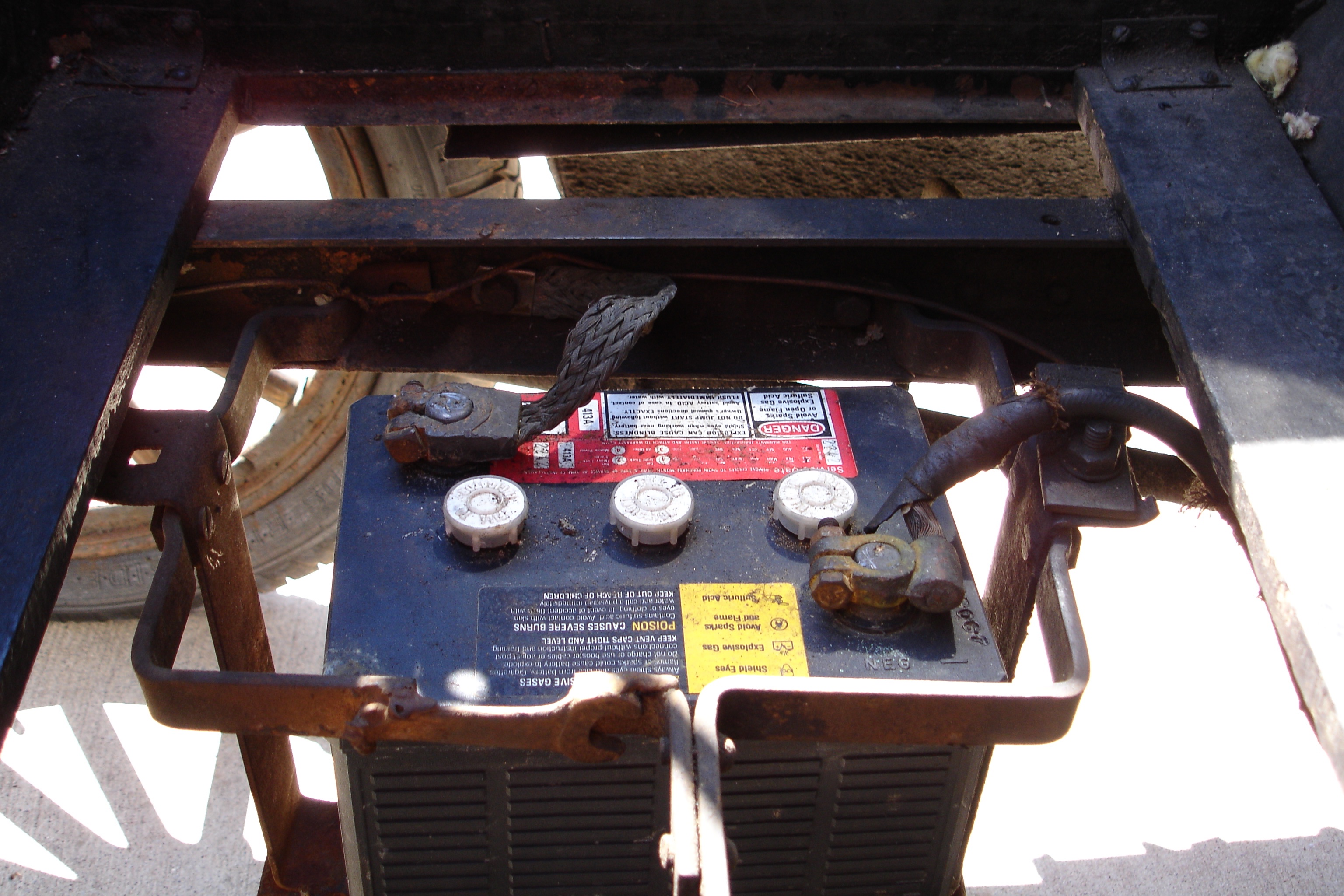

Just slightly off topic from your post. My battery bracket assembly was bolted together with 4 slotted countersunk screws and square nuts and lock washers on my '20 T. As it had been modified for a larger battery, I replaced with another bracket that was a riveted assembly with 4 countersunk headed rivets. My hunch is this was a running change to speed up the assembly of the bracket. My bracket was bolted to the frame rail and did have one hole relocated on frame rail to accept the enlarged bracket. Also, if you look closely at my picture you can see someone had sacrificed a ford script wrench to lengthen the bracket.
